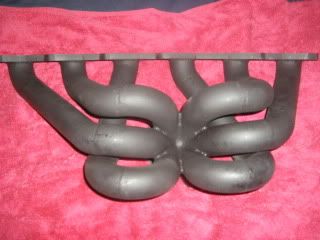

i have a 6 boost lowmount maifold bolted up to my gt35/40
awesome designed manifold with the merge collector
cost me about $1,200 but expect atleast a 1 onth wait for it to be made

HKS cast low mount, one of the better flowing systems in tests, its cast so less likely to suffer from cracking, I was going an external gate, and pretty much everything stayed where it had to, didn't have to relocate anything, and I didn't have to wait 6 months.
wow u went to all that trouble buying a flash manifold yet u chop and shut the stock inlet? lol hmm
i wouldnt mind a nice low mount manifold either..but is it worth it? probably not.

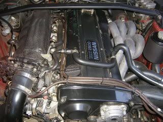

^ I was thinking a similar thing.
Either way it is hard to quantify "was it worth" the money, without knowing the full setup.
eg: Is a manifold other than stock worth it on say a GT3071? No, money can be spent elsewhere.
Depending on your setup & application is the most important factor to gauge wether or not you need or do not need one.
