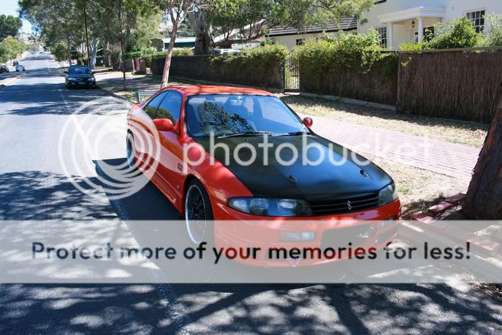

Hay!
Im Mitch , and i dont own a chaser.

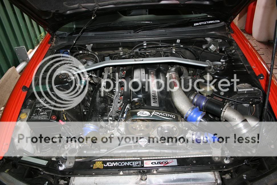

this is my Nissan Skyline R33 GTS-T S1 M-Spec
Modifications.
Engine:
*rb26dett conversion
*rb26 sump with transfer case sliced off
*rb25 engine mounts
*rb25 Harmonic balancer
*HKS Intercooler
*HKS Pod filters
*Blitz 80mm stainless steel tuned front pipes
*Signal stainless steel straight through with carbon muffler
*Splitfire coil packs
*Toda Racing clutch
*Toda Racing 4.5kg Flywheel
*Cusco 2 way mech diff
*Iridium spark plugs
*R33 GTR fuel pump
Suspension and Braking:
*Selby rear 28mm sway bar
*Racing Gear coilovers
*D1 rear camber arms
*D1 hicas lock bar
*D1 adj castor rods
*Cusco front tension rod
*Solid rear sub frame bushes
*Project mu slotted front rotors
*TRW pads all round
*Nismo front strut brace with brake stopper
*GTR rear strut brace
Bodywork:
*Full body respray
*Satin Black bonnet and wing
*Sparco bonnet pins
*Nardi steering wheel
*Trust/GreX gear knob
*Sparco Spirnt drivers seat with Bride super low rail
*GReddy Profec B Spec II boost controller
*GReddy turbo timer
*GTR centre gauges
*GReddy boost gauge
Oils I Use & Recommend
*Castrol Edge 5w30
*Redline shock proof diff oil
*Redline shock proof gearbox oil
*Redline powersteering fluid
*MOTUL 600R brake fluid

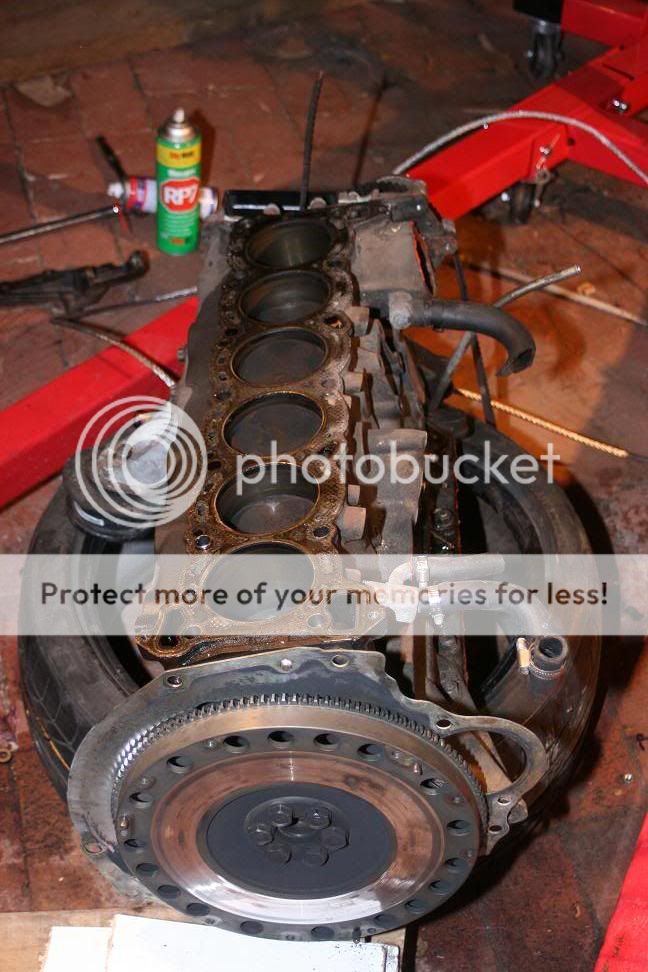

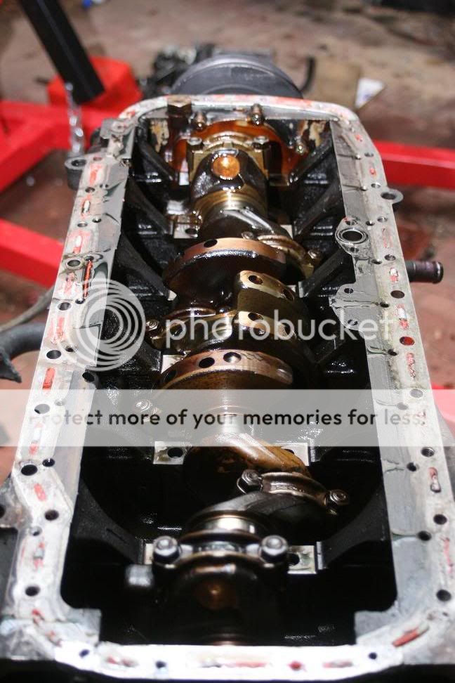

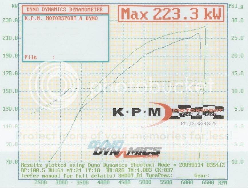

A Week After It Getting Dyno'd The Motor, It Spun a Bearing Which Sucked
So Let It Sit For a Couple Months And Then Thought , Screw It, I'm Ripping This Engine Out

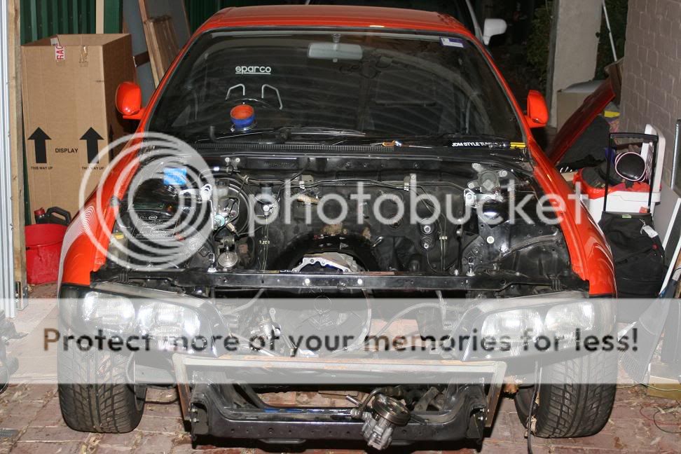

So The Stripping Begins

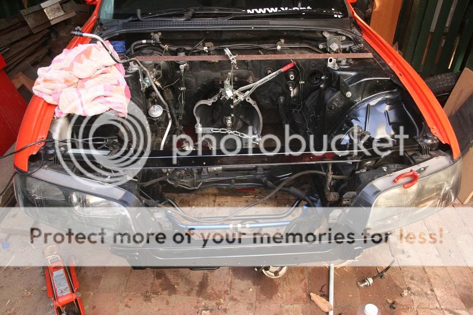

Started By Taking Turbo Piping Out

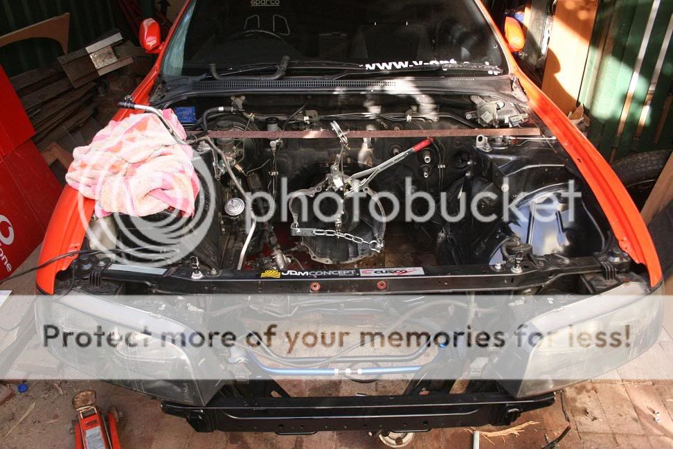

in between not having an income or anything to do i decided to do some minor shit on the car

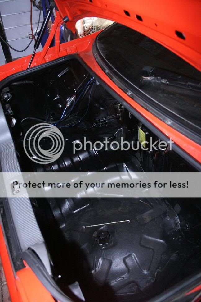

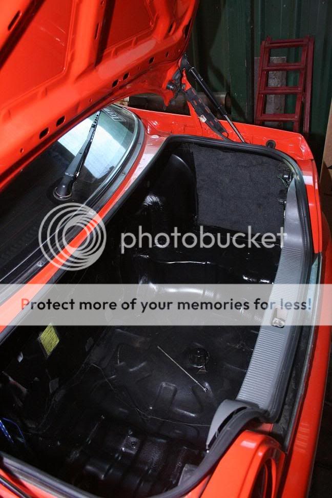

started by removing some crap out of the boot and painted it all black
next was the rad support , it got a bit bent getting the rb26dett out so i hammered it back into shape as best as i could and then thought stuff it , and took off the jdm concept and cusco sticker to obtain a neater look
got the stickers off and lightly sanded the rad back a bit to remove marks and touched it up with some more gloss black

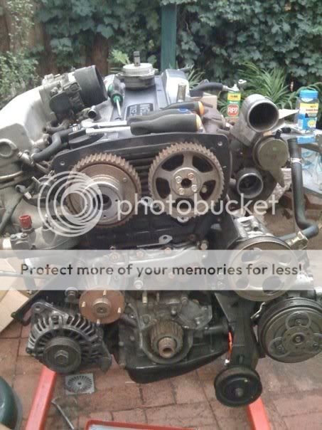

after selling all my GTR parts and winning $1k at the casino i bought a new motor , decided to get one off SAU as it was cheap and had new gaskets all through it
then i found this haha

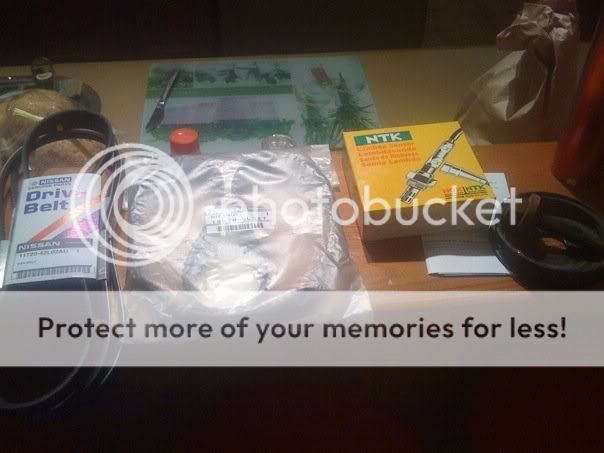

went and hit up nissan from some overnight parts from japan (Not really overnight , they were in stock )
bolted everything onto it and it started looking complete! :D
then went out and bought all the stuff i was in need of

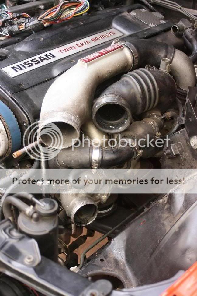

also decided to splash out a couple hundred and get a good front pipe as my GTR one was useless to me with a 25det

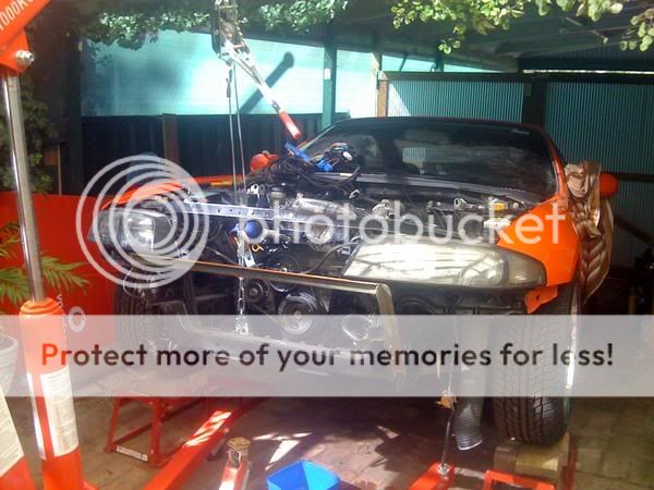

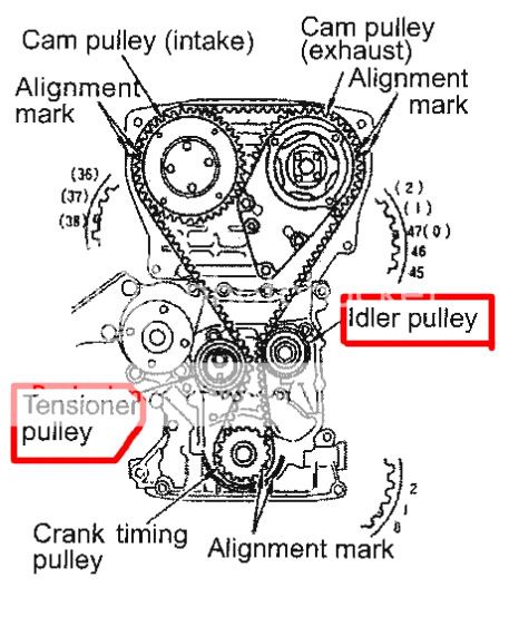

after i got all this and took note of the engine diagrams i had i realised i was missing a
tensioner pulley and an idler pulley , not to mention a water pump pulley !

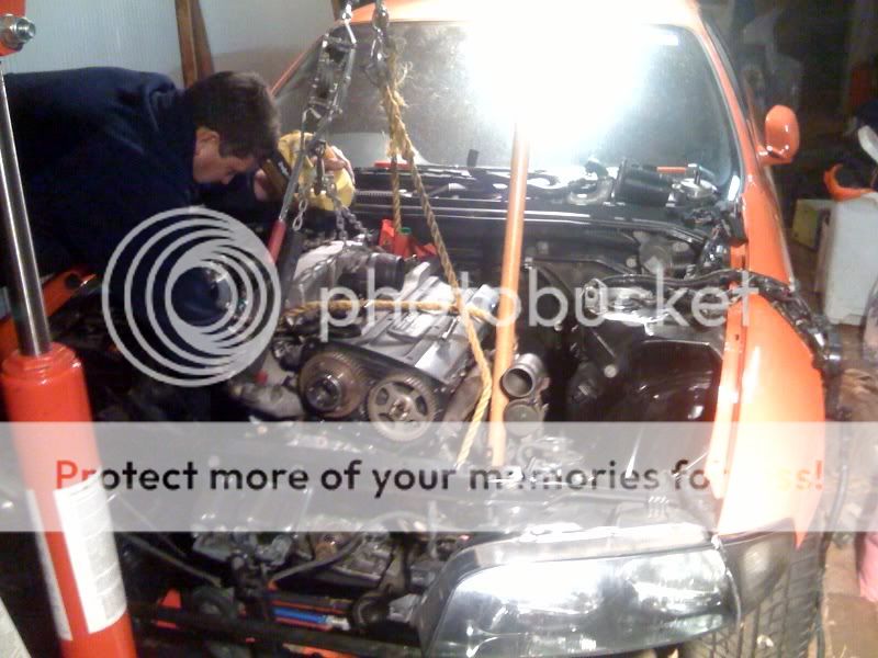

so, dropped it all in
after alot of messing around i finally got the gearbox to line up nice and snug !
after a lot of messing around in to the early hours of the night hooking up remaining hoses such as breathers on the turbo
and replacing the throttle cable, which required removing my sparco seat and getting my mate to crawl under the dash to do so haha!

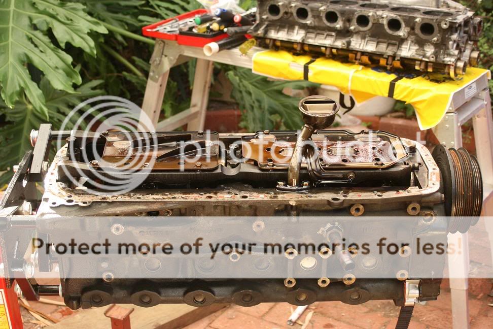

so, the workshop told me the engine has bent valves and a blown piston.
this didn't sound right to me as the engine i bought was low km and had new gaskets all round and had the head cleaned up.
so i decided to pull the head off so that i know for certain.
anyways i got the head off and there seems to be no visible bent valves what so ever. after having my 26 head that had bent valves i have an idea on what to look for and i also had an apprentice mechanic mate have a look over it and he said that they don't seem bent. next step is taking it to an engine builder and getting it vacuum tested and going from there.
just from pulling it apart you can see how clean the head is.
turns out they were wrong, they put the bolt into the cam pulley too tight and didnt put a spring behind it making the cam not turn at all, and well what do you know , cylinder 3 is OPEN like a homeless shelter on Christmas day...
got my mechanic to look over it aswell and he did a test on it and there arent bent valves...
fkd if i know what that workshop were doing but clearly they were wrong.
started cleaning the head up where the old gasket was and also started cleaning the valves up .
finished the cylinder head off!
bought new cam shaft oil seals from Nissan as they were missing, re lubed camshafts as one was seized up.

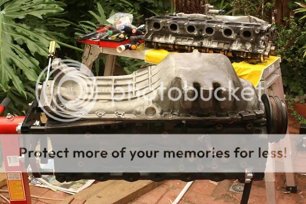

anyways , took the block out of my car to get ready to drop a new motor in , again! :D
couldnt notice how it was sittin at the rear haha
BAWLAA
got a couple of mates over to give me a hand to rip the wreck apart
but this resulted in some suprise buttseckz ;)
finally , ready to come out!!
me doing angry face while jacking engine crane
finally got it out and decided to go buy all the stuff i needed for it !
