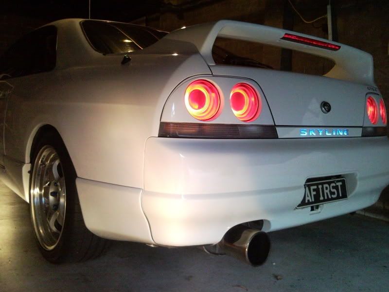

I did mine in red and it comes on with the brake lights.
I've had cops behind me several times and so far so good.
Quite simple to do.
I did pretty much the same as JamesK.
I cut the plastic away with a 4 inch angle grinder.
I used clear contact paper.
Sanded it.
Covered it with the contact.
Trimmed around the letters with a craft knife.
Sprayed it with primer + black top coats.
Removed remaining contact off the letters.
Fitted a 300 mm led strip with double sided tape hard on to the back.
Looped an active/neutral off the brake light.
Blue looks awesome on the white car !
