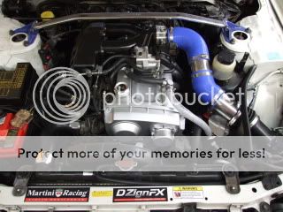

re done the piping for air intake, and had to get a tune done again cause she was running heaps rich with the new piping......
but comparing the old piping to the new one, the car has a lot more resposiveness that what it did, it wouldnt have changed anything kW was, but at least i got the resposiveness ;)
ive got mine coming from the front of the bar going up to a pod, but what has made the main difference is the piping from the pod to the throttle body.
So you are saying that the silicon piping was the key difference maker? if so, what makes you think so?

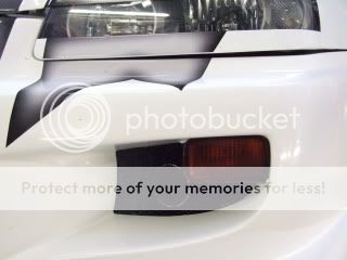

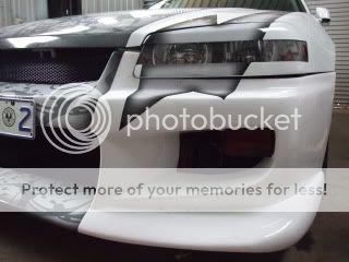

Btw, you got more photos of your car - that's very nice looking car, love the paint scheme - not sure about asian-eye headlights tho ;-)
cheers
but comparing the old piping to the new one, the car has a lot more resposiveness that what it did, it wouldnt have changed anything kW was, but at least i got the resposiveness :P
Hey Cara how did you do your CAI piping i see some silicone and some stainless etc can you give more detail.
