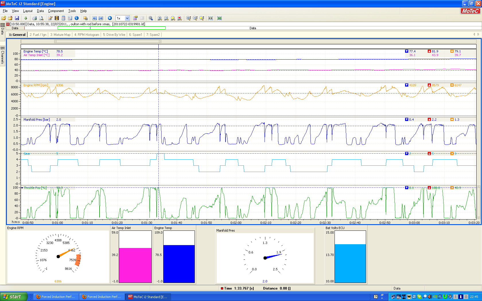

Real world data. Rb26 at 86.5 bore, stock stroke, all steel internals (endurance spec build, probably overkill, but I hate failures), Tomei 280 degree 10.8 mm lift cams, Tomei cooling channel pistons at stock CR, Motec M800 ecu, stock TB's, stock CR, mildly ported head, all manifolds port aligned, stock ported cast manifolds, NO AFM's, MAP / Throttle based but with 4D mapping, stock elbows, -10 turbos, 3 inch ultra quiet exhaust (98Db at 2/3 max rpm static), 850 CC injectors off single 044 pump, in a GTS-T RWD shell. 1.2 bar boot. Motec shows absolute, not gauge pressure. mikey whatsisname speaks a lot of sense, IMHO.
http://www.gatesgarth.com/datalog.png
In car with basic data overlay from same track day:
Manually synched to video, so a tad out, sorry.
I want to try the bigger -10 turbine housings. Car is a pussy cat on the road, no shuffle at all, totally pleasant off boost and at cruise. Would benefit from a less restrictive exhaust system, exhaust manifold pressure V boost pressure ratio is not brilliant, but here in the UK noise is a major issue. Car runs from the roadside pump Shell V power, no det, no issues.

I think your throttle % mapping is a bit out, highest it gets too is 65% or so whilst the 'bar' is maxed?
5500rpm in second @ full noise before 1.2bar. Maybe you need 290 cams as well to bring them on @ 4500rpm like some around here have claimed :rolleyes:
Pity the data cuts out half way through the video man, it was just looking to get interesting :(
Yes, I am just trying this manual data overlay app (Race Render, it's me, not the app as such, it's trickier than I imagined...), I am beginning to wonder just how far from synched this is, take it with a pinch of salt, but you get the basic idea. Just shut one eye ;) Automagical synching is available from Motec, but the bank manager is dubious about its merits this month ;)
I am in the UK, but try and keep an eye on all the Skyline sites. Cheers. I may have another go at doing a better synch. I have sold my Go Pro Hero camera and for next season will either get the Motec stuff if they come good on their intent to offer a higher resolution camera setup, or buy a camera that time stamps the video. The GPS data channels have a GPS time function, so tying up the two should be far easier then. Cheers.
