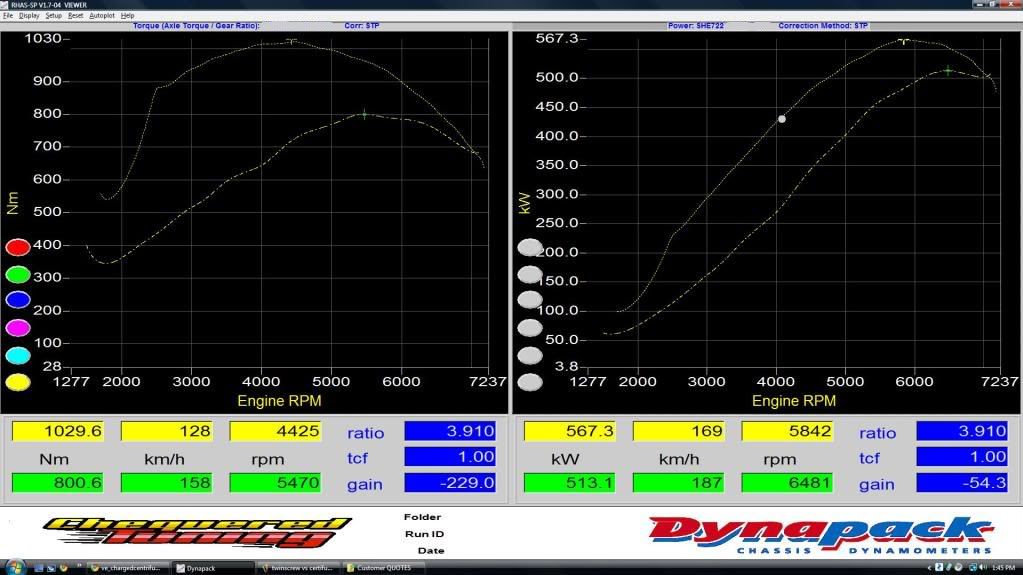

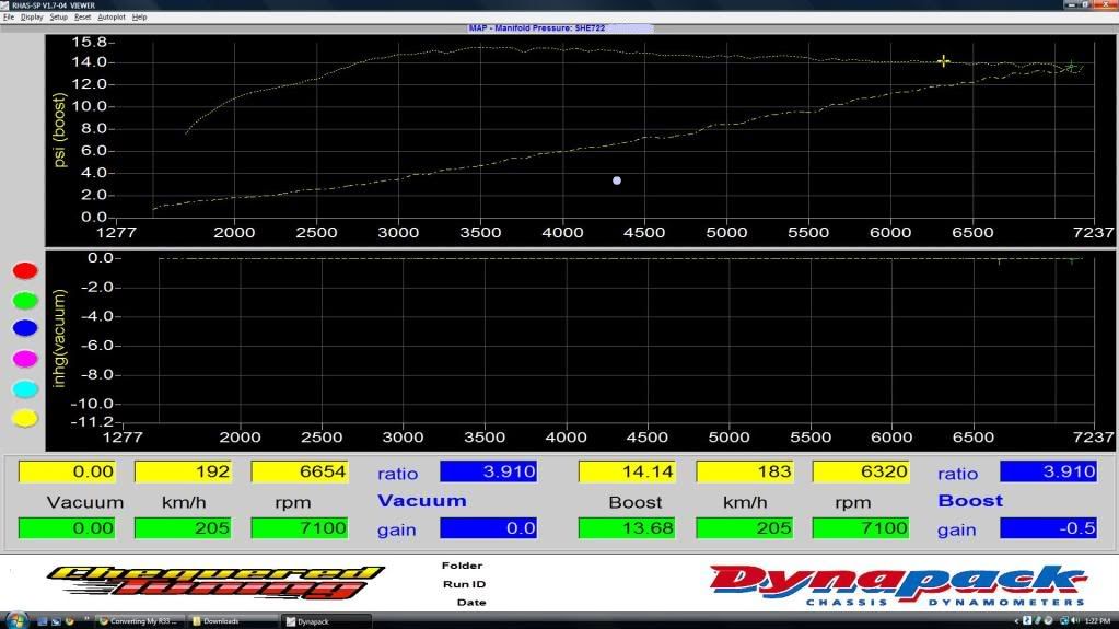

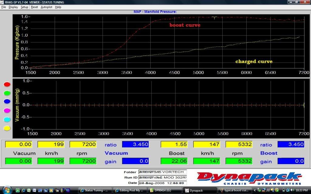

Make sure you run a twin screw setup as they offer boost on demand unlike the centrifugal types like Vortech etc... here are two vortech charged cars and look at the difference in boost curves...
Vortech and the centrifugal types are like your worst LAG nightmare and are only useful for dyno comps....
Here is your average boost curve vs a vortech;
Here is Vortech vs twin screw (kenne bell type)
and the comparo of the two setups running the same boost.
