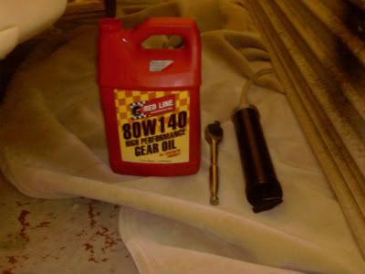

- 80w-140 Gear oil (My bottle was roughly 3.9L and i had about a liter left)
- Transfer pump or 2 Meters or tubing and a funnel. Tape the funnel around the tubing and poor it in while the funnel is higher than the filler hole in the diff

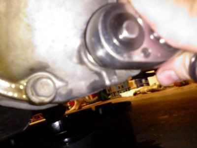

Picture of filler bung plug on rear diff. You can see the tight fit it was with my exhaust system only being a few inches away. It took me about an hour to break the seal on this plug as i would asume the exhaust heat helped it practly weld itself too the thread. This is where i used my 'technique'.
Once thats cracked, move onto the drain hole.

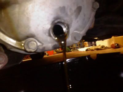

Picture of drain plug. It was simple to crack this one. Make sure you have your oil tub under it too catch the oil that comes out.
3). Now let the oil drain for a few minutes. Mine was definatly past its used by date and was also very thin which concerned me.
In the mean time check your drain plug for metal. Mine was fairly clean with the plug only having mercury fine metal shavings on it and one small metal piece no bigger than 2mm.

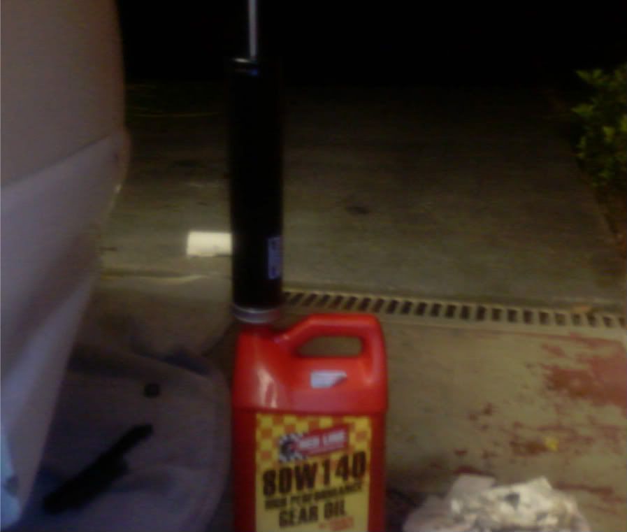

4). Now you put the drain plug in and go get your bottle of oil and transfer pump or funnel pipe thingy and simply fill the diff from the filler hole.
You want too keep filling it untill the oil starts too trickle from the filler hole. Once it starts too trickle have your filler plug on stand by.
Thats simply the rear diff done. It was about 1.6L ;) front is a bit less

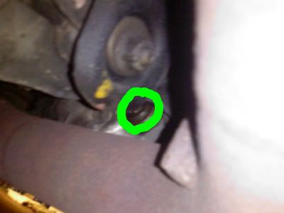

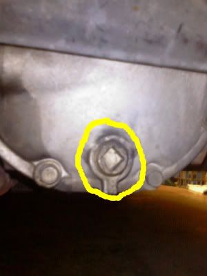

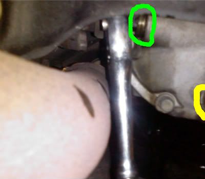

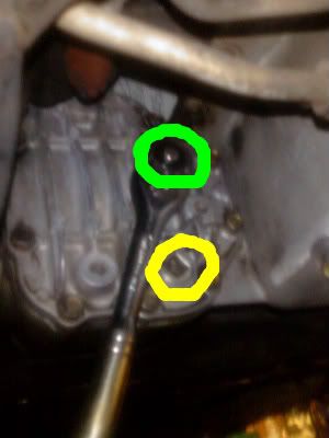

1). Firstly get some WD40 and spray the front diff bung plugs and let ot soak in. You can also tap them around :(
You can see the top one in green and the bottom one in yellow. They are simple too get too, on the driver side of the sump and come off with force.

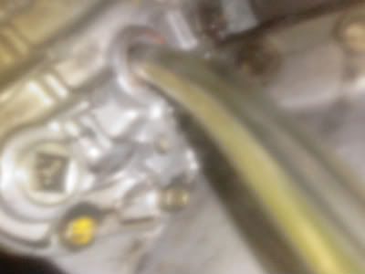

2). - 4). (Simply refer too the steps of the rear diff as its the same just in different and easier location. The diff took 1.2L of oil.)
It should look like this while filling)
