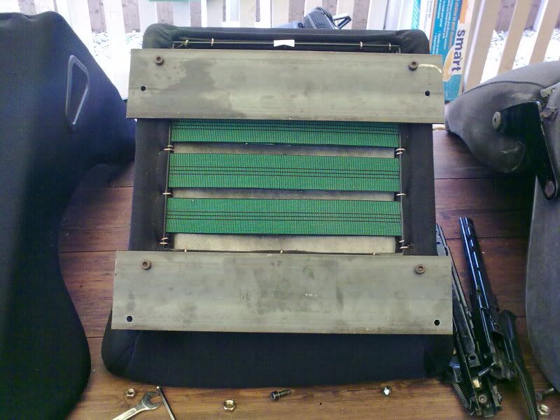

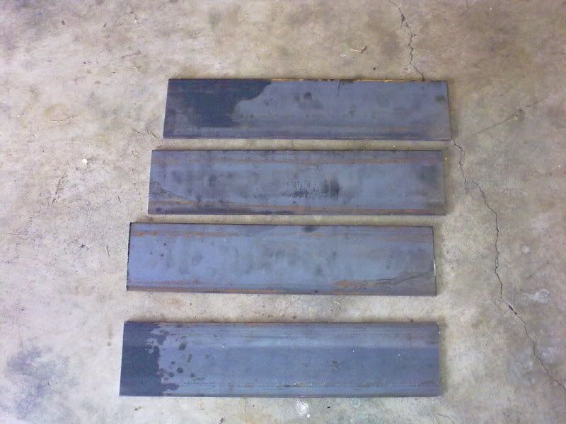

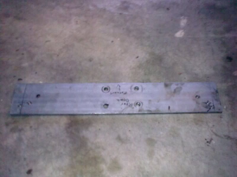

Then I decided to have another crack at seat mounts. Cut up some pieces of 5x100mm flat:
By positioning the holes differently, I managed to move the seat about 6mm further back relative to the rails, which should be JUST enough to still allow me to do up the rear bolts for the rails:

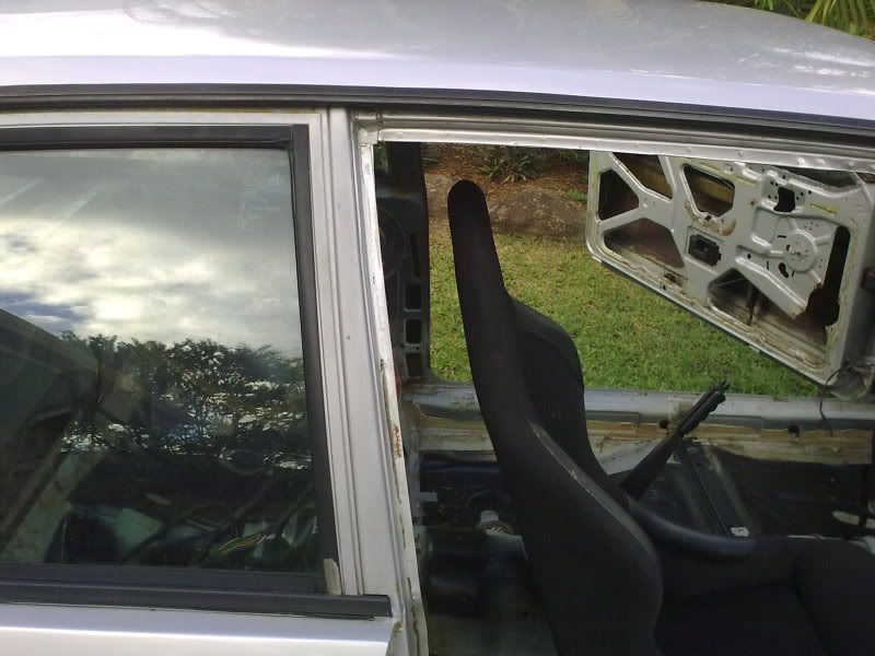

This time I decided to try fitting them up without using the factory spacers on the rear bols, giving the seat a bit more lean backwards:

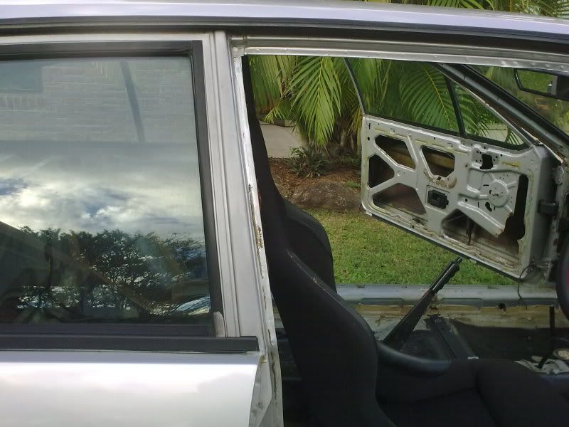

Great success! I was able to find a comfortable driving position almost instantly. The most comfortable position for me has the seat pretty much in line with the B pillar:
It can go a fair bit further forward:
Or a little bit further back (harder to illustrate):

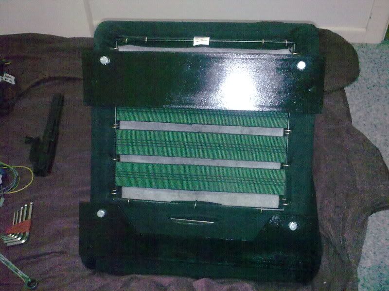

Went and bought some new HT bolts n sh*t yesterday so I could finish of the seat rails.
Brackets bolted to seats:

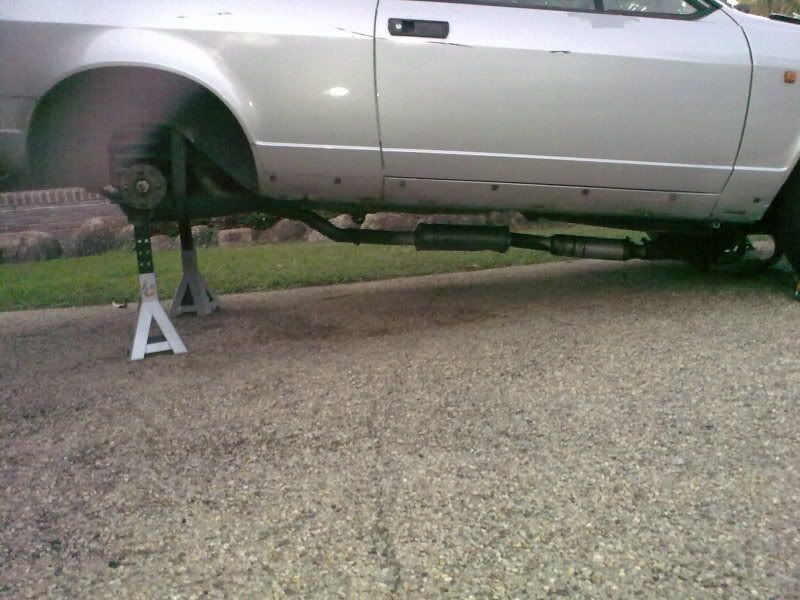

This arvo I put the back end up so I could make a start on getting the transaxle etc out:
Got the fuel tank out too. Exhaust is completely unbolted:
However due to some f*cking useless exhaust shop putting not a single flange from the headers to the exit, I can't get it out :) (it runs over the rear end setup). I'll have to attack it with a grinder tomorrow.

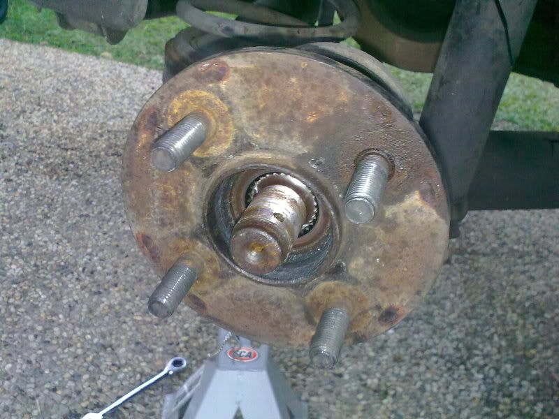

Also, I don't have a socket big enough to undo these nuts:
They seem to be about 36mm, probably something imperial though.

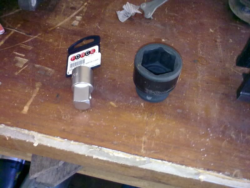

Success, impact socket was cheaper than normal one anyway. Got home just after lunch and BAM:
Socket too big to fit in the hub, F*CK. Hopefully I can go back and exchange it for a non-impact (which I'll have to wait for).

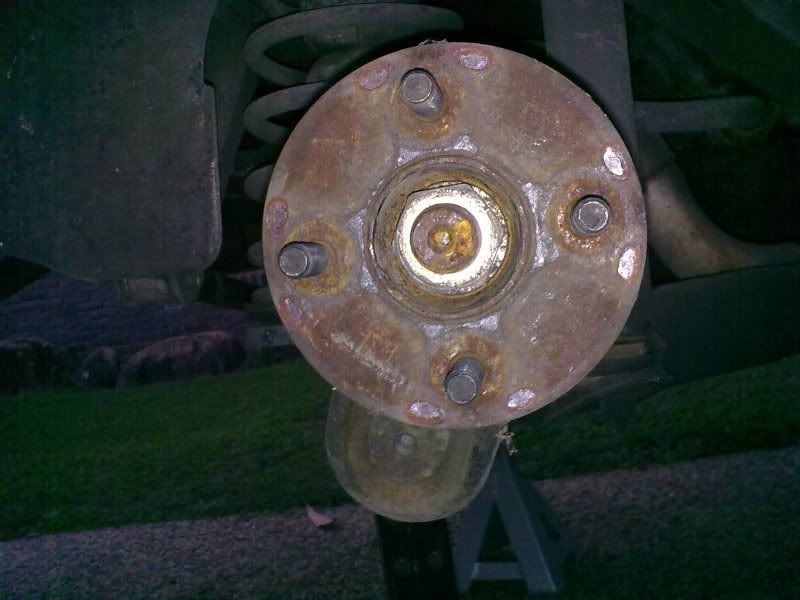

Dan came to the rescue though and somehow got a 36mm socket delivered from his work :). 2 rattle guns later though, the little f*ckers would not budge. So we went all old school and got out the breaker bar and pipe. This just started to spin the drive shaft, even with the hand brake on and foot brake mashed against the floor. So we put it in gear as well, and put another breaker bar on the front of the engine. This succeeded in finally freeing the seized clutch, which started to slip :rofl:.
Then I took some bits of 5mm steel (look familiar? :blink:) and drilled some holes in them so they could bolt on to the back of the hub (where the half shaft would normally bolt to) and stop it from spinning:
Bolted them up and then proceeded to break my breaker bar :rofl:

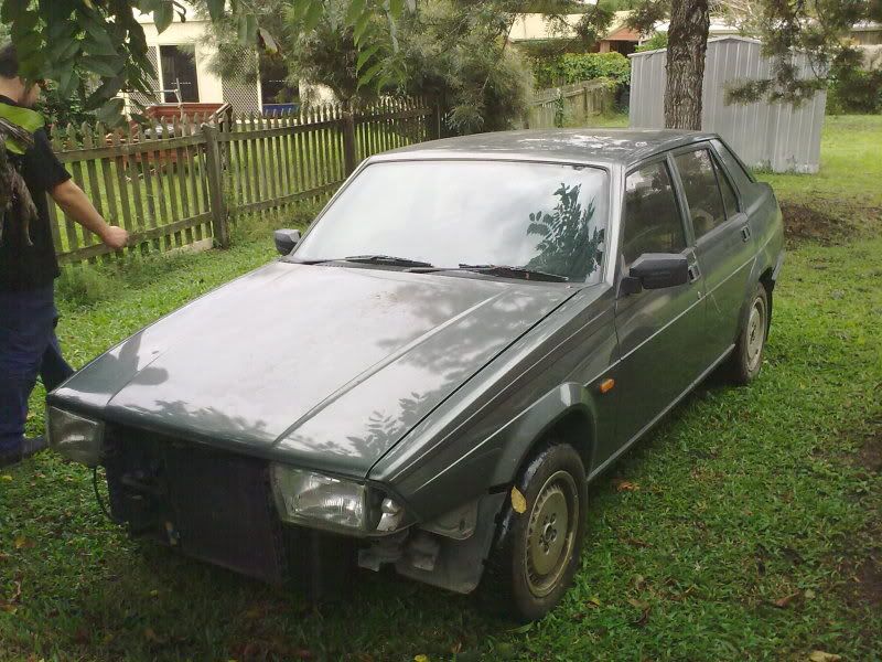

Sick of it by then, we had a bit of a play trying to get the 75 running. This included some 31 club engineering (read: fuel pump dodginess):
As the fuel pump in it seems to be dead. But even with a definite supply of fuel she would not start, turns out the injectors aren't firing either. Suspect dead ECU or wiring fault.
So failed at that, back to the f*cking hub nuts. Found another short arse breaker bar lying around, this + pipe succeeded in getting one nut off! Although, it was not looking really happy after doing so. Got it on to the second nut and then broke that breaker bar broke as well :rofl:. But it seems that it did manage to crack the nut in the process, as we were then able to get the nut off with a rattle gun. At least the nuts are now off:

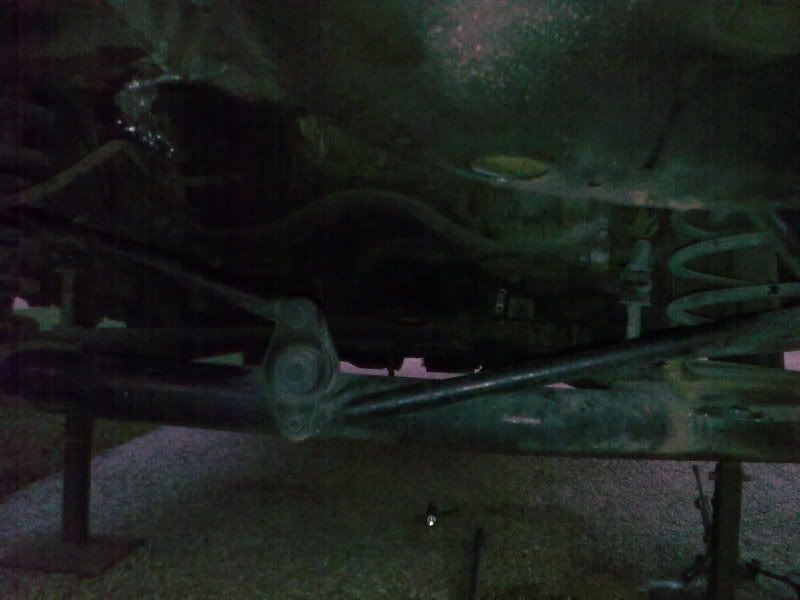

And yeah, as Dan alluded to we had a bit of excitement when we realised that some idiot had put the axle stands under the de-dion triangle, then proceeded to unbolt said triangle :(. Oops. It was still holding it up, but very unstable. Found the proper points on the body for the axle stands and moved them, all good.

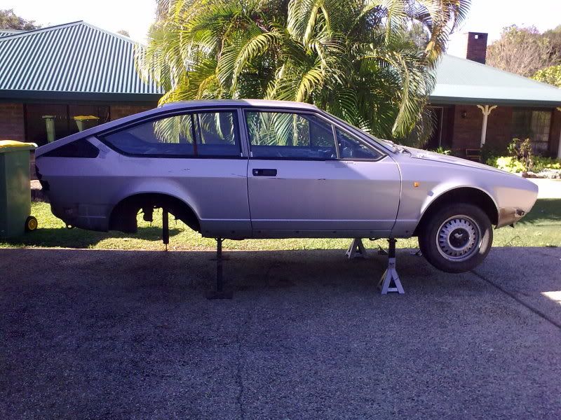

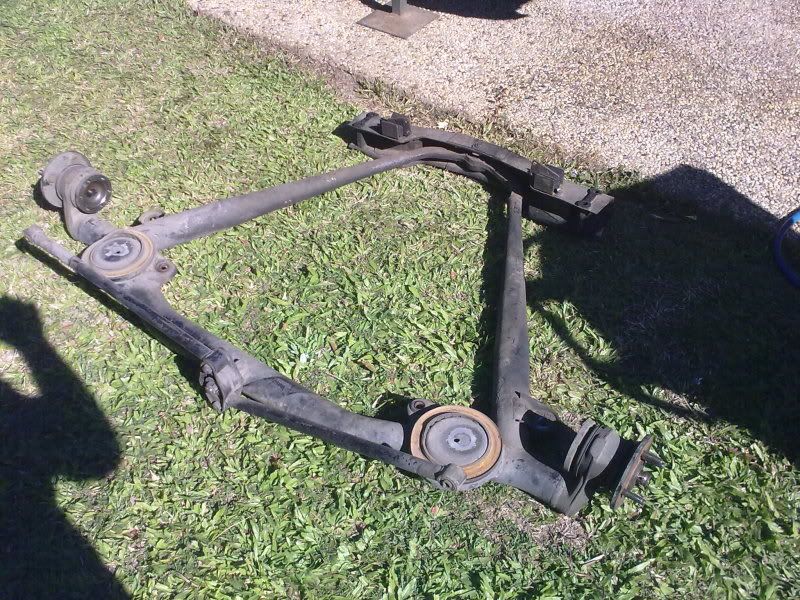

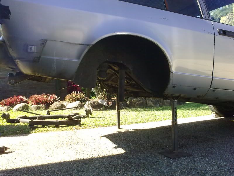

Decided it would be easier to swap the whole rear axle/triangles over than trying to get those hubs off, so it is out:

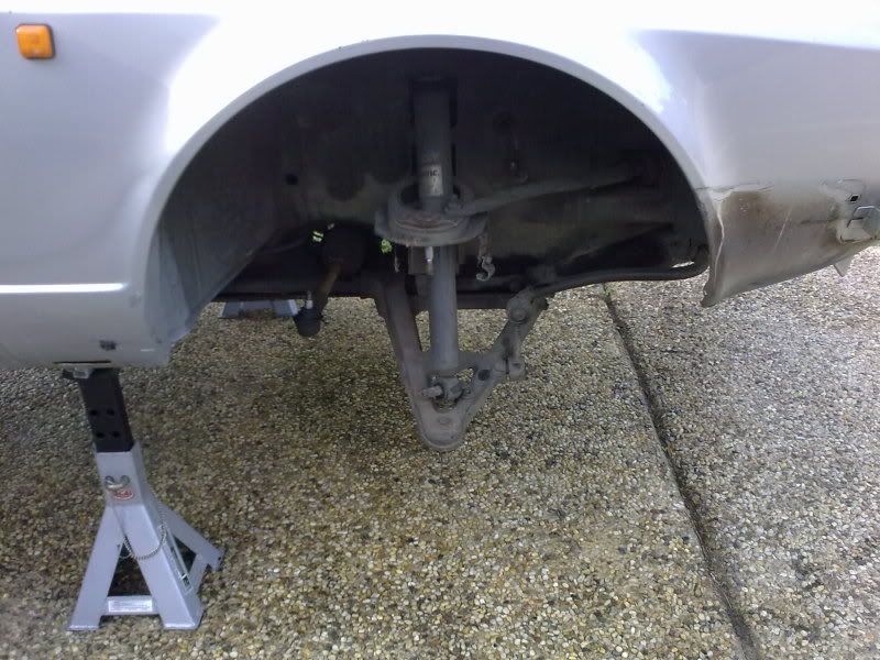

Then got the front up:
And the front spindles out:
Had to 'modify' my ball joint seperator to fit the ball joints (cut the opening bigger with a grinder :ninja:).
Next weekend hopefully we'll push the 75 round and rip everything out of that to swap.

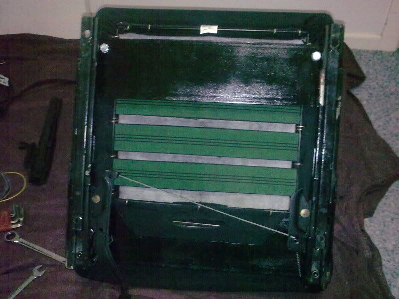

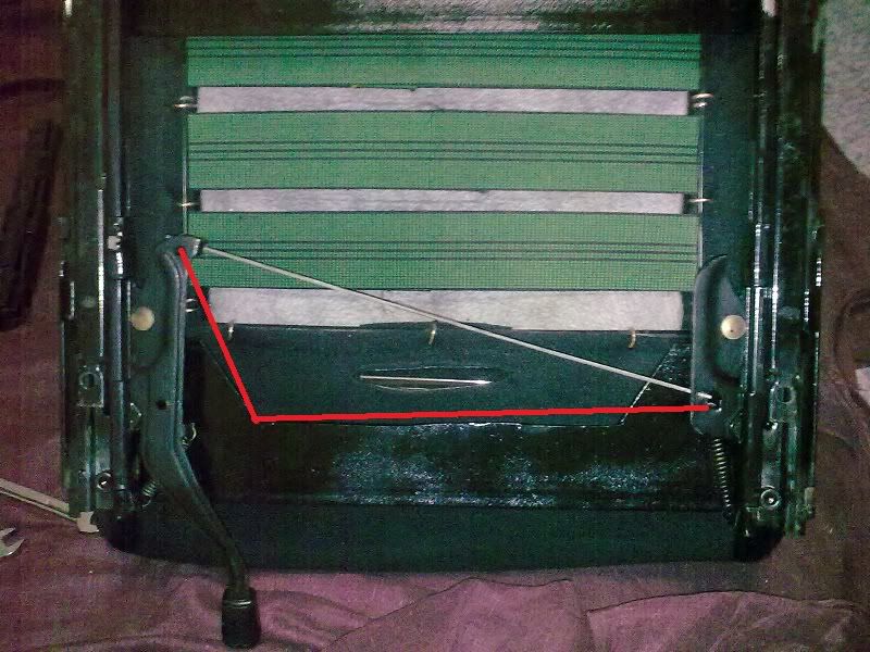

Also did a proof of concept of new linkage for the seats:
This is just a straight bit of ally flat bar. Works well (actually better than the stock one because there is no give) but doesn't gain any clearance for the straps. Next I'll try something with a 45 deg or so angle to gain clearance. Hopefully it will work.

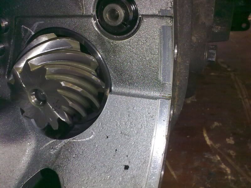

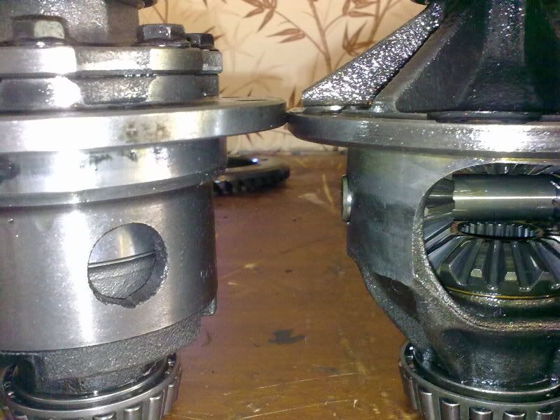

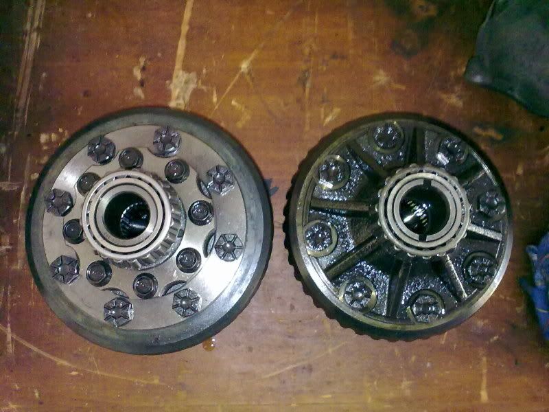

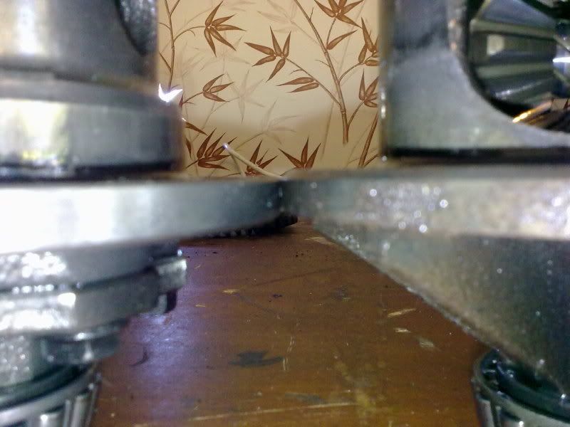

I've also been taking the transaxles apart to see what can and can't be swapped. It's not looking real promising, with the crownwheels in different positions on the different centers:
Other transaxle pictures for funsies:
