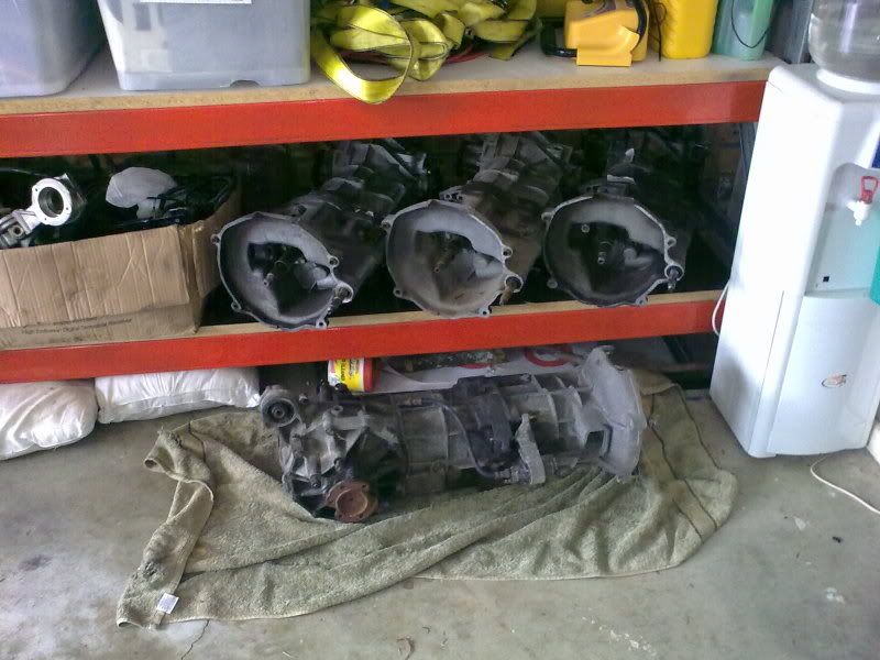

Box:
Moar Box:

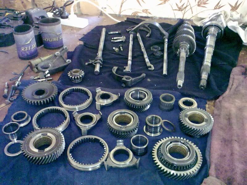

Got bored so decided to strip down the one on the bench. Got about this far:
Actually I got all the selector forks n shit out too, but forgot to take a pic. Unfortunately I didn't have anything to undo the nut holding the main shaft together, so I couldn't get any further.

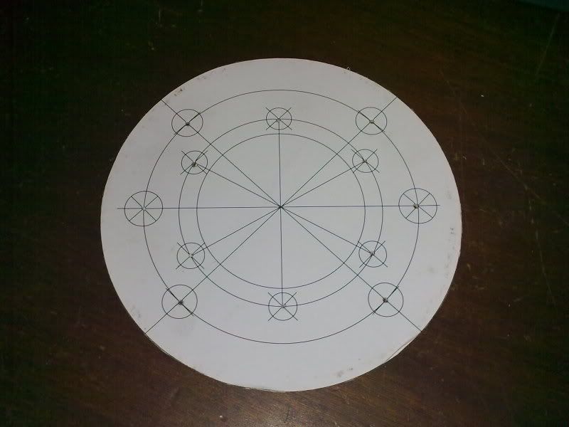

Finally, I made up a template for redrilling some peugeot rotors for bolting onto the transaxle:
Mmmm... 22mm vented goodness for the rear

Got the nut off the pinion shaft, and dissassembled the gearbox:

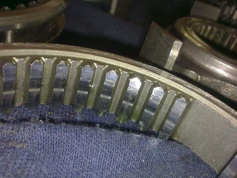

This gearbox is the one that was in the boot of the 75, I think I know now why it was removed, the teeth on the 3rd/4th gear dog ring are ratshit.
From this box I'll be taking: The input shaft and gears 1-3, as well as the selector shaft.
Synchros, dog rings, etc I'll be taking the best ones I can find out of all the boxes

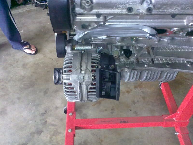

Anyway, progress has been happening again. First problem to solve was the alternator/belt. Basically, stock the V6 has the alternator on the drivers side, and the A/C and P/S on the passenger side, all driven by one big 6 rib belt. Problem is, if you remove the A/C and P/S, and leave the alternator where it is, due to the location of the tensioner there is no way to route the belt and make it work. So I set about modifying the bracket to sit the alternator on the other side, where the A/C used to be. Used one of the original holes and had to drill 2 more and then grind them out enough to get a socket on:
Alternator then bolted up (after shortening the studs, as they were way too long) and I was hoping that there would be enough adjustment on the bracket to set the pulley in the right spot for the belt. Unfortunately, even with it as far forward as it would go, it didn't line up :( :
A bit of grinder love and some nuts acting as temporary spacers, and that issue is sorted:

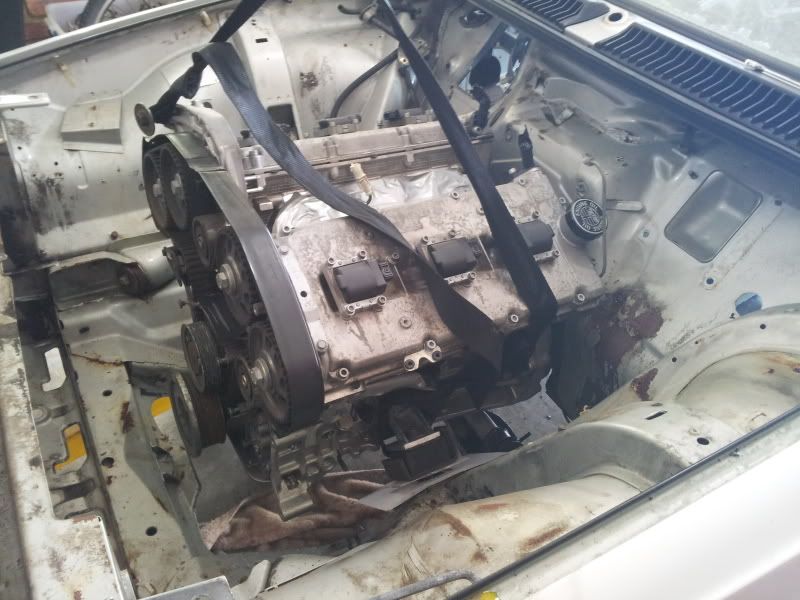

Time to stick it in:
The first snag we hit was that the studs on the engine mounts were catching, preventing the engine from going back far enough. So I cut them down:
That helped, and then we discovered that the holes in the rear engine mount did not seem to be wide enough apart for the studs it had to go on... seemed the studs were a bit bent. A bit of love with a pry bar sorted that out.
The engine was o so close to going in, but not quite:
The holes in the body were just not quite in the right spot for the stud/nut on the RB30 engine mounts :(.
So, grinder time again:
These cuts still need to be tidied up... but for today it was good enough.

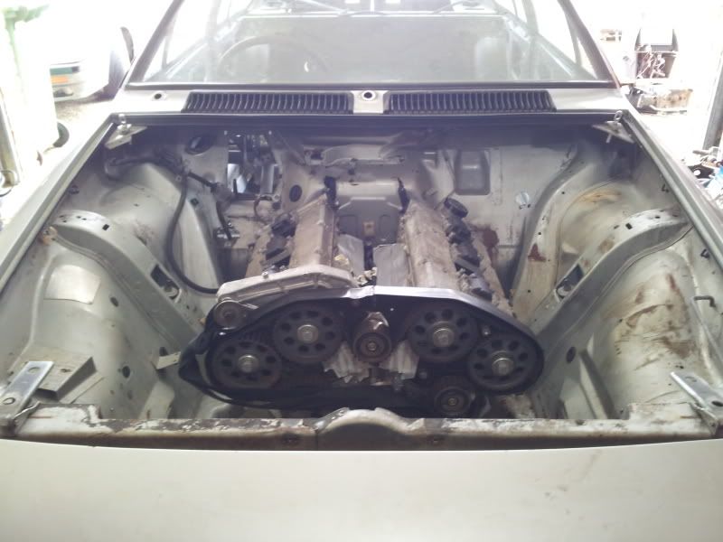

Success!

1) The alternator does not fit:
I suspect hammer love will solve this...
