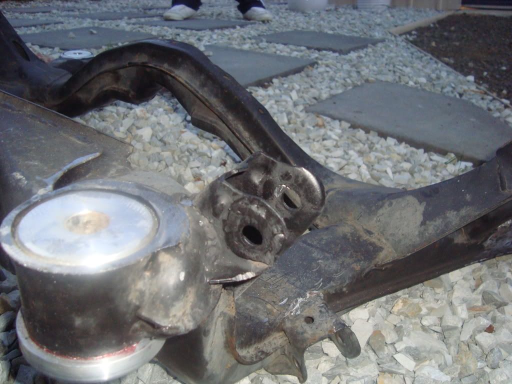

mounting the pinapples like that isnt going to give much of an increase in handling, they are just acting as a spacer for the nut.. the initial idea of the pinapples was to change the alignment of the cradle... nose down for less squat for drifting etc.. tail down for more squat for drags etc..
the handling increase comes from mounting them top and bottom and taking hardening up the crumbling cradle bushes.. but to get the best handling, you have to fully lock or eliminate those cradle bushes..
if you want a comfortable drive, leave them alone.. if you want to tighten up the cradle for better handling but less comfort.. get alloy lock rings..

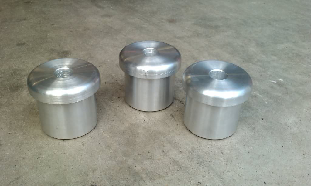

would you recommend the alloy lock rings for a street car.. you say less comfort but that doesnt bother me too much.. aslong as its not going to damage anything.. and any good good alloy lock rings? links or pictures would be sweet.
Thanks
are you meaning these
http://www.jappartsuk.com/store/uploads/im..._large/1159.jpg
or
http://www.jappartsuk.com/store/uploads/im..._large/1158.jpg
Edited by 30edR32
the second ones are the slip on lock rings.. they are very easy to install.. and yes id recomend them.. they are fine on the street when the pay off is more control.. coilovers decrease comfort ten fold over what the rings do.
the first pic are replacement alloy bushes... you'd need to remove the subframe, get the old bushes pressed out, and then put those ones in..
these ones are better
because they allow the subframe to sit hard against the chassis.

30edR32 looks ok. whats the material used?
not a fan of the designs where its just a straight through hole. i like the ones that i had made and designed with a mate (i might be biased) because it retains the step washer that nissan use. as well as the front plates.
They're duravar UHMW polyethylene.. meant to be stronger than polyurethane ..if they are what they say they are then theyre stronger as -ene has more carbon bonds than -ane, but thats a different subject all together
