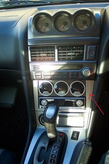

Where can I get those inserts??? The one's the arrow is pointing at, cheers

hi i know this is half a year late but i got those inserts from osaka imports in knox although the guy said its the last one "although im pretty sure i saw one lying around when i was there" :S maby if u call them they might be able to figure something out.
ive had to do the same thing becuase i got my car with a screen in it so ive had to get the cd player surrounding panel and also a new climate control unit.
series 2 r34 look different again..lol when you have the DVD, MD, SAT NAV, CD CHANGER, TV POP UP from the factory
the radio trim part and double din steel insert is what your after, and a trim plate for the climate control to move the parts up.
