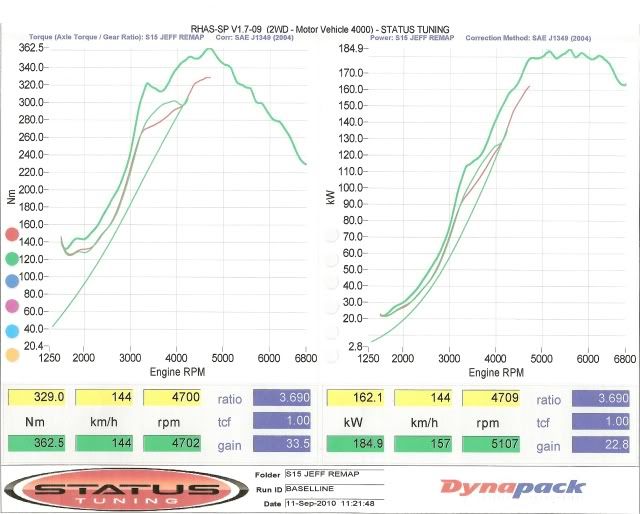

Car got tuned @ Status today!!! Very friendly/helpful, would definitely recommend them. Below are the results:
Year/Model: 01 Spec S (adm)
Engine/Size: 2.0 SR20DET
Turbo: t28 bush bearing
Power @ boost level: 185rwkw @ 15psi
Torque: 362.5 Nm
ECU: Nistune
Modifications: gktech fmic, fujitsubo exhaust, apexi intake, walbro fuel pump, turbotech mbc

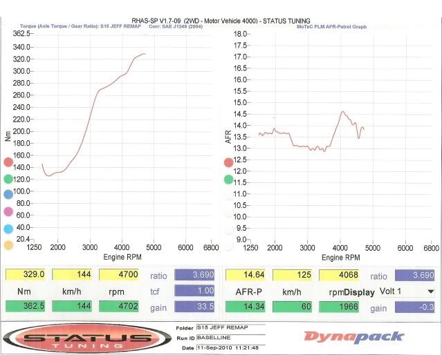

My car initially made 162rwkw @ 14psi but was pinging its head off @ 14.5 AFR (massive black smoke at end of exhaust). I was really shocked and worried as trent could see.
But all is good now with the tune, sits nicely at 12AFR though the coilpacks are on the way out...
You can see it pinging (red)
Car now drives extremely smooth especially down low where it felt like a slug previously. Love the pull at around 3500rpm.
Thanks Trent for saving my engine :D
