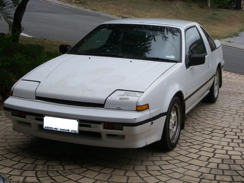

Behold, the fabled $100 (S)Exa, the missing cylinder is injector related, I can't hear a pulse and the loom seems shabby (loses another cylinder on moving) OK time for some TLC and boost!!!!

Targa roof is pretty cool, though I got over it pretty quickly when I had my NX Coupe for 2 months lol Was a first car, affordable sporty SR20 run around :blush: What I liked though was that I could remove the inserts on the targa roof and use it like a sun roof :)

Yeah there is a leak in the targa roof, I'm thinking of using silicone to permanently seal it. I'll never use it I'd say, too much messing around unlike a sunroof.
Fixing the loom up today, then engine is actually pretty good, just the rocker covers seals need replacing and a minor clutch line leak.
