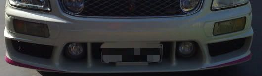

i went with the type 1, and i had to trim alot of my bar, as long as cut the hole for piping, and
trim back the rio...
so i went from this -
to this -
you can see where the rio was cut here -
and finally to this -
ive since made some proper brackets for the numberplate instead of cable ties...
at the end of the day its up to you which way u wanna go, i wasnt really fussed about my extra lights,
and i had to chop out the middle where the number plate was anyway otherwise more than 50% of the
cooler would be blocked....
