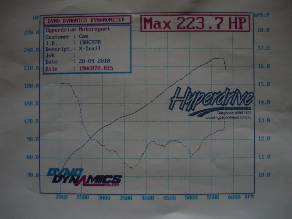

Here's my most recent graph from his tune:
Even with weird AFRs like that its still safe and hasn't caused me any problems...
I'd encourage you to give it (tuning) a go yourself. (I'll lend ya my lambda sensor and AFR gauge if ya really want!) Depends on the Nistune software (how easy it is to use), but my EMS software wasn't hard at all.
Since then I've done a bit of my own tuning, tuned out a rough spot around 3k rpm and -10mmhg vacuum and i'm attempting to tune out another one at about 2k rpm and similar load.
The poor fuel economy could be caused by decelleration fuel cut or maybe your cruising AFRs are too rich. I've been working for the WA sporting car club today @ barbagallo today, and I've seen numerous cars with Hyperdrive stickers on them, so I doubt Andrew would've given your car back without it having a decent enough tune...
