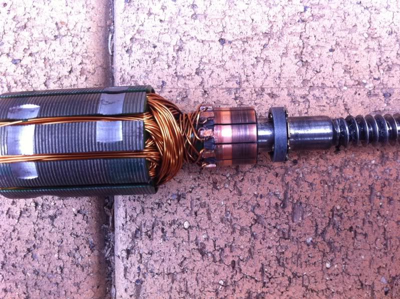

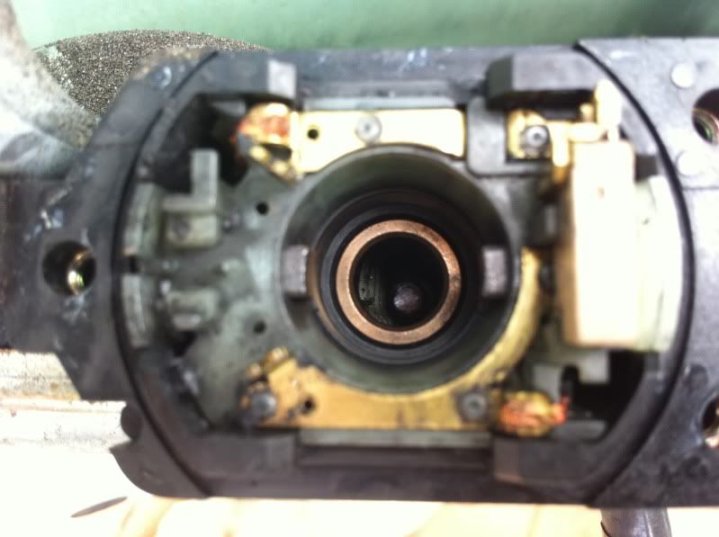

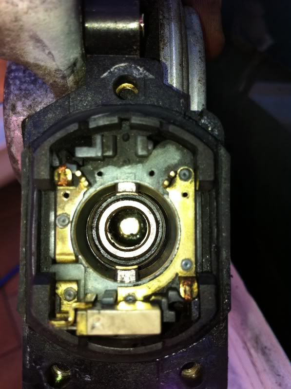

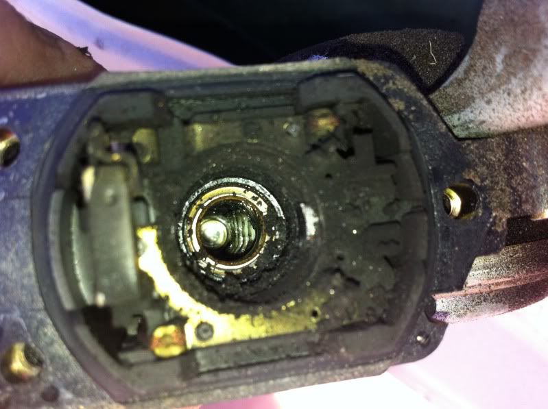

Here is what my drivers side motor looked like b4 clean
Drivers side motor after
Passenger side after
Also cleaned the contacts which before were so dirty you couldn't see the spaces in between...
