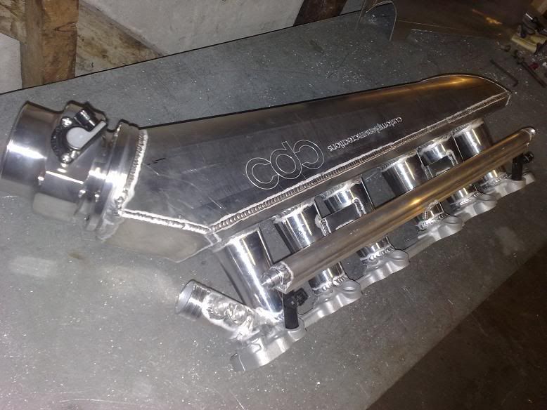

for the amount of money some of you guys are talking for a manifold, I can make one with custom runners, 80mm billet throttle body and billet rail and all polished....oh and did I mention able to flow more than any of them!!!! similar to the pic below. that is for an rb30, but the concept is the same.
and yes it will accept the IACV
How much you charge for one of these to? to suit RB25 with the billet fuel rail and throttle
Cheers mate, they look good
$1200 for the plenum
$430 for the 80mm billet throttle body with tps and plug
$230 for the fuel rail
+ delivery which is usually around $50
With a total of $1910 you are looking at a complete intake side for any rb series engine....compare that in price and flow/power potential, it is very hard to beat

how much hp can ur manifolds flow efficiently. hypertune (102mm version) flows 1400hp+.
ive asked before but u didnt give me a power figure.
cheers
julz
Edited by GUN_METAL_GTR32
That's a generic question considering they are all different and it can depend on what the customers wants from their engine.
Strange that I haven't answered it in the past because I usually do.
If you are talking about the rb26, it flows enough to support well in excess of 1500hp and that's with an 80mm throttle body. I usually don't recommend anything larger than 80mm. There are somethings to be taken from the different size throttle bodies used but not something I will do in a public forum.
The single cam rb30 plenum pictured can flow in excess of 1200hp and again with an 80mm throttle body.
The best thing about the it how well they flow between cylinders and proven on some recent dyno testing (using individual egt's to measure results) to support the flow tests.
I take pride in making sure all cylinders flow as even as possible and combining that with maximum flow.
Let's just say that the bellmouth size, design, plenum volume and throttle body size should all be matched - edit: when there is little or no compromise for performance
94mm is more than enough for anything you throw at it. Just as an example, there are some guys in the US making over 2000hp and using a single 100mm, is this the most effecient setup? it could be argued either way....and if there are any RB pumping out those kind of numbers, I would love to have a look at the intake manifold to see what thought has gone into it and compare it to what I have seen.
A lot of the time people just go for the look of the 80mm throttle body....but having said that, I have seen very very good results from 80mm throttle bodies on your little ca18/sr20 all combined with a good plenum design.
