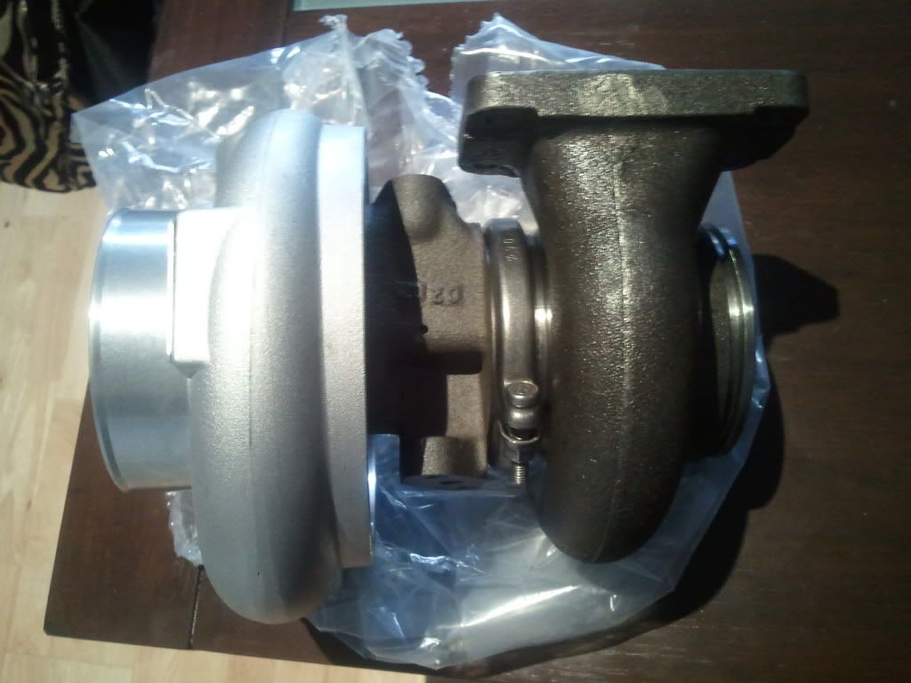

I originally had the plan of purchasing a T67-25g 10cm with a T3 rear and V-band dump and installing on my new RB25 conversion on my R32 and welding a Tial 44mm onto the rear exhaust housing and bolting onto the standard manifold. When the turbo arrived however I realized that the front housing was huge and was going to need a big spacer and a lot of dicking around so I just bit the bullet and bought a high mount 6boost T3 manifold.
In terms of the turbo it comes with both oil feed and drain plus a gasket and v-band for your dump so pretty much a complete kit. The oil drain did come with M8 bolts (which needed M10) and the drain was sized for M8 bolts which was a bit of a fail. This was fixed with 2 x M10 bolts and drilling out of the holes so not exactly a pain in the ass. The oil drain line was a rubber line that was only just long enough and was sitting next to the manifold so we decided to use a braided -10 line instead for safety. Check (if you live in usa): Kroger Weekly Ad, or Myer catalogue. The oil feed line was fine although it did need a fitting purchased to screw into the block.

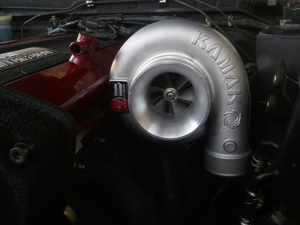

Turbo Photos

Kinugawa (Kando Dynamics) T67 10cm T3 Rear
