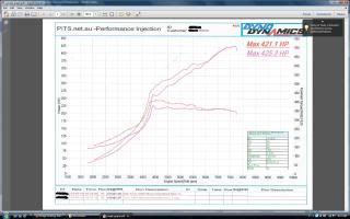

Here is the 3037s graph showing torque and power. The pink run was the original turbo, the red one was after it was rebuilt by GCG.
Look for a faint pencil line, that is SimonR32's run on E85. It shows T67 a little behind the 3037 until 4500- there's nothing in it so you can say they are roughly the same- after which, the T67 walks away.
Both my runs are at 19psi
I know i said mine made 430, it did, this was re-tuned after i plumbed the external gate back into the main exhaust which lost some power in the top end - not shown in these graphs.

Any change of a bigger dyno? cant see anything :)
If you attach the full size it will shrink it down for normal view then you can click on it to see the full image.

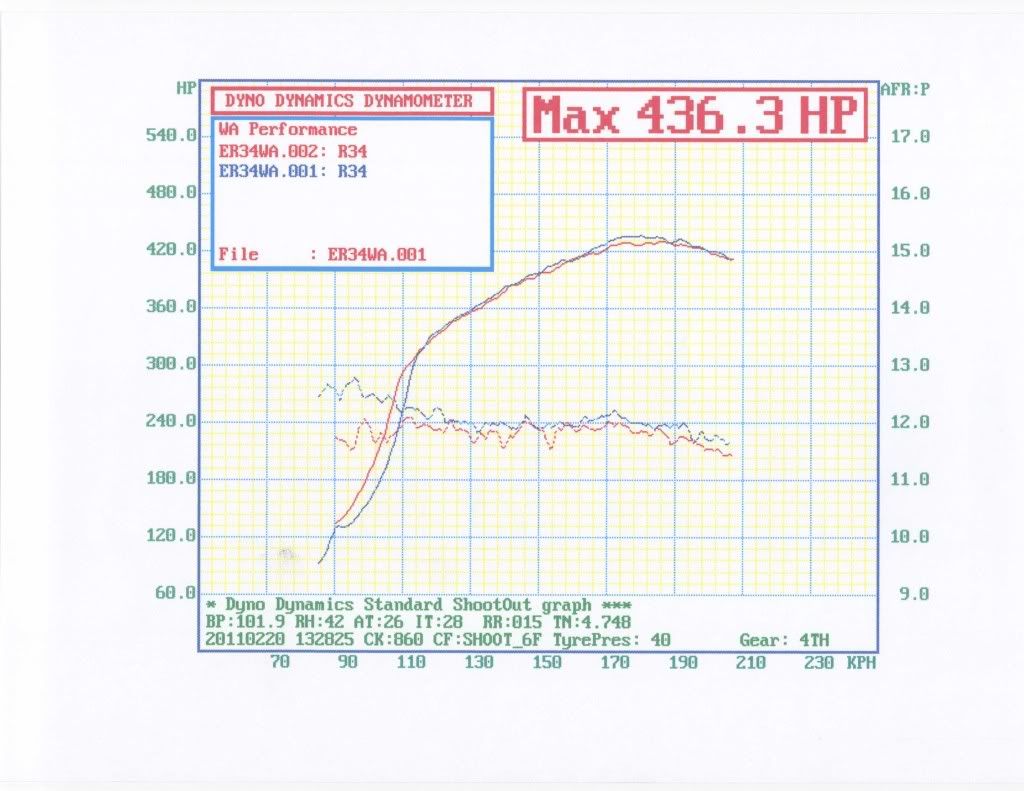

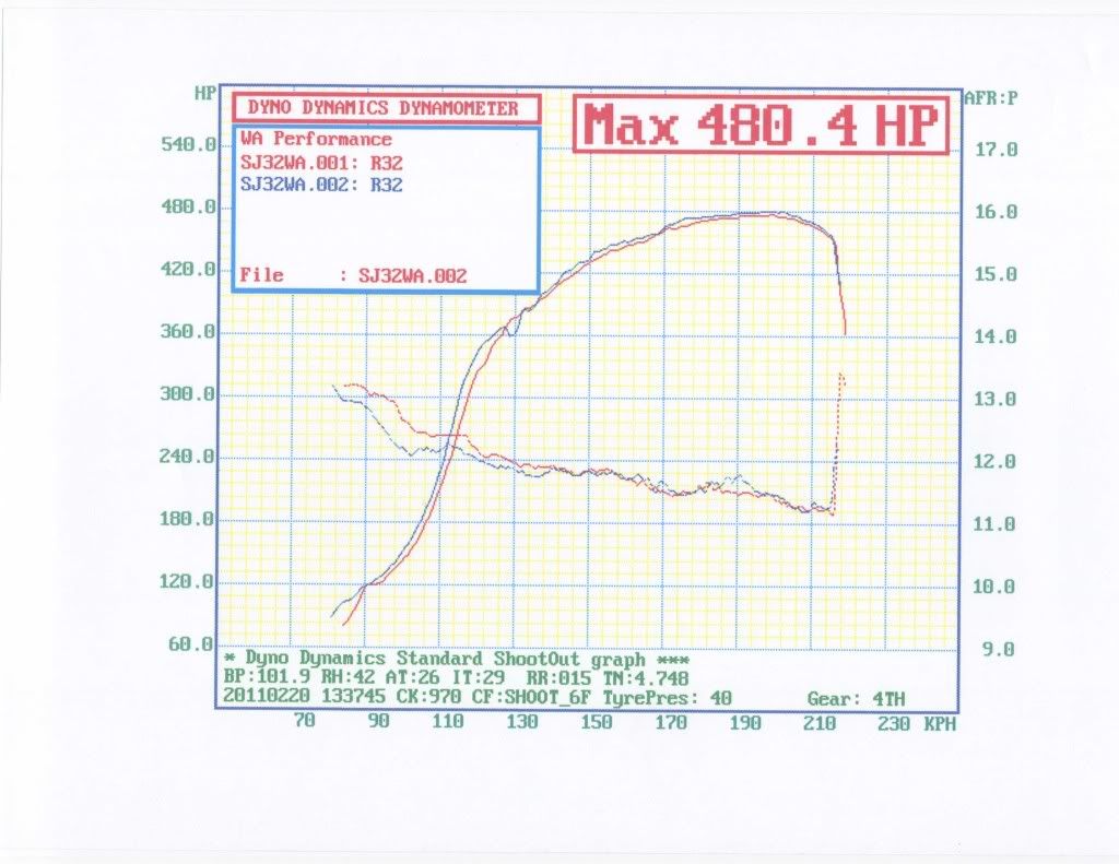

Yeah can't see shit! But if you want to compare a GT3076R (same as HKS 3037) with the T67 see this post
And here is a comparison of a 3076r with the same fuel, on the same dyno on the same day... Mine runs a little more boost, but this one has tomei poncams

You can thank photobucket for resizing it, I'll have another go tonight when I'm home.
Are they both on E85 or 98?
Both on jew mix, 50% E85 and 50% BP98
Which is the T67 and which is the GT30R?
T67 is the slightly lazier 480rwhp and the GT3076R is the 436rwhp
