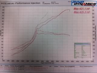

Here is the 3037s graph showing torque and power. The pink run was the original turbo, the red one was after it was rebuilt by GCG.
Look for a faint pencil line, that is SimonR32's run on E85. It shows T67 a little behind the 3037 until 4500- there's nothing in it so you can say they are roughly the same- after which, the T67 walks away.
Both my runs are at 19psi
I know i said mine made 430, it did, this was re-tuned after i plumbed the external gate back into the main exhaust which lost some power in the top end - not shown in these graphs.
Here is the power/torque graph i tried to post a few days ago. Hopefully this is clearer/bigger, I've included the link this time as well.
http://i51.photobucket.com/albums/f377/jungle71/photo.jpg
