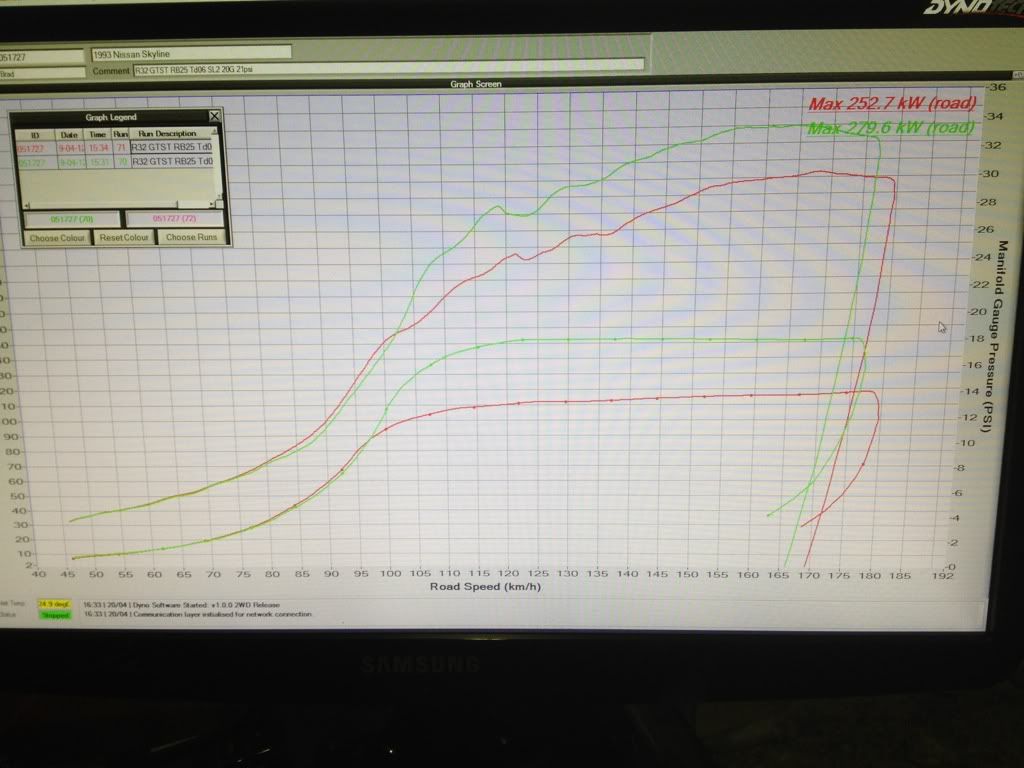

Thats helps loads. Thanks. I am assuiming ts on 98? Is VCT on? A friend wants my TD06-20G when i take it off in a few weeks and trying to find some results to show him to give him a reliable feel for what he will be able to get out of it
Yes this has VTC on and is tuned on 98 octane fuel.
