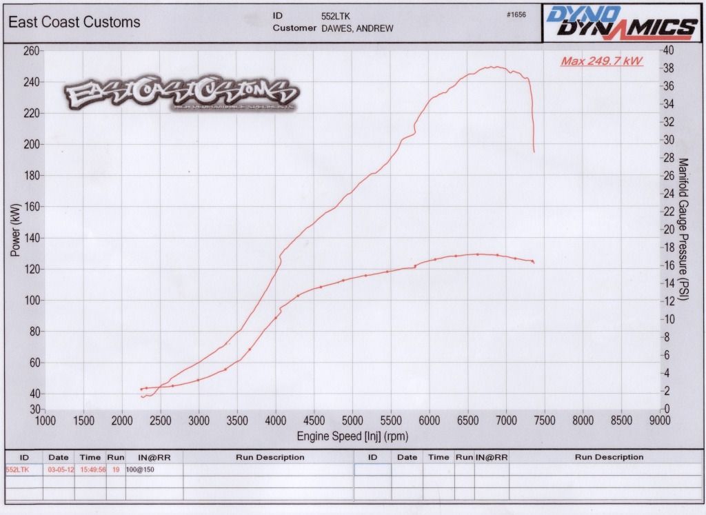

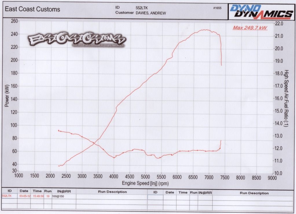

raZ1911 Posted May 6, 2012 Share Posted May 6, 2012 Oops i posted up the wrong one. Tuner said the gate was the main problem. Engine also has China manifold as well as Greddy copy plenum and 80mm throttle body. Link to comment https://www.sau.com.au/forums/topic/347726-kando-dynamics-turbo/page/175/#findComment-6345572 Share on other sites More sharing options...
DVS JEZ Posted May 6, 2012 Share Posted May 6, 2012 Looks like it needs a better boost controller, bring it onto 18psi early then it may hold 18. Link to comment https://www.sau.com.au/forums/topic/347726-kando-dynamics-turbo/page/175/#findComment-6345578 Share on other sites More sharing options...
ARTZ Posted May 6, 2012 Share Posted May 6, 2012 what gate is it? Link to comment https://www.sau.com.au/forums/topic/347726-kando-dynamics-turbo/page/175/#findComment-6345644 Share on other sites More sharing options...
Bsa Posted May 6, 2012 Share Posted May 6, 2012 What spring is in the gate? I had a 7 pound spring in my gate running 18 pound with a mbc once I put a highter spring in lag was reduced drastically Link to comment https://www.sau.com.au/forums/topic/347726-kando-dynamics-turbo/page/175/#findComment-6345667 Share on other sites More sharing options...
raZ1911 Posted May 6, 2012 Share Posted May 6, 2012 Has a greddy profec e 01. Boost controller works fine as it came off another car working and proven on dyno. Tuner tried everything he could with the boost controller to help get it to what it was. Gate is a 38mm Tial, has 14PSI spring in it. Link to comment https://www.sau.com.au/forums/topic/347726-kando-dynamics-turbo/page/175/#findComment-6345793 Share on other sites More sharing options...
DVS JEZ Posted May 6, 2012 Share Posted May 6, 2012 Because the boost falls over at the top it seems inconsistant with boost creep as creep should keep climbing all the way to redline. But 38mm is right on the limit. What im saying is use te boost controller to try and run 18psi solid from 4 to redline. If he had not control at all with the boost then the boost controller lines are back to front Link to comment https://www.sau.com.au/forums/topic/347726-kando-dynamics-turbo/page/175/#findComment-6346005 Share on other sites More sharing options...
