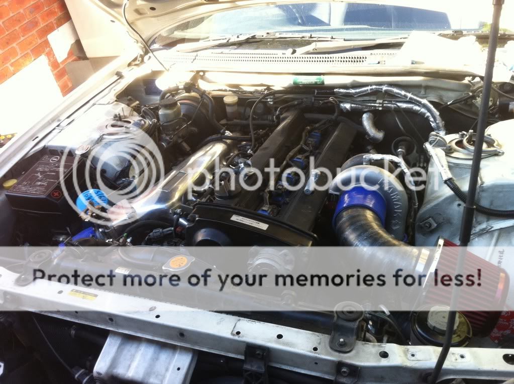

nice plenum :P
that turbos not laggy at all, it has as much power at 3500 as any 3071/76 or 2835
..Brilliant result..
Got mine tuned today :)

333kw
More in it but settled here due to injectors near max and valve springs getting loose up top.
Gotta take it for a decent drive before i say too much about how it drives and if i will push for more. Sounds CRAZY!!!! on boost :)
t67-25g
6boost
tial 44mm
freedy plenum
z32 in cooler piping
power FC
profec B II
740cc highflowed stock injectors
bosch 044
3" exhaust
Adjustable EX cam gear
exceedy 5 puk clutch (gonna have to get a twin plate i think!!)
E85 (trent tested it at E65) springvale stuff

Built the thing on the cheap I already had the power FC and Profec B, cost me close to $3.5k including the tune.
First time i have done any pipe work too did it all with mild steel tube lobster back style and welded with an Oxy!!!
Edited by battery
Was a kent to pull the stock one off!!!
I did a fair bit of port matching with a dremel on it too... came up good, no leaks!

Im a big fan of bang for buck setups and for between 3.5-4k i got
Tune
Turbo
Manifold
Gate
plenum
injectors
Z32
stack of 2.5",3" and 4" MS pipe
bosch 044
braided oil drain
Bunch of hose, nuts/bolts, joiners, heat shielding, clamps and gaskets
Pod filter
Ex cam gear
Ebay and the classifieds here were the weapons of choice!
I guess there's another 30-50kw left in it but would cost me at least another $1k for springs and some injectors to get there. Then you gotta take into account the extra component stress involved and i don't think its worth it.
