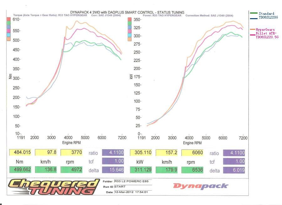

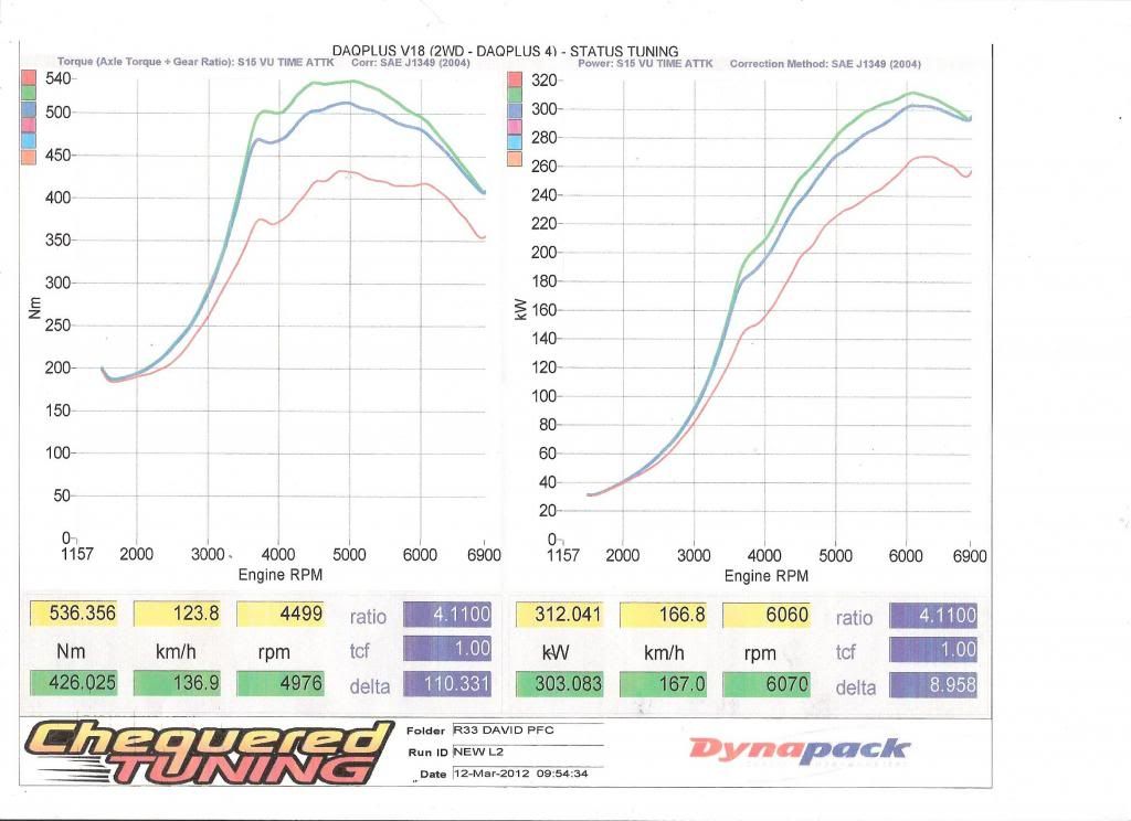

yes very tempted....looks i can only gain it definately has more top end and loses nothing anywhere else :D
its asking alot of my stock manifold, though in theory i could make the same power I do now with a little less boost...
to me the theoretical limit is in absolutes, so you could still gain midrange :)
its a gamble but seems worth it for sure! And it would be a true back to back for everyone moving forward.
Aren't you simply running moire boost so jump in mid range and power kind of expected?
need to compare thin blue power line to pink line, more power with less boost. i have a feeling the exhaust manifold heaps here too.
yeah i'm a little confused too Roy, the date on the paper is same date I got mine tuned yet neither graph looks to be mine, as mine seems to fall somewhere inbetween the pink and blue....its actually closer to the pink but with a bit more boost and im topping out earlier..Im wondering if the standard manifold is helping create a little more torque in my midrange as well..
and why is Staos car 10kms slower at 6060rpm??
the times also dont match, maybe an earlier tune than my final been used or maybe my tune with a high mount got a different result I dunno......obviously I dont yet fully understand the intricacies of dyno tuning but I daresay the small differences we see are just mechanical.....i was also running a 3.5 ex and screamer at time of tune..it has all been plumbed back now..
I think its fair to say the manifold has made some difference. But, it is also fair to say Staos new wheel can definitely pump more boost and power than mine ever could as other cars with the sl2 and high mount haven't made that much power that I know of and usually die out around 20psi... the fact he is making more power even though the boost is dropping off a good 3 psi has to say something about its performance...
