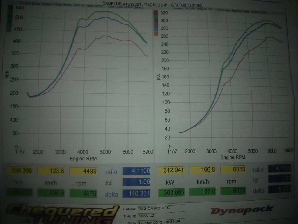

Note how the 20G falls over on top end. This is from our re-worked version: SL20.5 mentioned earlier. It is made to have the same down low torque as the 20G, while holding the power band up top. Running against Kando's TD06L2-20G on a standard RB25det motor, Same response, more power with much wider power band. Nothing is changed apart from the turbocharger. Price difference is within $100 to listed kando item.

The red line was Pulp...and only at 1 bar boost for reasons I cant rememeber....
Staos turbo with the upgraded comp wheel is the go now tho...Would def of used that if it was available at the time
