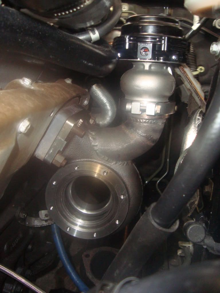

So after an adjusment its half way there, cheers again to scottynm35 who pretty much cut it, welded it and filed it smooth in the time it took me to smoke a cigarette..:thumbsup:
I reckon I may even be able to get my stock heatsheild to cover the dumps for some extra stealthishness.. :ph34r:

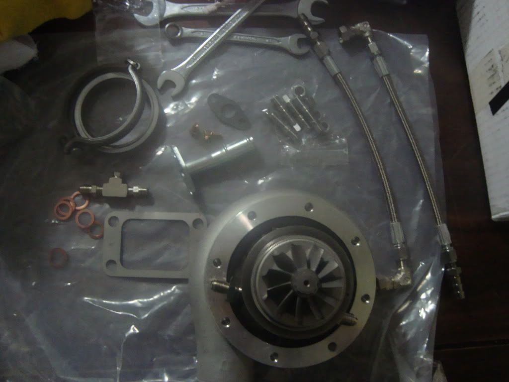

also just incase anyone is interested in what comes in your Kinguwana kit, here it is,
minus the almost metre long oil line which is in my car already.
The oil drain is very small compared to stock, not exactly sure what I will do about that.. Also I was surprised there was no blank plugs in the oil and water holes on the turbo cartridge..maybe this is normal I dunno..
does anyone know what the little T-piece sitting near the copper washes is for..I assume its for a gauge sensor, but not sure how or where it would fit in with the kit :unsure:
Ye, has a 1/8" NPT fitting for an oil pressure gauge if you want to fir one there

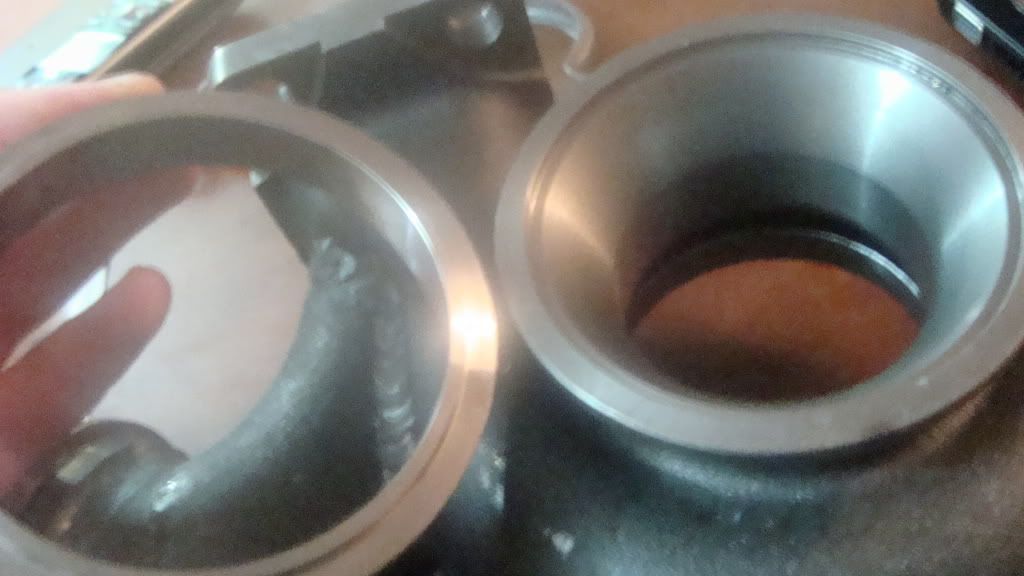

Question for you, does that lip on the mounting face of the V-band flange fit into the rear housing and allow you to clamp it?
Basically I had the same flange but the rear housing was not machined to accept the lip so I had to get him to send a flat one out. A few other guys have PM'd me saying they had the same problem and had to get a replacement sent out too.

yeah my housing is machined, fits like a glove.. guess i got lucky...
Cheers for the headsup though that could of made life hard had it not fit :cheers:
Thanks for that pic man, I'd definitely prefer to have that seal but mine seems to be sealing fine so far without it...
Scottynm35 did a great job on that housing-gate pipe!
It came up good, I wonder if you could get some sort of heatproof cover like a turbo beanie to cover the wastegate? I guess you will have a screamer plumbed over the heatsheild soon so it wont really matter, when the cops lift the bonnet you will be screwed. lol.
