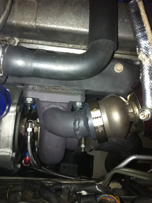

I have heard both good and bad stories about welding on the manifold, but as of yet I have never heard any issues with welding on the housing of the turbo - provided it is in the correct spot for flow, there is a diagram somewhere about it.
I got mine heat sprayed aswell for stealth+ cooling ( for cooling it was a waste of time, cant remember all up but I think was about 400 for manifold and turbo housing and had to send it away for a week ) but I think the matt balck does help instead of a bright colour.

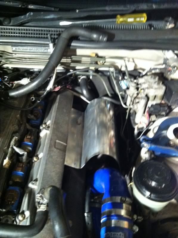

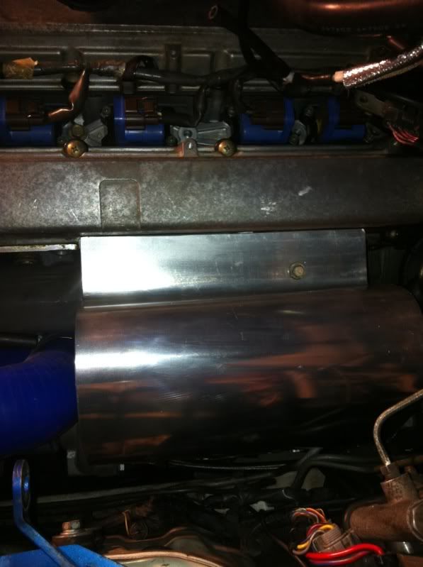

Decided to make a aluminium heatshield aswell to cover the external gate - which 1. worked way better for hiding things 2. actually functioned as a great heat barrier.
Maybe you could do something like that? Sure, a cop if they were keen could see something, but with the intake pipe ontop and other crap its very hard to tell and just looks like a heat shield... if they are that keen they will get you either way.....
This was while I was finishing drilling the holes for it:

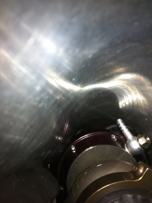

Quoted from the Turbosmart installation manual:
- DO NOT wrap the body of the wastegate with exhaust wrap
- DO NOT Mount the wastegate so that the top diaphragm housing is less than 100mm from a heat source
- Allow for adequate cool airflow around the top diaphragm housing
