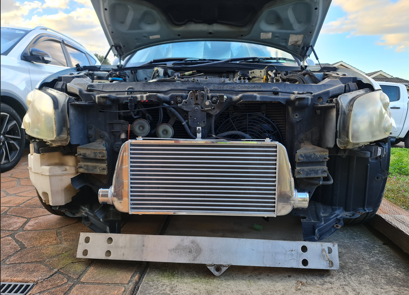

    • Update for the sake of closure   Ended up getting the intercooler piping all sorted, new plugs and yellow jacket coils, and she was idling mint until it warmed up while I was bleeding the cooling system. Found the misfire to be localised to cyl 3 by unplugging coilpacks, ran a compression test, that checked out, then decided to get a mate to check if that spark plug was firing out of the motor. Upon cranking it over, with the injectors disconnected, the car actually fired and ran on a couple cylinders and heaps of fuel came out the top of cyl 3 I'd say that injector's either spraying incorrectly or spraying far too much, which is fine as I'm planning on replacing them anyway I'm planning on making about 250kW on flex fuel, and have a set of 1000cc injectors from ozautosport, obviously overkill but I'm planning on building the motor and running more boost further down the line, do you reckon they'd be too big for a smooth idle on 98? Thanks for the replies gents, much appreciated
