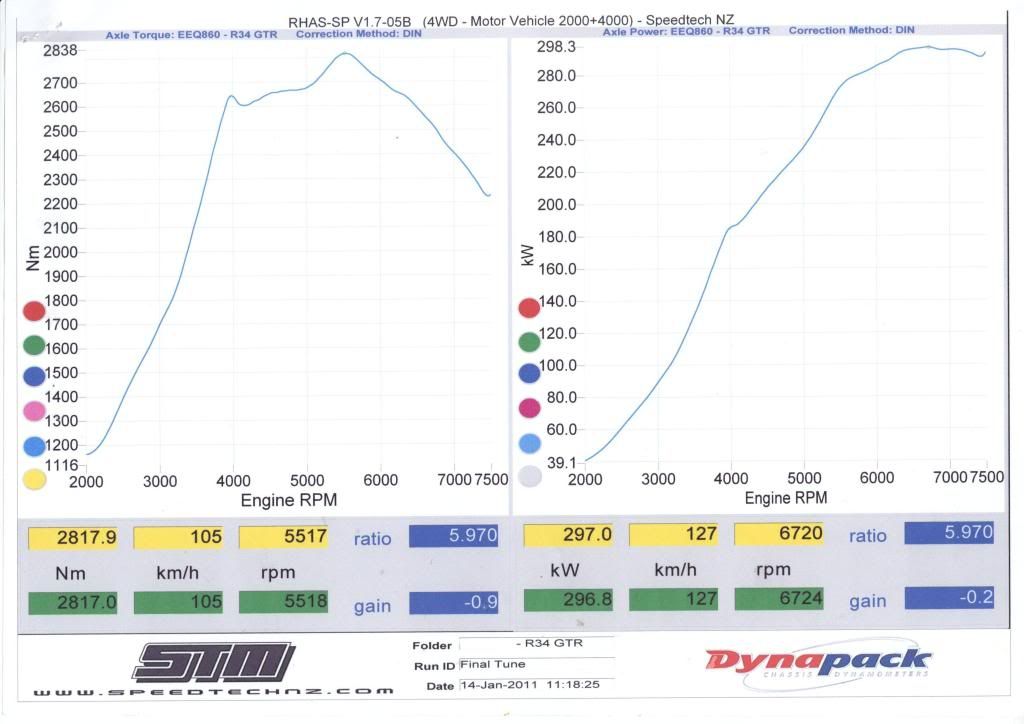

Quick update after a visit to my tuner.
First the boost response was not improved as the dyno plot shows the boost peaking at the same RPM....amazing what sound and your mind can make you think.
I guess this was to be expected considering the pipes were the same diameter.
The AFR had leaned out in the top part of the rev range.
Front pipes and cat back exhausts combined to make the AFR a full point leaner and he could hear some detonation.
So I think the $$ to getting the tune checked was well spent
On the plus side after a tweak to the tune there was in increase of 21 KW which I was not expecting at all add that to how she sounds now and I am very happy!
Thanks for the input from those that replied.
Stretch
