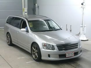

Will 18 x 9.5 +30 fit ok?
I know the GTR rims fit fine and they are 9.0 +30....
Dont want to buy rims that dont fit...again!
I would stick to 9 inch +30, mine stuck out a little on the front and were nearly rubbing on the inside but they are 17's.
I must admit, it makes the car handle the corners well with the 9 inch rims with semi's but the refinement I have now with the 8 inch + 235 road tyres makes up for it. No hint of tramlining or noise, good grip, its only the softer sidewalls causing it to feel a bit squirmy turning a tight radius corner.

Apparently if I go 245/45/18 x 9.5 +30 it'll be the same (clearance wise) as my stock 215/55/17 x 7 +45 setup...and it'll stick out 30mm

i have been told from numerouse mag wheel dealers that 9.5 on the stagea is to wide and will creat issues
i am looking at dropping my m35 on some BC BR coilovers and running big break kits witch mean ill be running 19 inch mags
so what size width mags can i get with 19s? that i can use on the stagea that wont rub 8.5s or 9s
if i get a spacer does that mean i can go wider ?
with offset does a - or a + offset mean a bigger dish etc
or do u guys recomend 18s for the stagea
please clarify
Spoolin12 , is running 19x9.5 at what must be around+20 odd now. At +30 his were still under the guards... Just. The tops tuck in more the lower you go.
He'd be the man to talk to, as I think his rims are probably the widest and the most aggressive offsets on here.
+ or - doesn't mean anything with regard to dish; only offset. However, the closer to a -ve offset you go; the better chance of dish.
He told me he was running +40's? so he must've been running a 10mm spacer...
Guess my 9.5 +12 LE37's ain't gonna fit without guards being rolled!
What brand/model rims did Spoolin run?
