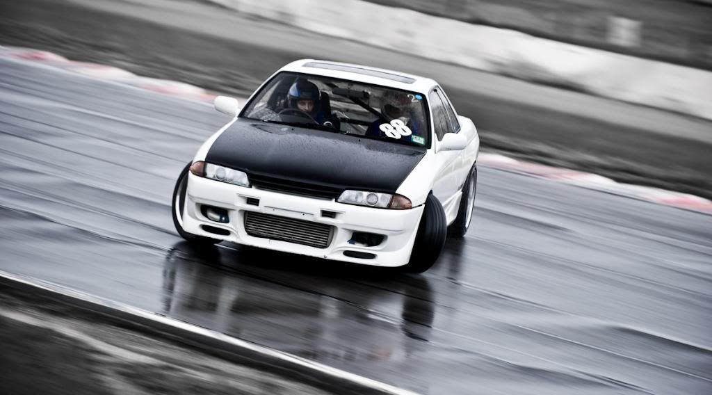

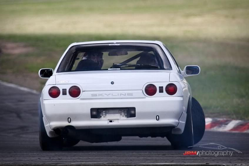

FWIW here's my front end setup.
Camber: -4
Castor: +7
Toe out: 6mm out (total) 3mm each side.
Moddified knuckles. 3 turns from lock to lock.
Offset steering rack spacers.
Ikeya Formula tie rods and tie rod ends.
Cusco castor rods.
Cusco front upper camber arms (5mm shorter)
R33 LCA's with modified lock stops.
Whiteline 22mm S/bar set to soft.
Tein coilovers with dampening towards the softer side.
Pics for reference.
Edited by White GTS-T
