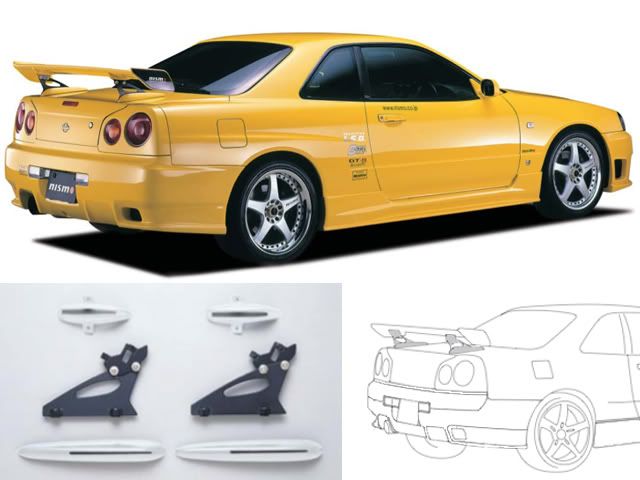

The only way I can think of - off-hand - to raise it would be to use the nismo wing stays, which were designed for the coupe wing. Not sure if they'd fit the sedan wing. This would be a pretty expensive option, and would also require painting:
Nismo wing stays are heaps expensive. I was lucky to find a set for $100 posted lol.
I used the stays without the bottoms bits, looks pretty good.
