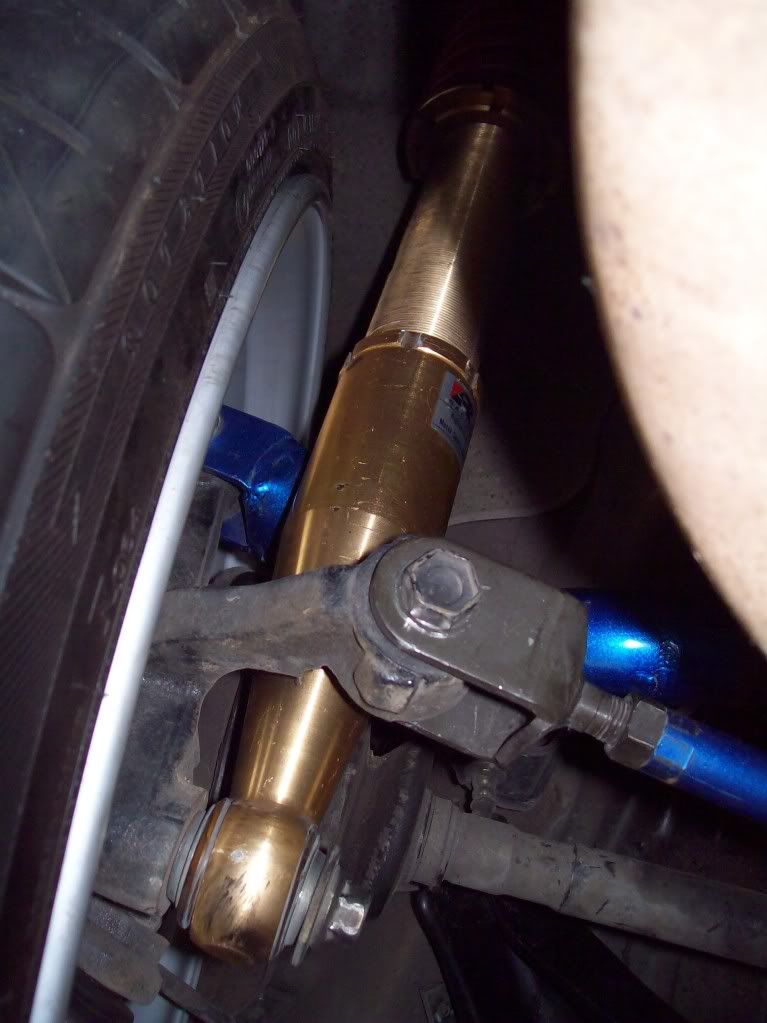

Just one more post to show the final result and the original "janky" solution for a laugh. Everything feels really tight and no wobbling at all, very pleased 🙂
After drying a few days, time to put her back together
