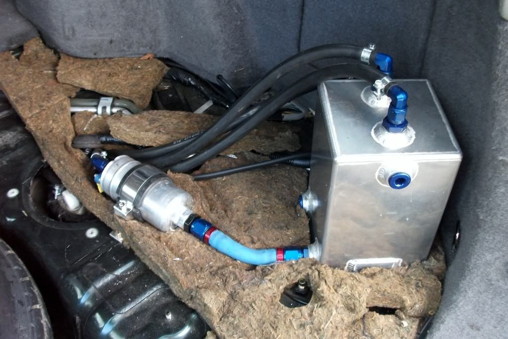

Along with the pipe work getting modified, the Stagea will have a surge tank installed on the undercarriage along with a Bosch 044 fuel pump. I have experienced fuel surge in the wagon quite a few times (even on the skidpan). So before I go hard out I figured now is the best time to rectify the problem before something goes ka-boom! It’ll also mean more track time as it’ll save me from filling up every so often.

The surge tank has been installed under the driver’s side back seat. Anth modded a Aeroflow fuel pump bracket so the Bosch 044 was sitting in an ideal spot.
Under car is great, you can barely hear the constant buzz from the pump in the cabin, you don’t get that fuel smell and if the 5-0 are on the hunt for defects, it’s going to be difficult to see.
