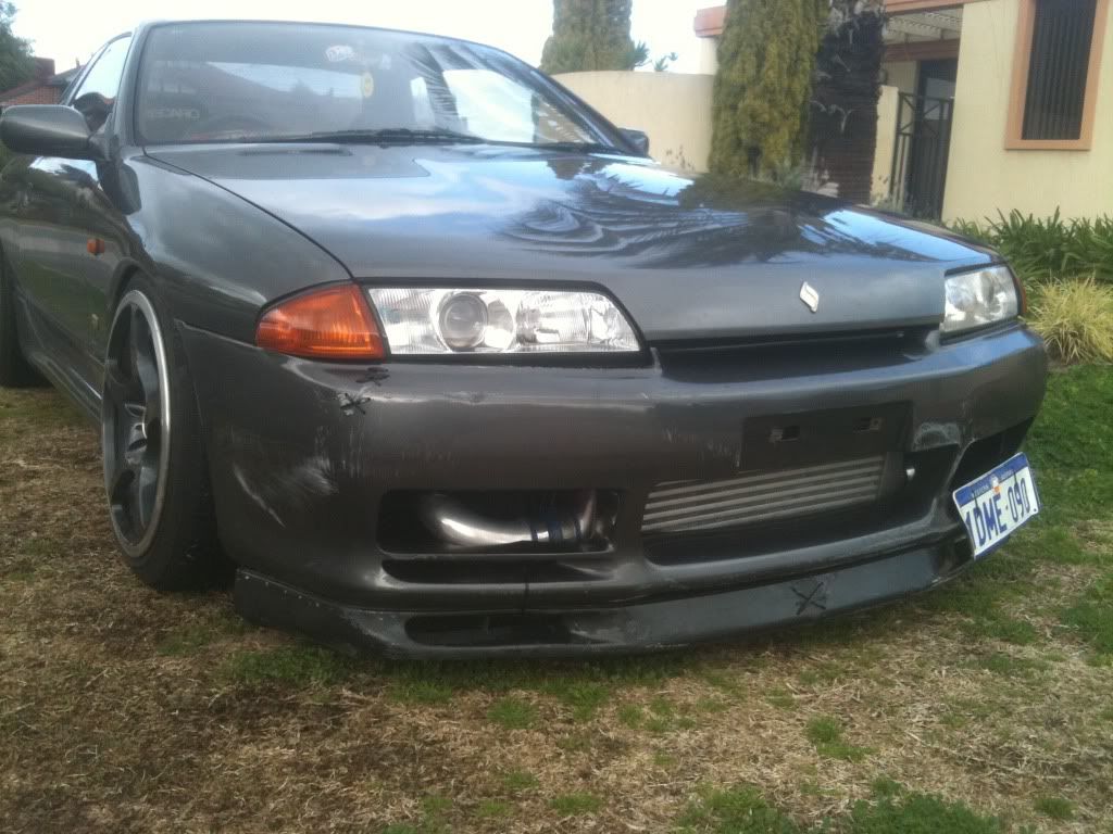

Tried to negotiate a friends driveway.
Snapped my front bar clean off :(
And then my number plate fell off too because it snapped out one of the mounting nuts
