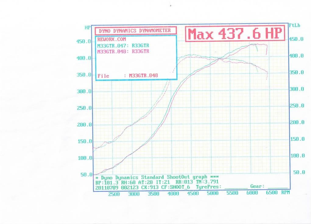

Just to give a brief run down my previous tune 2 weeks ago resulted in 370 rwhp(440 flywheel power) on the stock MAF's. I then swapped on some Q45 MAF's and got the map back to the same results all barr a little running issue that was it sometimes stalled when lifting off from high rpm and putting it in neutral. There is a thread about that here: http://www.skylinesaustralia.com/forums/topic/369343-q45-maf-pointer/page__p__5891148__fromsearch__1#entry5891148
So this weekend we proceeded as follows. The tuner leaned out the map a bit at the top end and altered some of the MAF settings to try and cure the stalling issue. It is better but not perfect for sure. I also found out my Stock oil breather system setup was leaking through both one way valves! So even though it's a closed system I expect that won't be helping anything, especially when it's on boost!

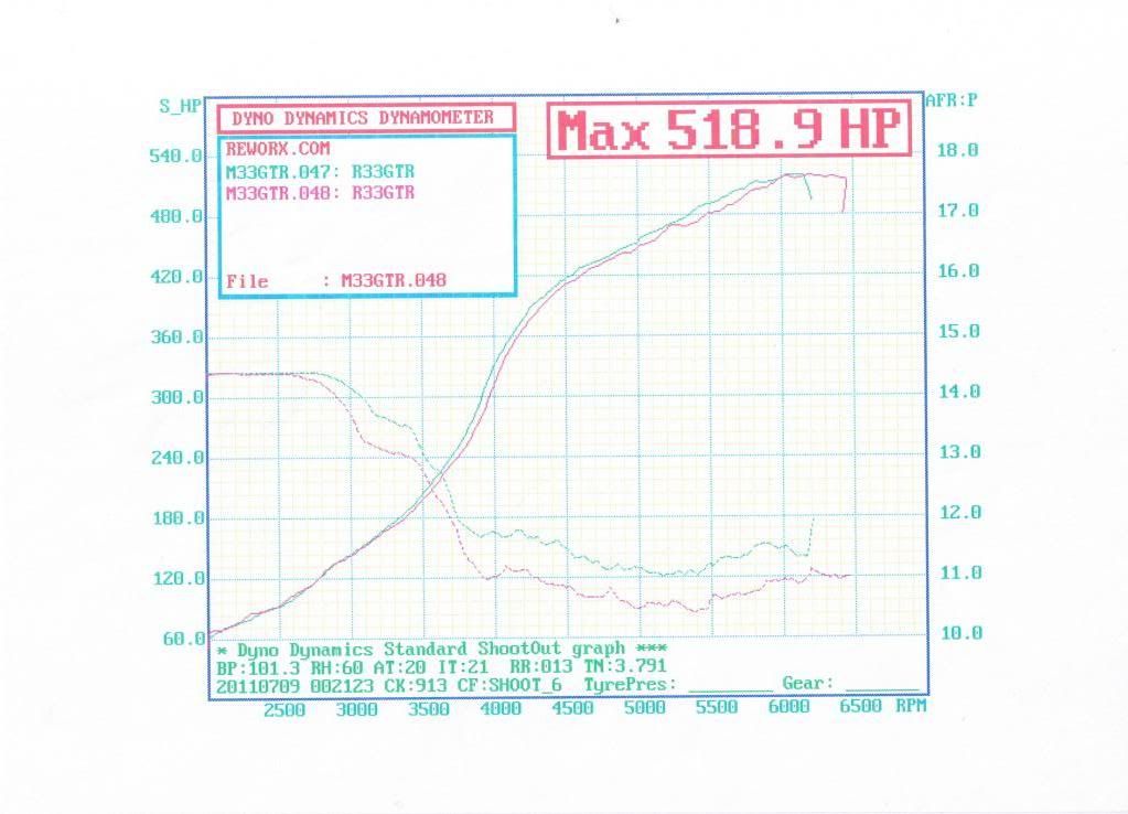

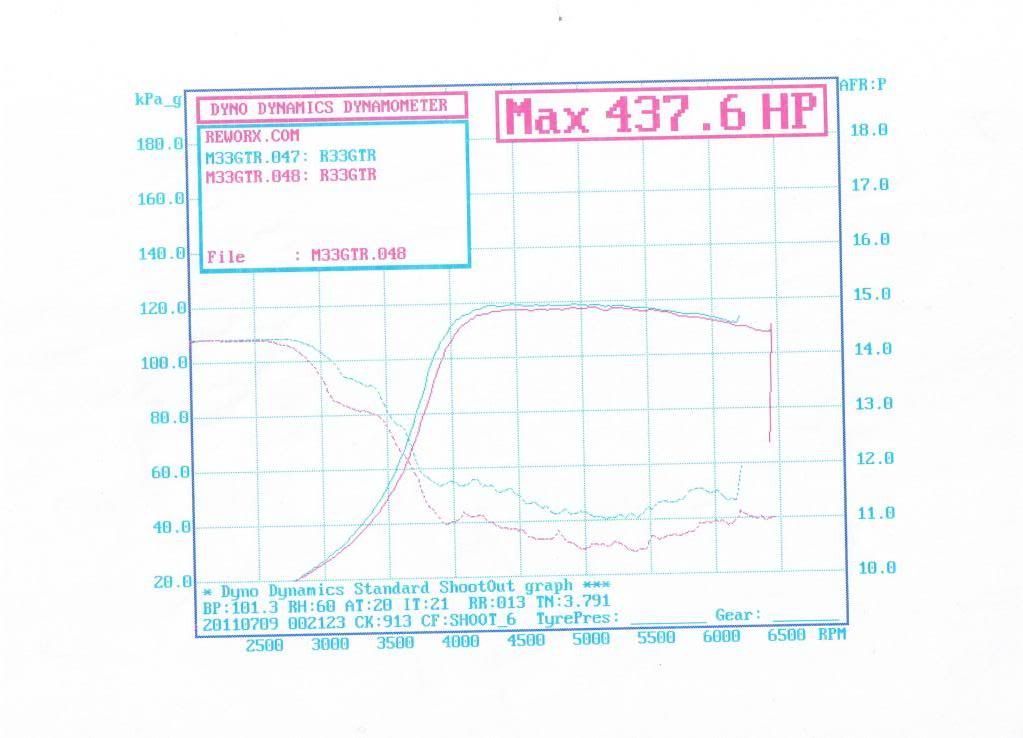

Anyway, we stepped up the boost to 1.0bar and then 1.1bar and finally 1.2bar and the results are as follows:
So just under 440bhp at the rear wheels and that was 6500rpm. (dyno rpm scale is out a bit) We opened up the rev limit a touch and you can see it starts to fall off the power after around 6600 anyway. Also the boost starts tailing back off to 1.1bar at the top end? It held 1.0 bar fine and 1.1 pretty well.. bt 1.2 it's struggling. maybe boost controller setup or the 10psi wastegate spring is not man enough? But in any case this is where I wanted it to make power as the low down power is what you can really use! I must say I was hoping to hit just over 450bhp to be close on 550bhp flywheel power. Maybe with some tweaks it can get there? This is where I would like some thoughts as to waht might be limiting me? Stock intercooler? Stock Fuel reg? exhaust?
You will see something a bit odd if you take note of the two runs shown...both runs were done one after the other with a minor top end tweak on the fuel map to lean it out but yet the second run the AFR map has jumped down (richer) over a significant portion of the run??? Anyone got any ideas what could cause this? I was wondering fuel pump running in tank bosch type with the Inline in tank pressure regulator still fitted? I have no gauge on it to check pressure at present? But that said I would have thought that would only really effect the very top end and the injector duty would go up which it didn't? Also it makes pretty much the same power?!
Could it be MAF related again, plugs or coils? The leaking one way valves on the breather system? Some ideas on this would help please if anyone has a thought! I am running the stock FPR for info. But was told ages ago that should be fine for what I am aiming at?
Boost wise I am going to check the settings on my boost controller and also put a bit of pre-tension on the wastegate spring to try and hold it better up top.
Anyway.. Let me know your general thoughts! I am happy but not ecstatic!

Given the boost level and rpm cap, the results look pretty good to me. Quite strong mid range stick.
What is your exhaust manifold setup like, and how quiet/restrictive is the exhaust system? Be worth looking at them after checking your wastegate and boost controller. My guess is that if you get it to hold boost and run it to 7000 you'll hit the target.
More boost! Nothing wrong with Holsets but don't know the capacity of yours. With a GT35/40 you could expect 375kw at 1.5 bar. Have you got a 3in exhaust or better? Need a better fmic? You need to measure fuel pressure to see if your system is keeping up. Does it lean out at the top? Pump wired for full voltage? Are you using a PFC?
My guess is you need more boost but I don't know how big your turbo is... and get a higher value spring for your wastegate.

As you can see from the AFR's on the print out the car is no going too lean.. Still that is not to say the pump is struggling on one run and then keep up on the next giving extra line pressure? Not sure if that would account for the changes?

Does anyone else think it's a bit laggy for a 3ltr ^ 1.2bar/370rwkw? A GT35 would be doing similar and coming on much sooner.
Especially with a 4000-6500rpm power band :/
Exhaust might be an issue. Fuel reg isnt an issue, cooler isnt an issue.
Boost drop will be wastegate related. If you wanna run 18psi - then get the spring combo closer to target boost and that problem will fix itself up much easier. Otherwise the EBC will never hold having to bleed that much off, you'll always get gate creep.
Sorry didn't read down as far as the 500+ hp. Power's not too bad at all but still if you want more try 1.5 bar.

So Just to clarify as I think maybe some people have read the wrong graphs or lines of text.. At the mo I am at 437rwhp at around 6500rpm and 1.1bar (I say 1.1bar because it is not holding 1.2 yet! max torque at the wheels is 410ftlbs at 4500rpm ish. The 518bhp figure is estimate flywheel.. which I guess in turn gives around 460ftlbs at the flywheel?

So, guy's I am really keen to get some thoughts on the reason the AFR's changed from one run to another like that with only a top end lean adjustment resulting in a richer map. It seemed to possibly get richer when doing runs in quick succession.. so maybe heat somewhere? air intake temps? I noticed on the road today cruising at around 50mph the intake temp is hitting around 40-42 degs? with a some speed up it drops to the high 30's.. Not sure if that is an issue.. undoubtedly it was probably hotter on the dyno with lack of air circulation. O2 sensors? I did wonder whether the pump was struggling and keeping up one run then not so well the next but as I said the injector duty seemed to be unaffected which I would have expected if the pump was an issue? The only other thing is line pressure if the in tank relief valve or what ever it is is causing a problem? I am also changing the filter just in case.
Boost wise I will pre-load the spring and sort that out. I wanted to run a low setting or 0.8 bar really but I guess I can go up a bit on that and take the spring load as close to that as possible

The 2 runs going richer could very well be an air intake correction or a water temp correction richening the mixture.

I missed some points to reply to earlier.. Water temp and oil temp wise I know there is no problem! That is actually the first thing my tuner asked.. is the oil cooler getting hot? It was perfectly fine and the water temp and oil temp struggle to reach 80degs!
However air temp is a different story. I did not think to check that at the time and I am not sure if my tuner did. Just checking the Power FC settings you start getting air temp correction after 40degs. I know from driving my car yesterday and checking that is reaches 40-42deg in generally slow moving traffic so stuck on a dyno with limited airflow I guess it is a strong possibility it would go higher? I reckon it would only need 50degs to get the sort of correction I am seeing on the printout. And the fact it seems over the entire map kind of fits? but then that said .. Will the correction change the exhaust gas AFR like this as I would assume the correction is to try and keep the burn the same and prevent knock? warm air gives less effective combustion right? So actually if you add fuel to make it safer??! then you would get richer exhaust readings for sure?! Have I got that about right? Not sure how the more fuel for less burn works though?
What you all think.. have I maybe cracked it!? Wonder if I can get a logged max air temp from those dyno runs to check?

Dynos are great for quickly seeing the results of changes you are making but there is a good case for fine tuning your tune on the road if your tuner has the gear and the inclination. Those who have done it say that real life road testing can give results different from those on the dyno. If that's not possible and you have datalogging capability at least you could do some comparisons with the results you are getting on the dyno. I would guess most dyno cells would get pretty warm.
IMO don't mess with preload. Get the wastegate spring as close to the boost you want to run and tweak the boost response with the EBC. I stuffed around for a long time, it just doesn't work if your making decent power. I don't think of EBC's as a way to control final boost but more so a way to improve boost response.
Lean out the AFR's to high 11's - 12:1 flat and get that boost up to 18-20psi.

HX turbo's are best at higher boost levels. Get that wastegate spring sorted and providing seat pressure is fine you'll find it will make good power if the tuner has half an idea.
Cheers Cubes.. I know ideally Holsets for more efficiently at higher boost. but this is my first build with all stock internals so I don't want to push my luck! The HKS Step1 cams I think are 9.1mm lift off the top of my head. not sure on the other specs.
Do I really need a spring?! Why does pre-load not work? If I want to run 11-12psi low boost I don't think the spring is more than a few psi off? I will check though.
I want it so hold good solid 18psi though.. maybe 19 for the most!
AFR wise we were aiming for the mid 11's as it happens.. Just the sudden change messed us up at the end of the day and then we ran out of time. Hopefully I have the answer to that but wont know until I go to the dyno again now! If air temp correction is not the answer then it will be a wasted trip!
