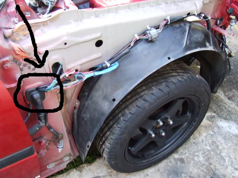

So I noticed the other day the loom that runs in the drivers side guard is gettin chewed out by the tire. I was thinkin about repairing it and putting a plate over it but then thought maybe I'd be better off relocating it.
Has anyone done this and if so how hard is it and where/how do I run the loom??
Cheers
I think they usually tuck it up over the outside of the inner guard if that makes sense
sorta like this, (excuse the huge size and ignore the arrown and circled section its just a googled image to give you the kist of where to relocate it :P )

try some of that tyre in a can stuff , i forget what it's called but it's used to pump blown tyres up instead of having a spare wheel , a friend of mine did this to his symmons and they are still fine today (3 or 4 years ago) and he goes through back tyres quite often... i got my club s lip from streeter , it was expensive to bring over but imo was worth it :P . As for the wiring , they tuck up fairly easily once you take the guard off , but make sure you use something decent to hold it up :)
Tire in a can? I'll have a sus of that. Yeah I'm still having issues finding a club s lip. Thinkin about makin a 32 gtr lip to fit.
And ya gonna sus the loom out on the weekend.
