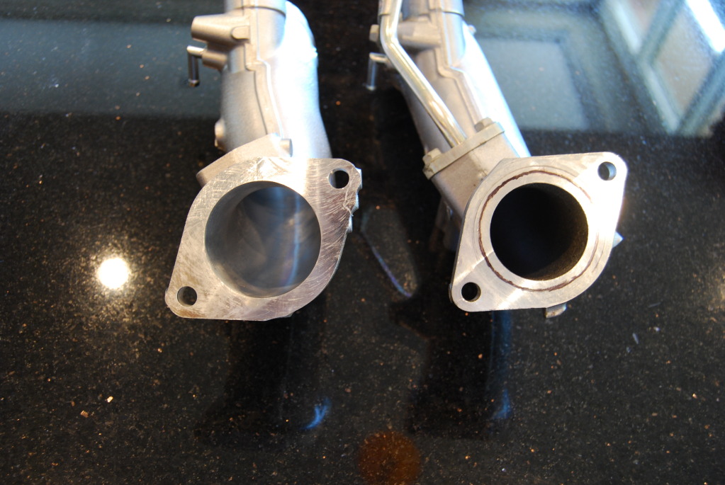

Have an intercooler, intercooler pipe kit and MAF sensor coming from AMS and will upgrade the intake pipes to 2012 OEM and see if we can't increase the boost some more.
Yeah sorry - caught up in reading too many US forum posts on the matter.
ADM 2011 turbo intake pipes / US 2012.
FWIW they were around $600 for a pair from Nissan Oz. Much cheaper than the HKS ones!
I've also ordered a HKS DCT Cooler. Keen to see how good that works.
I guess for those that don't read the US stuff - this is the difference between the 08-10 pipes and the 11+ pipes. The black line on the old pipes is the turbo flange diameter.
You really have to wonder if this was deliberate by Nissan as an easy power gain
I got mine from Fontana Nissan for $370us. Bugger Nissan Australia, they are a rip off. I am going to fit them Thursday. Wish me luck. When you said 2012 I thought "Oh crap are the new ones even bigger"
+1 on the inlet pipes
ive been quite vocal on here and nagtroc on how nissan has deliberately choked the turbo with the pipe diameter to ensure future marketing new model ops
i ordered the inlets together with my intake and couldn't understand back then why the yanks were creaming themselves over 3" maf intake tubes when it necks down to under 2" at the inlet anyway - seems they've now caught on
B the aftermarket inlets from HKS and Top Secret are a few mm larger than the 2011 oem :thumbsup:
