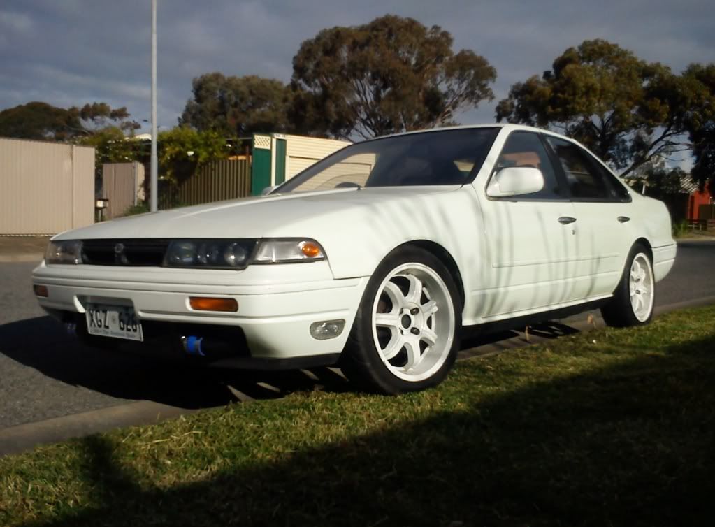

Hey Fellaz,
Bought this A31 ceffy as a project for myself. It's fitted with a RB20DET and had a manual conversion already.
The car is relatively stock, just the usual mods.. Cooler(painted black), exhaust- 3" Cat back to a JUN BL muff and a pod filter. Also has Coilovers at each corner and 17" rims wearing 215/40 rubber. The previous owner said the gearbox had been rebuilt at some stage, it does feel nice and tight. It also has upgraded clutch i think because its pretty heavy under foot, not sure what type though.
Got the ceffy cheap because it was abit rough around the edge's, but nothing to bad. Interior needed some TLC and is missing a few bits, like the drivers door trim, a/c surround, passenger side vent surround and the ecu isn't mounted at all and lies on the floor so the kick panel needs to be fitted once its re-mounted. The worse thing would be the 'home' spray job, which doesnt really bother me because im a 4th year apprentice spray painter and intend on spraying it soon. The body itself is pretty straight with very minimal rust, but there is runs allll over it! lol... Looks good in photos but is bad in person when looking at the bad areas..
Another fault with the car is the wipers, rev tacho and temp gauge all dont work... Which after abit of research im lead to believe its from the RB conversion. The engine itself is out of an R32 and apparently the plugs dont line up in the loom. Me and a mate from work tried to have a fiddle with it but had no luck :( Since then ive been pointed in the direction of a fella off ns.com that i've spoke to and he's coming next week to sort it for me. :)
Apart from that i've just been trying to bring it back up to a nice standard with lttle bits here and there. So far i've bought brand new 'Monroe' bonnet struts thru CBC, $105 for the pair and they work awesome. Car ran abit rough when i got it home and noticed the coil loom had a massive cut in it (wtf), so i bought an RB25DE one and replaced it and now runs sweet. also did the spark plugs while it was apart. Rear drivers side window's regulator was buggered and the window was stuck down and after relising it was gonna be pretty hard to find a good working one, i bit the bullet and went to u-pull-it and got another f**ked one for $25 and peiced the 2 buggered items together using parts from both. Got a mate to help me and it tooks us ages, but after alot of swearing and sweating we got it done and now the window works sweeeet. Yesterday i got a mount on the exhaust that wasnt even bolted on or near mount holes for that matter, re'done. The bloke at Carline did it for $30 and now thats sweet. I love the look of roof spoilers on ceffy's so when one popped up for sale i had to grab it! it's to be fitted on the car once it gets painted.. Whats the best gear to use to make sure that sucker holds onto my rear window?? I've heard sikaflex is good? Any thoughts??
Next on my list is to do the gearbox extension housing seal and castor rod bushes, because both are f*#ked a need doing. Brakes are getting done once the electrical issue is sorted. Rotors are coming off to be machined thru a bloke at work and im changing all the pads. Any suggestions on what type to get?? I'm after some that are good for street use. Also im painting the calipers in 2pac red while they're apart. Next will be the wheels, i'm changing them from white to a nice glossy 2pac black. There in pretty bad condition with stains of some sort all over em and a few minor chips and gutter rash. I also just ordered some grey rays wheel nuts to finsh that area off. Should look good when its all back together. Then its time for a dyno tune and she should be running sweet and all ready to be driven more often...
I need to get more photos of it as it is now before i start changin stuff on it so you guys can check the progress and tell me what you think.
Cheers for the read, enjoy.

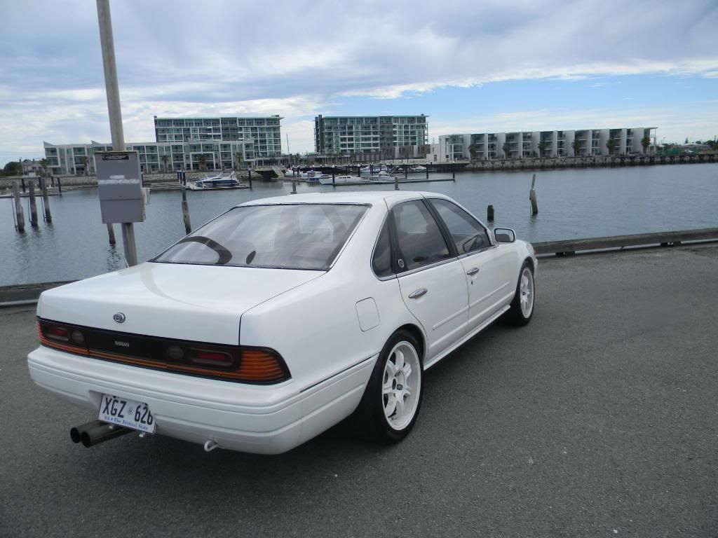

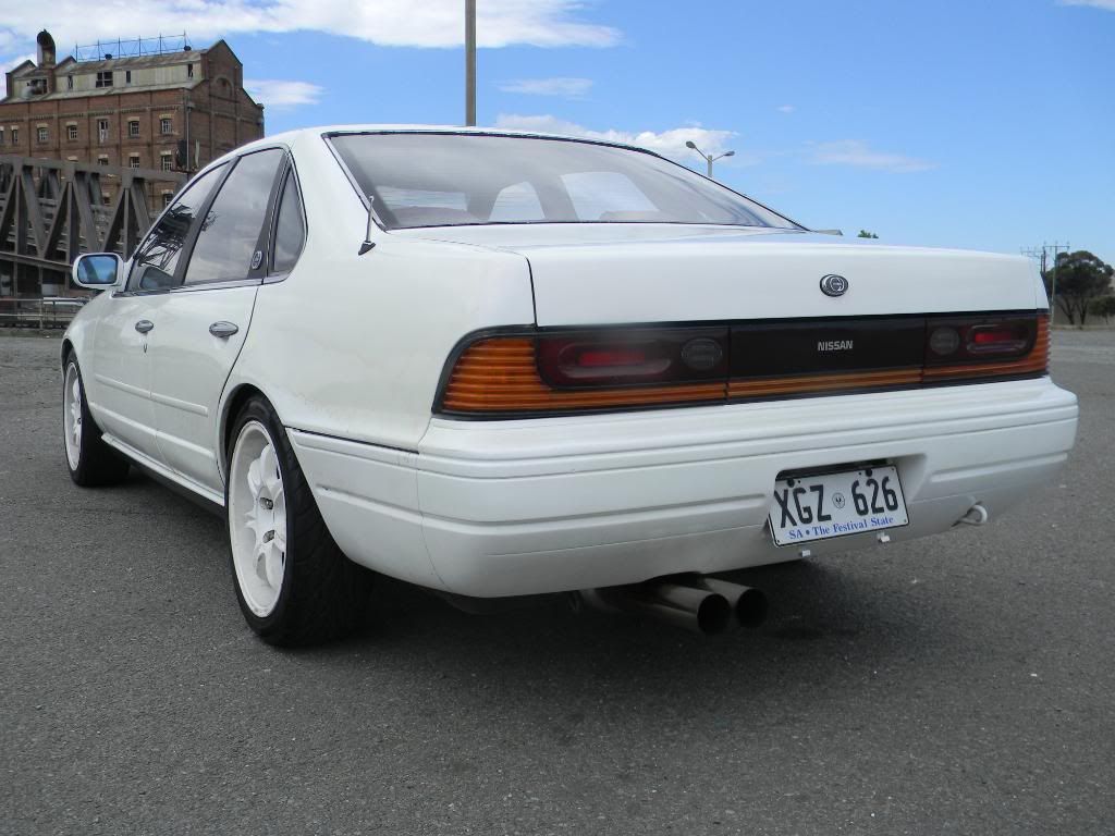

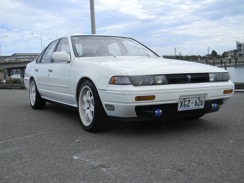

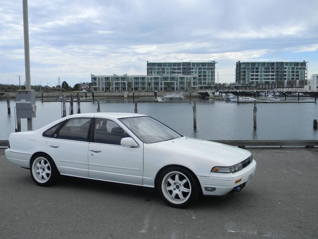

Got some photos today with a proper camera not my phone's camera, lol...

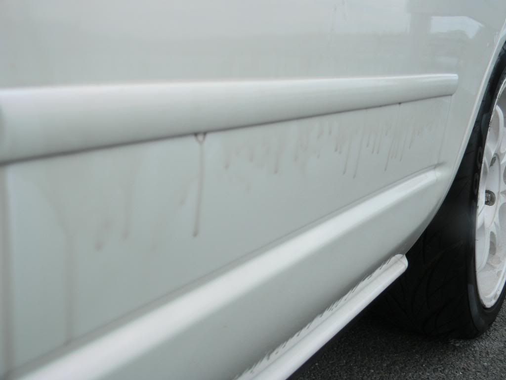

Also thought i'd show you the runs on the paint job, these are the worse of the lot...

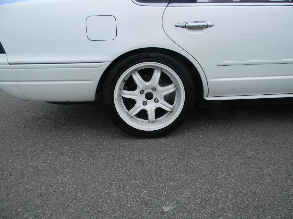

And these are the wheel n brakes before i paint them, which will be happening soon...

Damn they're some big runs , it takes commitment to get them like that!! , simon used to own my ceff , i'm pretty sure he has a soft spot for them :) . Don't bother with a safc , for not that much extra you can have a nistune chip installed to your ecu and tuned properly , safc don't do timing , nistune is arguably comparable to a power fc ;)
Tell me about it, i could grate cheese on them..!! Can't wait to show the boys at work!!
