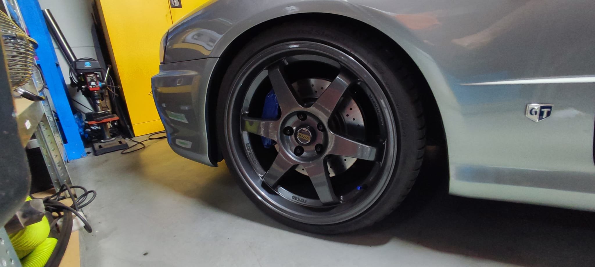

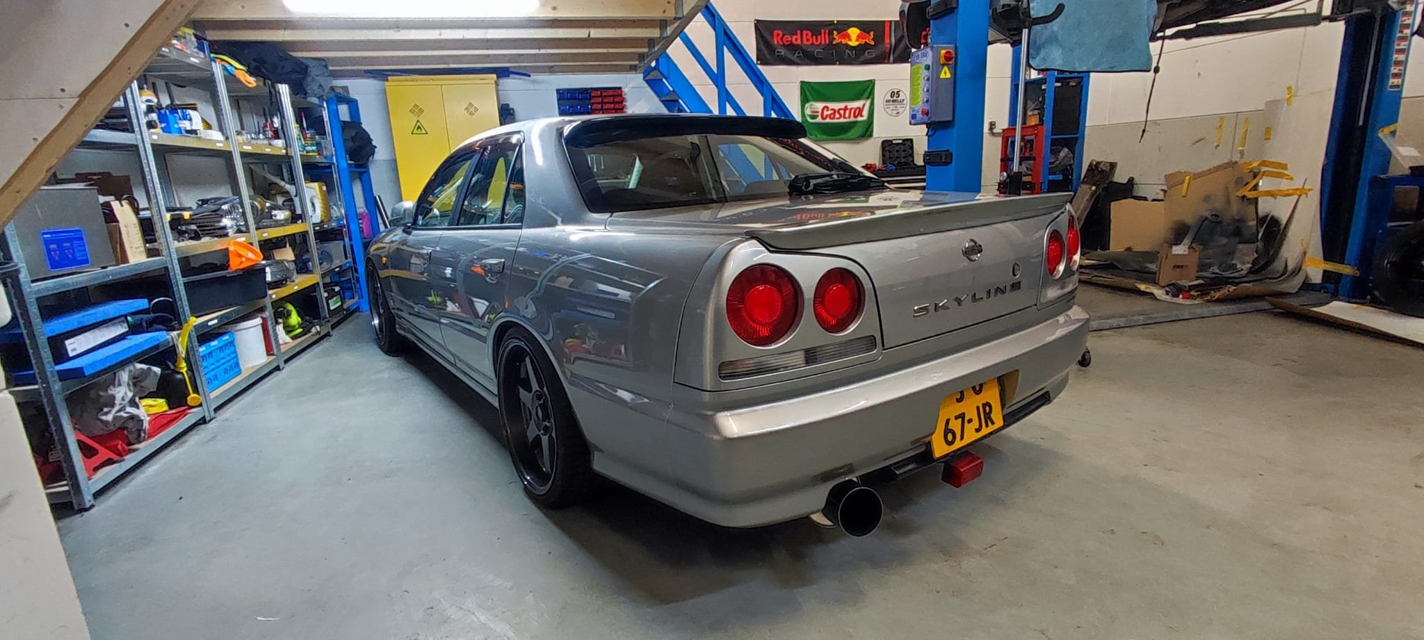

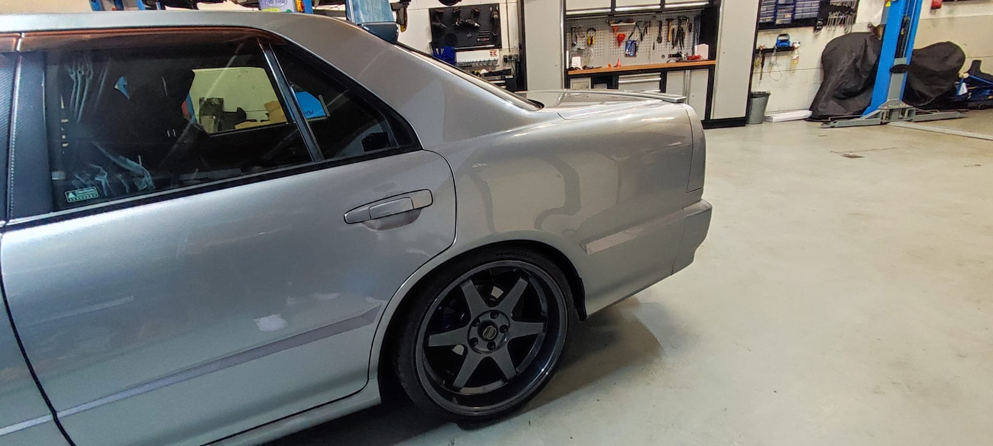

Being the top Google search result for R34 wheel-related inquiries, lemme throw down my experience.
I calculated that 100mm from hub face to wheel face is about the perfect fitment for my ENR34 sedan.
I've been running 18x8.5s, ET35, with a 1" spacer. So, 8.5in to mm = 216mm. 216/2 = 108mm. 108-35 = 73mm. 73+ 25 (1" to mm) = 98mm.
If you wanna get close to this on dif widths, here are the offsets you'll want:
9" - ET around 15mm
9.5" - ET around 20mm
10" - you're crazy, but ET around 30mm
All these should fit perfectly on a non-widebody, non-GTR Skyline. Note that it's probably the absolute max, and you're probably better off running a couple degrees of camber in this config, but it looks great, super flush.
  • Like 1
This is actually a really good way of measuring what wheels fit. If only there was a similar measurement between hub face and suspension :p
