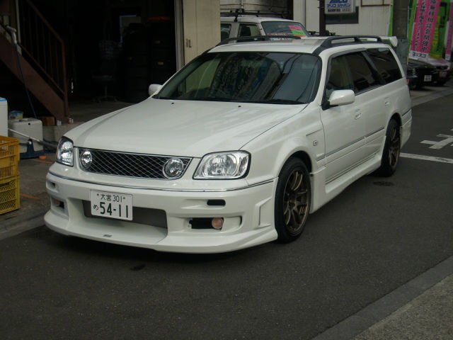

What do you mean by a S1 RS4 - do you mean no turbo? If so you will have even weaker brakes but all the conversion stuff will be the same.
I used an R34 clutch pedal I think but without the power booster so no recessing.
Because of the Greddy copy FF plenum I had to use a stock R33 clutch master as the 33GTR or 34 one (I can't remember) was too long. That may or may not be the case with the RB26DETT plenum.
Your brake booster will be fine (check that you have a BM50 brake m/c). I used the stock set up when I changed to GTT brakes (good idea for you) but left the booster but changed the brake m/c to an R34GTR one (BM57) when I fitted the D2s
S1 = Series 1.
Rather than a Series Two:
haha yer i know what s1 is mine is the first pic.
i not say that some 1 said that a s2 clutch pedal is no good no 1 say or not if it will fit easy.
was told to get a 34 gtt pedal and master cylinder. i was asking about the s2 as i have 1 lined up to buy and not want to get the wrong 1 that's all
I would assume that the S2 clutch pedal would fit perfectly. The reason everyone says R34 pedal is because Stagea clutch pedals S1 or S2 (I would expect they would be exactly the same ) are very rare and therefore not an easy option for most people.
