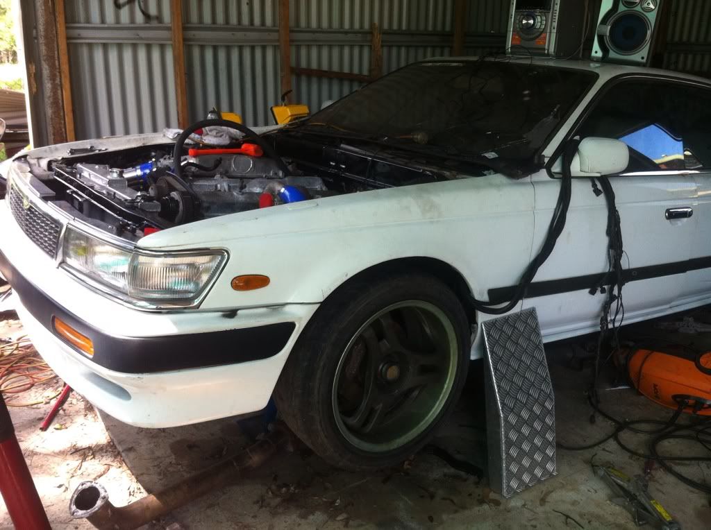

Bit of an update, it's Pretty much ready to be sent off for wiring now.
Brake master/booster and lines all back in ( f**k I hated life getting those nuts back on) lines hooked up, clutch master back in lines ran, nismo braided clutch line in, nismo gearbox mount in, radiator hoses cut to suit and put on, and got some scrap polished staino for an intake pipe, 2.25" no afm if this bitch doesn't dose hard I'll cry haha.
Now just gotta get my nismo low temp thermostat in, hook up my fuel lines, put my painted rocker an cam covers on and should be ready to roll once I get my rims back from work. Painter blasted and primed them, just have to paint them when he has the time, all for a carton of powers gold (eww).
And random bay snap
