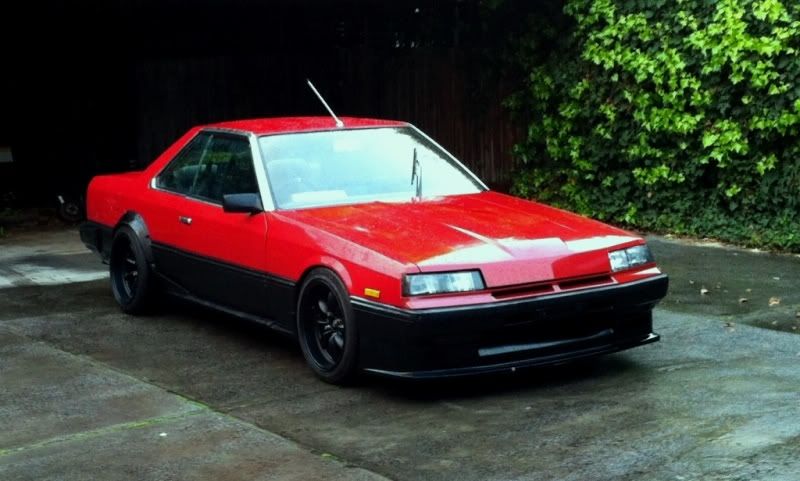

Dan, im going to put 10+kg fronts in mine its about the same as a track s13 would run and withthis new setup i intend to do track days in it,
i didnt get to speak to the flairs guys today but i will do, id say z flairs would fit.
Cheers
arghhhhh!!!!!! what are you doing to me haha they are sick!! but there to big i think?? also i really would love more dish 10-10.5, 11??
im really feeling 16s to be honest but maybe your right??? i really want to nail that image top of this thread though i think 16s look like the go to me.
rotas would save alot of money! (lets not make this into a debate about there quality please!!!) in particular if the fitment is not right it does not cost me 2500!!

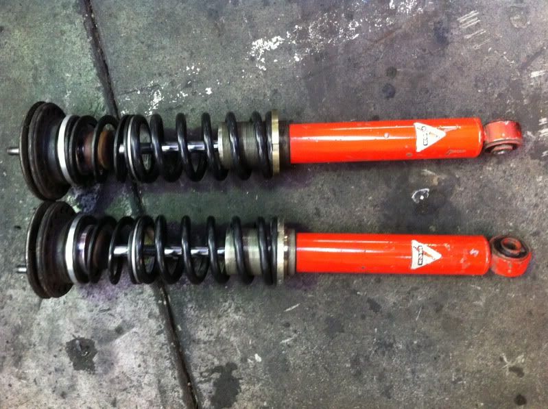

also i made these tonight
Koni adjustable's with 8kg springs
on to the front next im using the the originals and putting in koni Z31 inserts which makes them 45mm ish shorter

Dude only 15 Watanabes if you want a legit look like the model.
Offset calculator-
http://www.1010tires.com/wheeloffsetcalculator.asp
If that fails, Ben from Otomoto Has owned a DR in the past and currently owns another. If he doesn't know approx specs you would need he may be able to ask someone.
Also keen to see how you navigate cutting the guards as I need to do mine too (harder for me as flairs are already attached).
Edited by D-limo
I have emailed Ben, no response as yet..
I have also been attempting to overlay images over the image of that toy and they really seem bigger than 15"(hence why I'm thinking 16 ATM, if you look at the wheel space at the front in particular and compare that to a car with 15s the wheel on the toy fills it better with a smaller profile tire don't you think?
As for guard cutting! That still gives me nightmares haha, I'll likely get the panel shop next door do it..
