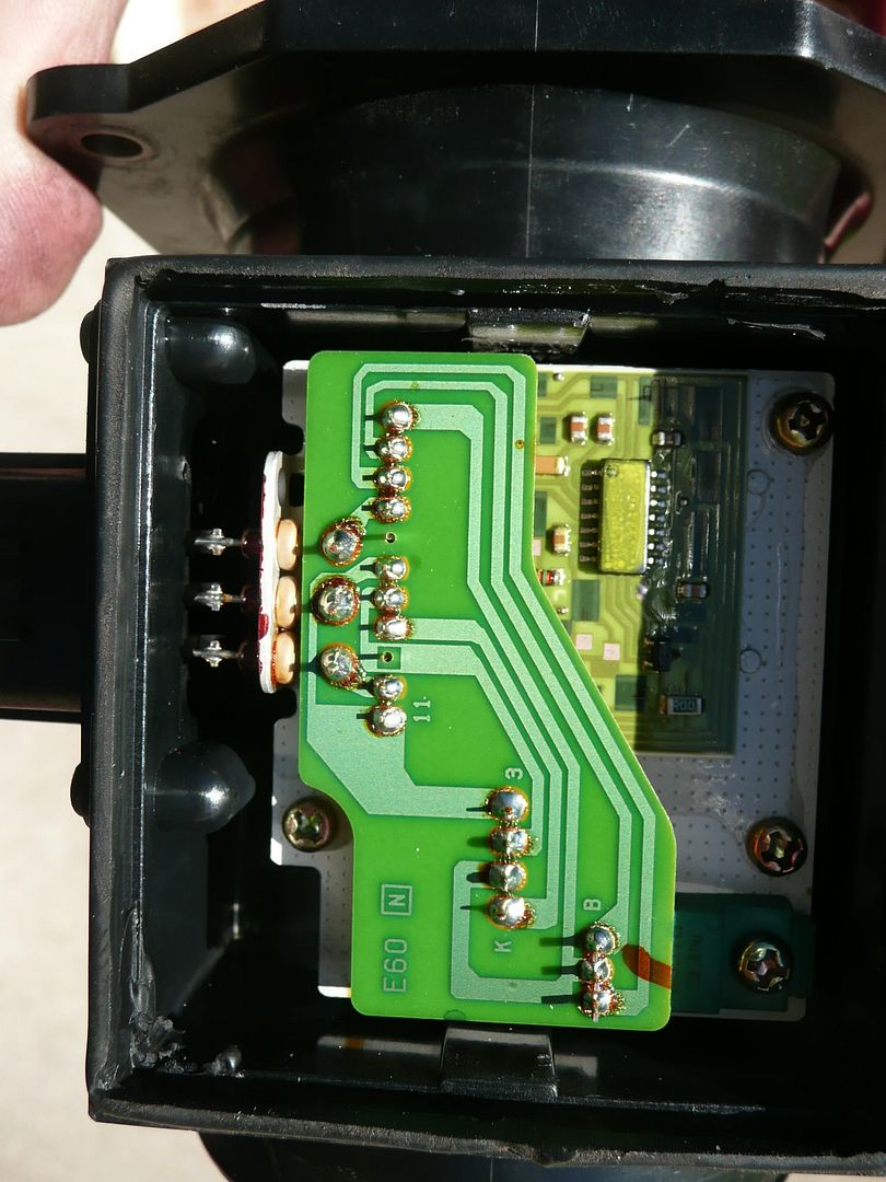

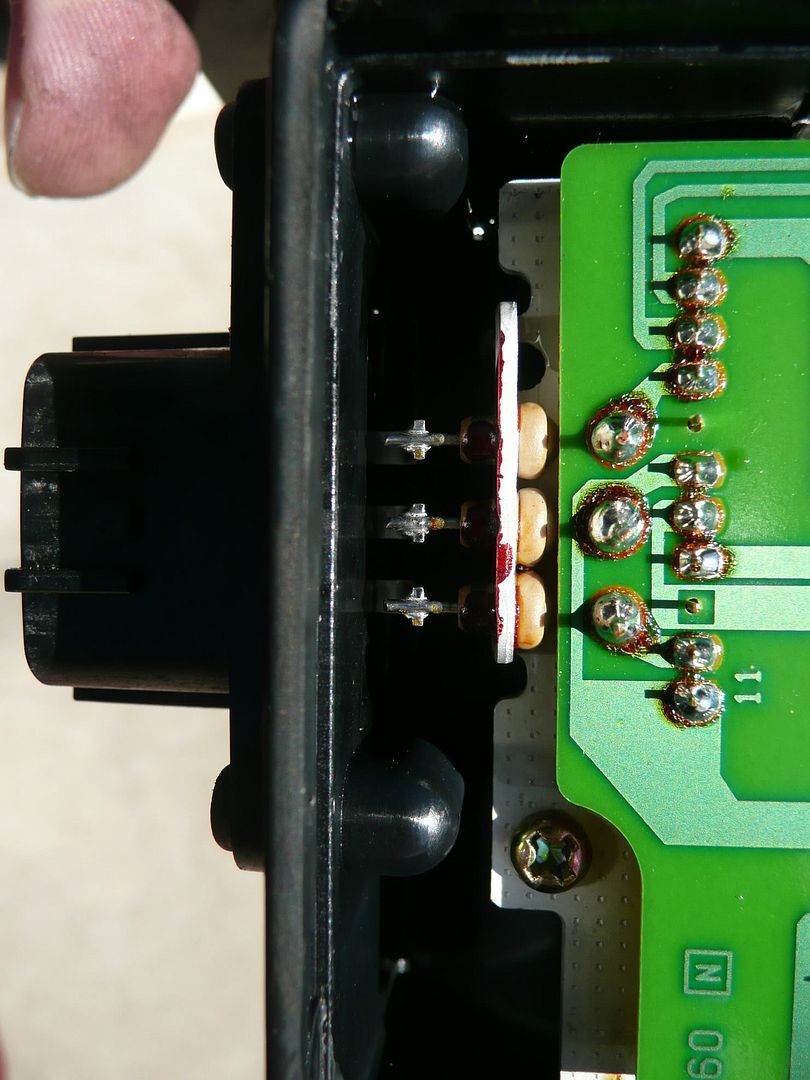

Sinesweep Posted March 18, 2012 Author Share Posted March 18, 2012 (edited) Yeah I did. Just did it again (cap is only on with friction fit old silicon) , and hit up the PCBs and AFM element thingy with some contact cleaner. Noticed some discoloration that looks like minor corrosion, or solder resist, or something. I cant access a test AFM, but Im South of Adelaide if anyone has any names of places I could get one, or more advice. Dunno whether to mess with the Auxiliary Air Control or Throttle position sensor. Also turned the bleed valve down 2 more clicks whatever that equates to. photos below http://i127.photobuc...et/P1000682.jpg http://i127.photobuc...et/P1000681.jpg http://i127.photobuc...et/P1000683.jpg Edited March 18, 2012 by Sinesweep Link to comment https://www.sau.com.au/forums/topic/394023-r33-gtst-cutting-out-intermittently/page/2/#findComment-6278834 Share on other sites More sharing options...

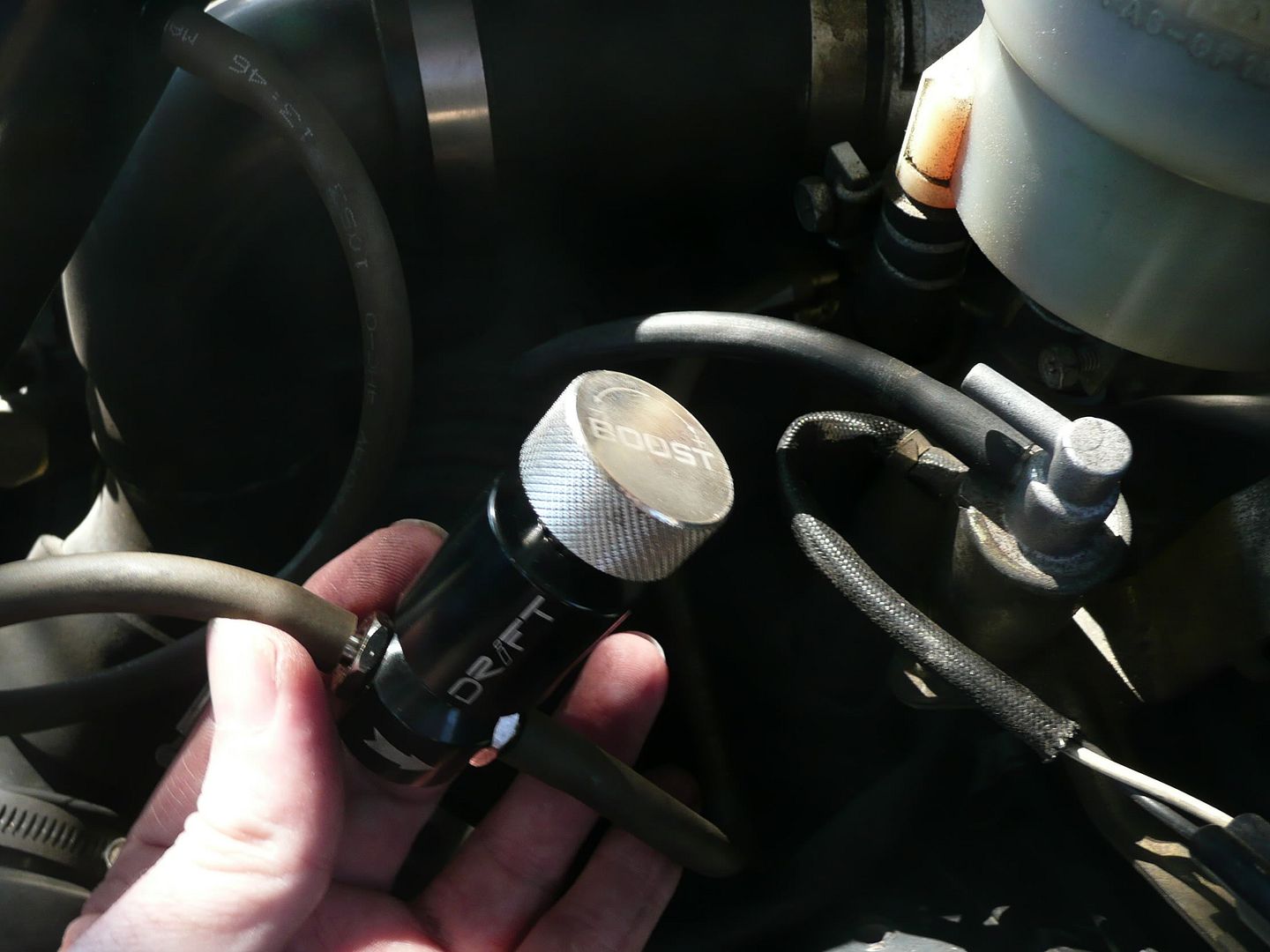

Sinesweep Posted June 5, 2014 Author Share Posted June 5, 2014 I ended up cleaning the AAC as well as rewetting all the AFM solder joints and the old girl came good. I'm not sure which (if either) fixed it, but my money is on the AFM dry joints. Have also since taken out the Boost Tee. AAC cleaning here - http://www.skylinesaustralia.com/forums/topic/110431-diy-aac-valve-cleaning-idle-reset/?hl=%20aac%20%20clean. Link to comment https://www.sau.com.au/forums/topic/394023-r33-gtst-cutting-out-intermittently/page/2/#findComment-7304092 Share on other sites More sharing options...
ads47 Posted June 7, 2014 Share Posted June 7, 2014 (edited) Thanks for the help Sinesweep, I took apart my afm and found that all the solder joints had broken off. A quick resolder & put it back together, then took it test drive. Drove like there was never a problem, thanks heaps mate. Edited June 7, 2014 by ads47 Link to comment https://www.sau.com.au/forums/topic/394023-r33-gtst-cutting-out-intermittently/page/2/#findComment-7305367 Share on other sites More sharing options...
