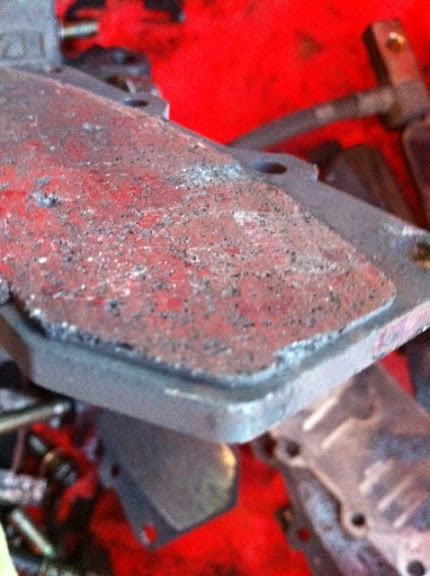

I really should have have done my research, instead I took advice from a "professional" and used a pad that was not up to the task.
The result is pads that look like this after one day. ( brand new the day before )
Fronts and rears
The rears chewed the discs and melted the seals on the callipers
On the bright side, the rear callipers have been upgraded to match the front. I have also learned a lot about brakes.
Yes I feel like a Muppet and blame myself for the poor choice. ( as much as I'd like to point the finger ) Live and learn.

Wow Ryan that's too bad. Unfortunately the heavier the car the harder they are on your brakes. But I can confirm that you'll get at least 1/2 dozen track days on a set of proper racing pads, but of course it will wear rotors more than normal street use.
Glad that the pads didn't glaze on you cause brake fade is a weird experience the first time it happens.
Oh, and don't believe the marketing ratings on pads. There's a lot of hype about 600 or 800c rated pads that won't really hold up. Just check in here with the experienced guys and they'll steer you right. Although there aren't many that have done hard track work in a Stag - Duncan looking your way.
