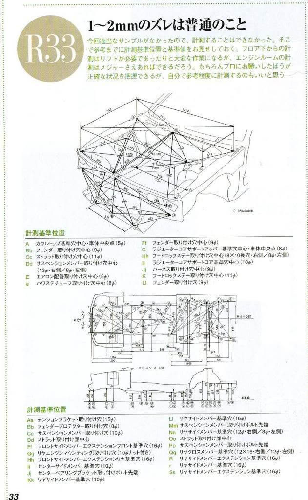

As the topic says. I'm after the workshop body alignment part of the Manual for an R33. The section with the co-ordinates of hole's, bolts and suspension pins.
The Workshop Manual's I keep finding (regardless of their huge size) lack that section and only have the electrics and motor sections.
I need it to work out the correct geometry of the rear suspension.
Any assistance would be greatly appreciated. Thanks :)

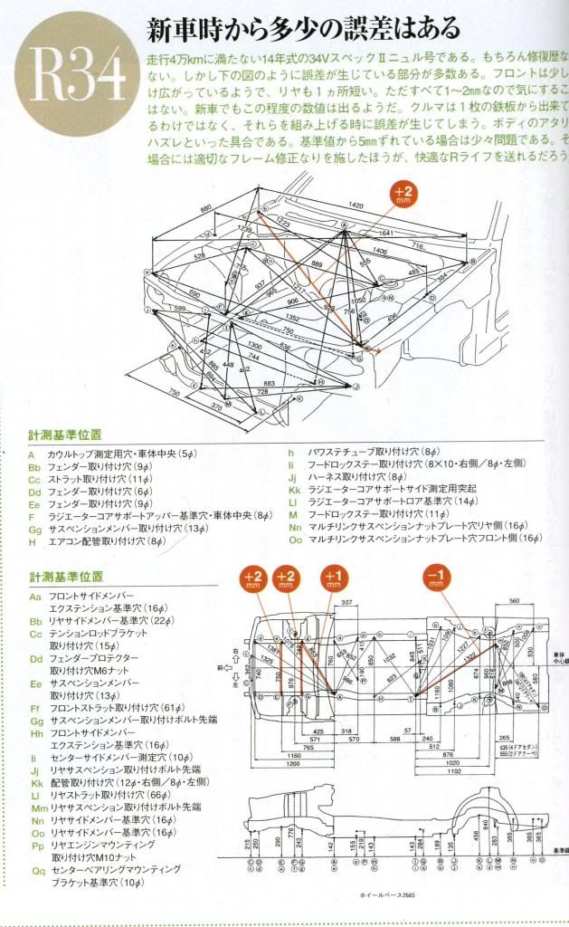

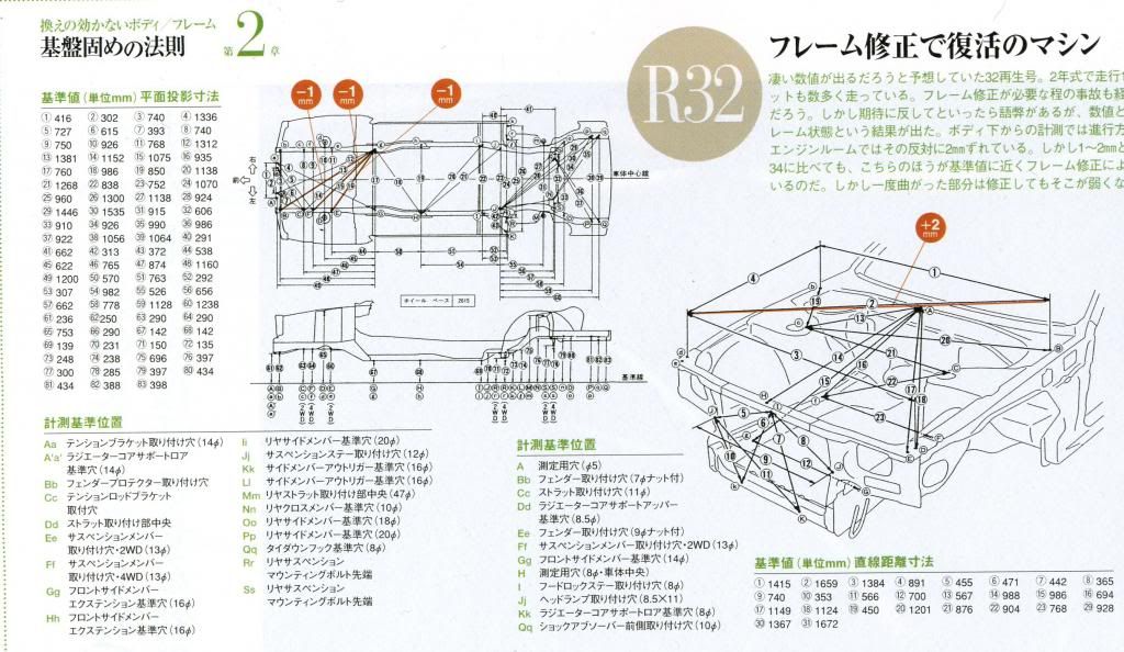

After A - LOT of Effing around!!!
http://i75.photobucket.com/albums/i305/gadget1382/VQ30det/Nissan%20Skyline%20Chassis%20Dimensions/R32dim_zpsde26471b.jpg
http://i75.photobucket.com/albums/i305/gadget1382/VQ30det/Nissan%20Skyline%20Chassis%20Dimensions/R33dim_zps07534267.jpg
http://i75.photobucket.com/albums/i305/gadget1382/VQ30det/Nissan%20Skyline%20Chassis%20Dimensions/R34dim_zps63991bf9.jpg
Hope this helps people straighten out their cars!
Mod's you may want to pin / save these... as they were a B*tch to get!
Sorry haven't been able to find a non-pixelated R33 version, but you can still read 70% of the dimensions.
