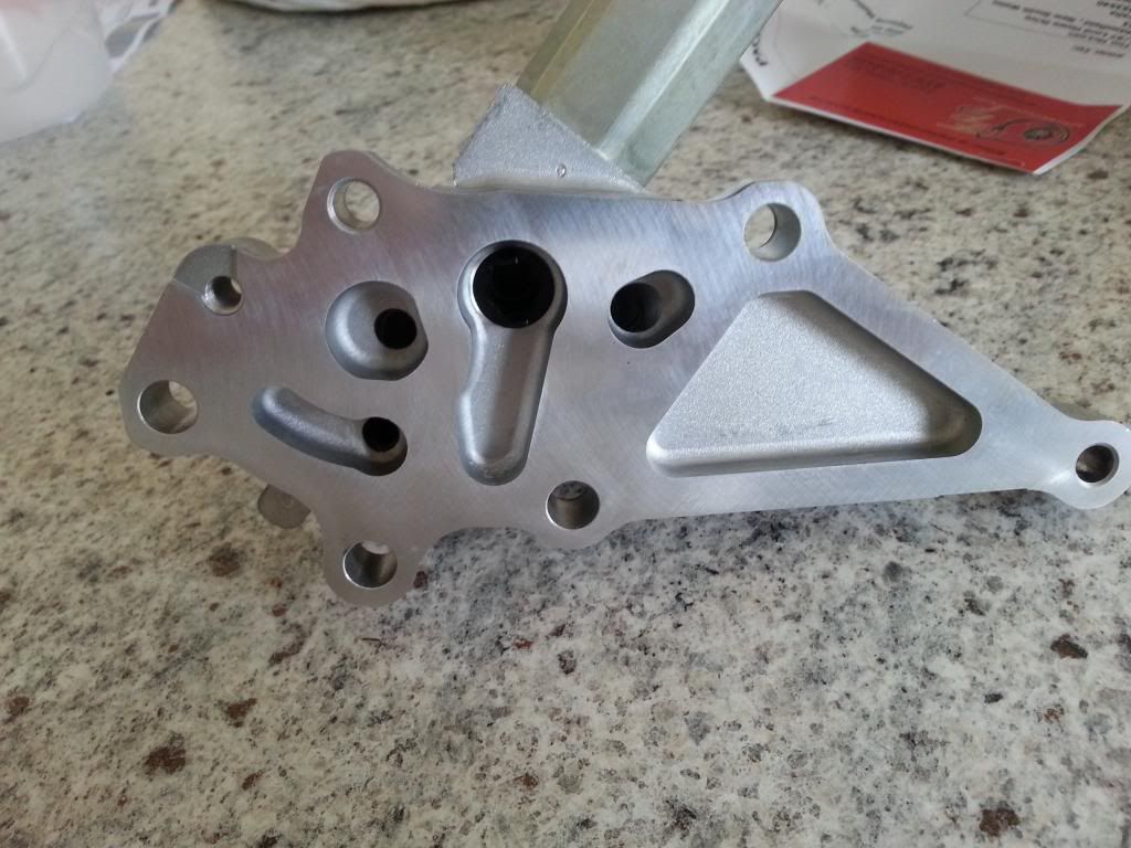

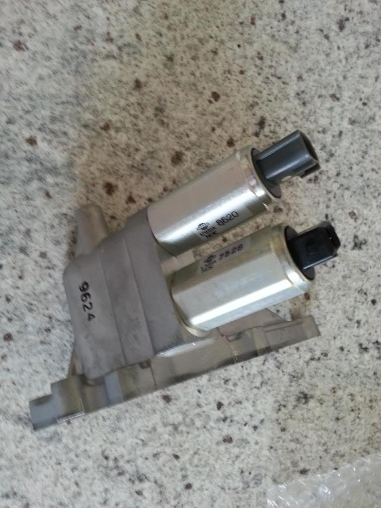

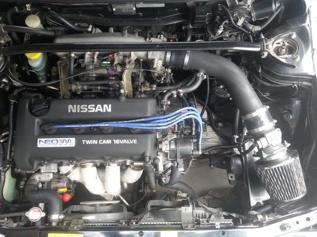

Nah both for VVL Michael. The closest one to the bolting face is for the intake cam, the other is for the exhaust.
I bought new solenoids as mine are playing up a little bit from time to time. So time to eliminate the problem..
Also it's always good to have a spare.
It's good to know it looks similar to the RB25 solenoid. The GA16DE in the N15 Pulsar (non SR engine) also has VCT on the exhaust (i think), but no one has been able to confirm whether it would actually work in the VVL housing.
Also I haven't been able to find a wrecker wiling to separate with the solenoid out of the engine.
Well FAST tells me the part codes are the same for all but part #s are different. The SRVE part also appears to be exactly what you have there with the 2 solenoids screwed into the housing so there's no individual part #s for the solenoids themselves in that respect :/
Hmm, yeah okay. I could never get FAST to work with Windows 7 lol. I had it when i had XP with no worries.
The valve block + solenoids that I have are the 23796 - 1N51B so the SR16VE one (the SR20VE never came in an N15)
I knew I had to buy the whole solenoid block with solenoids, just to buy the solenoids (hence why I did).
But that's okay, I got a pretty good deal on a brand new block + solenoids.

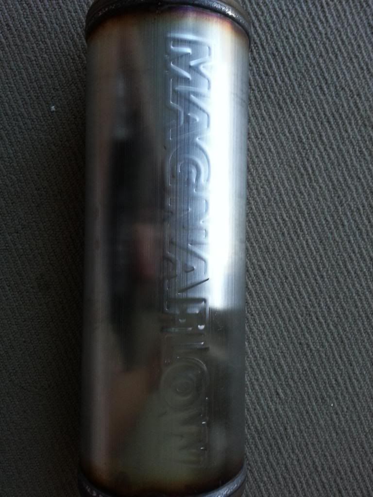

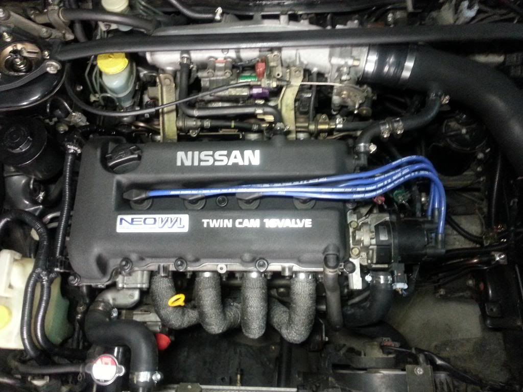

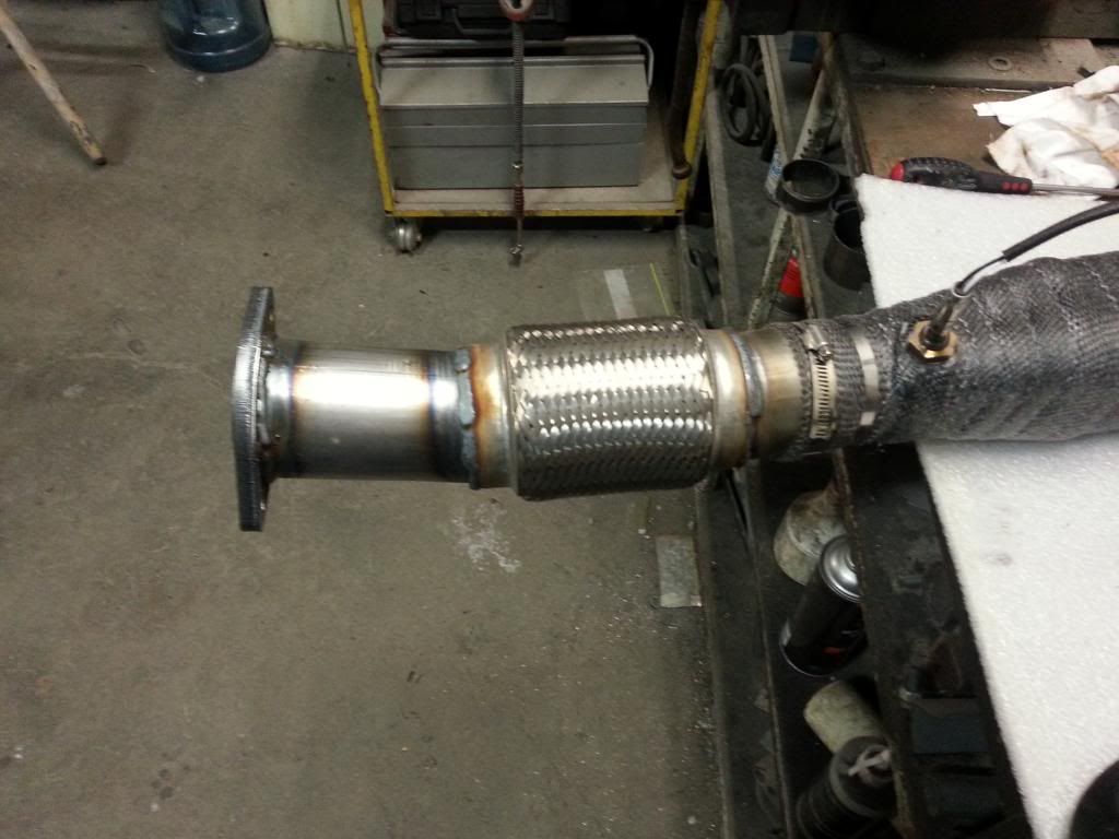

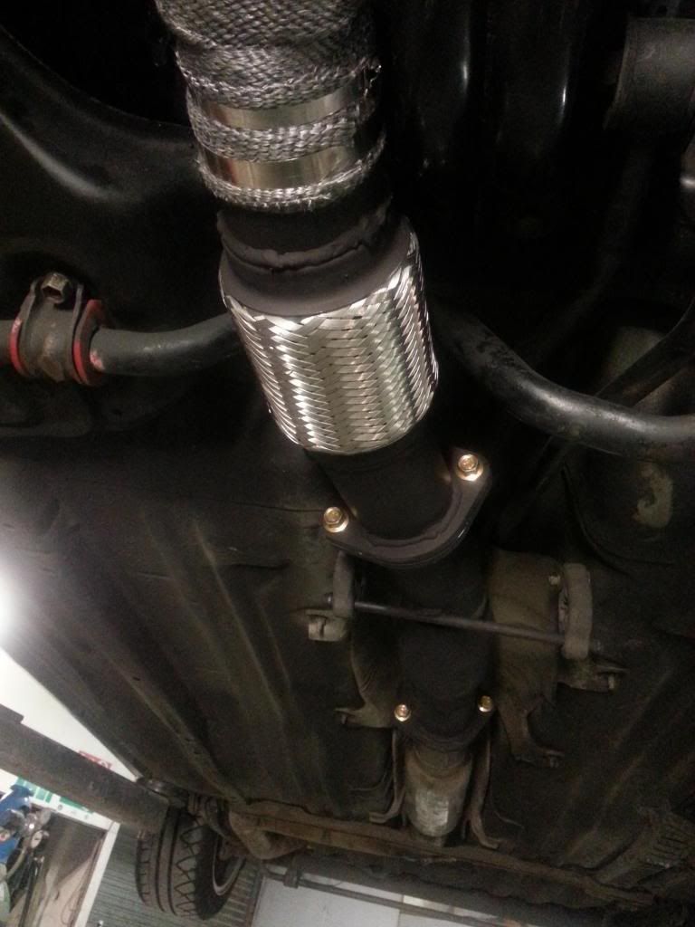

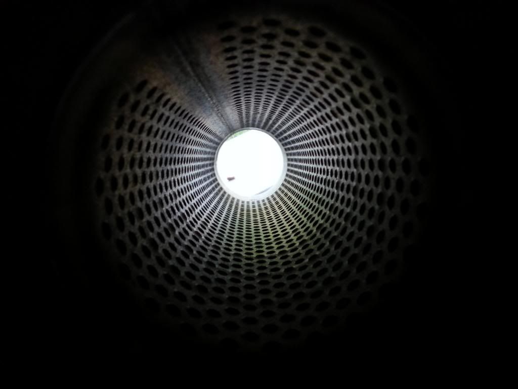

So the exhaust is on, it took quiet a few hours to get sorted as I've never done an exhaust before. A lot of measure twice, cut once. There is still a slight issue with the catback I bought off a forum member hits the rear beam linkage. I suspected it would as my car is quiet a bit lower than his. That's not an issue atm, as the car will have to be raised a bit 10 - 15mm minimum, I want at least 80 - 90mm clearance on the 4-1's, so ride height will suffer a bit.
Function > Form
If this doesn't fix the problem, i'll pull the rear section of the exhaust off and fix it so there is plenty of clearance.

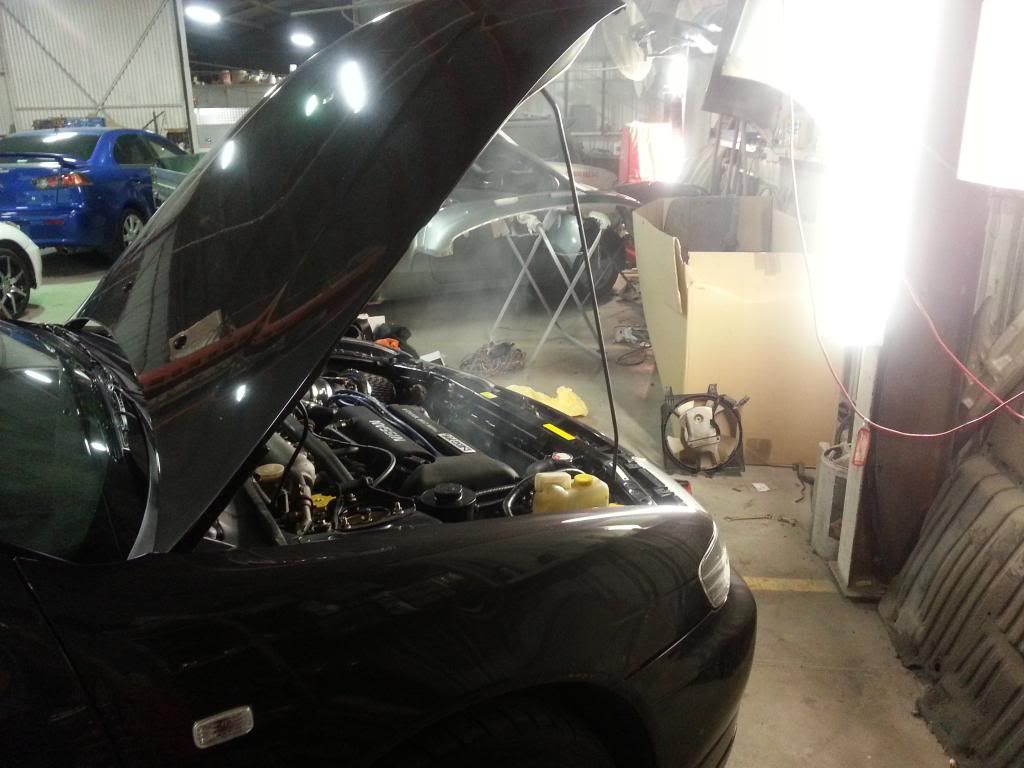

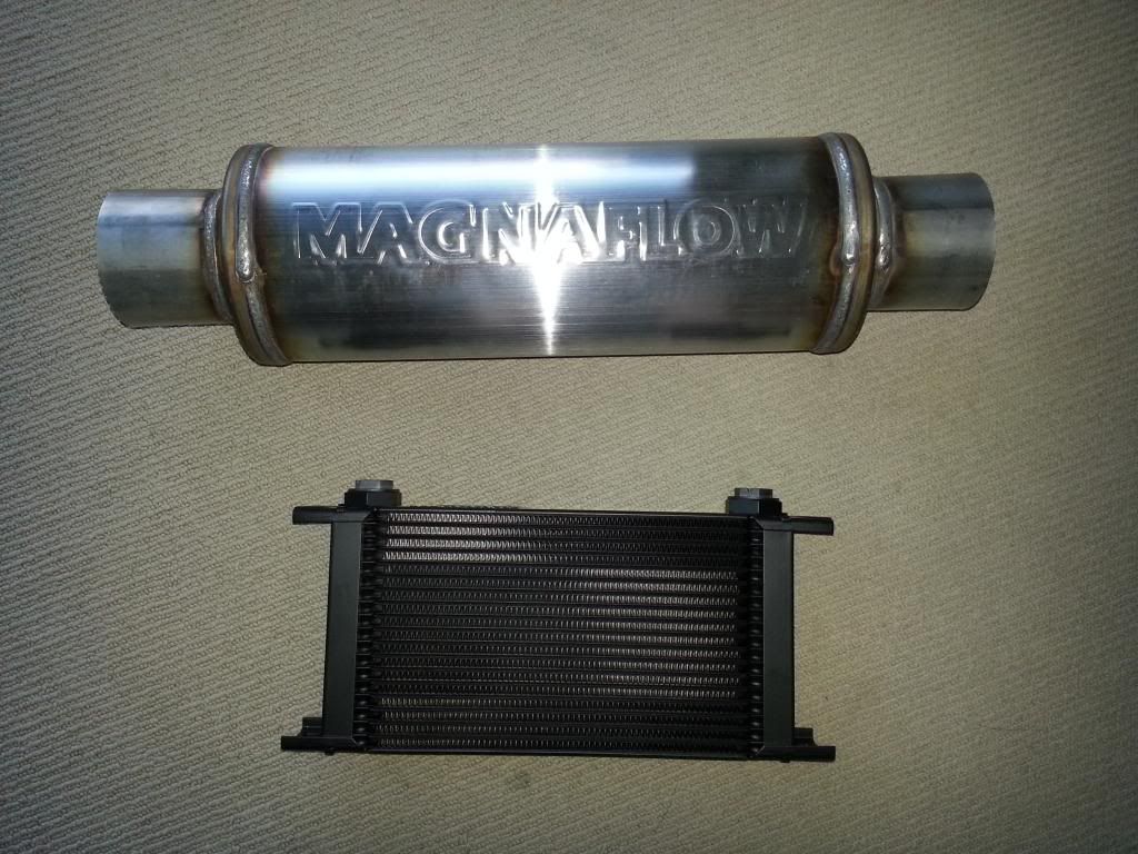

The car is ridiculously noisy, it more or less has an excuse of a resonator and a good size Magnaflow rear muffler (offset to center) I'll be buying a different resonator to put in the system tomorrow.
The top end of this car now is unreal though. Has an extremely strong pull, even more so than before. The exhaust note and rasp was described to me as sounding (exactly like a N/A 13B bridgeported rotary I built years ago) by the guy who helped me out with the exhaust.
So it's loud as f**k and raspy as f**k too haha.
Here's a few photo's anyways, sorry some of the photo's aren't great quality, it was quiet late when I took photo's of everything.

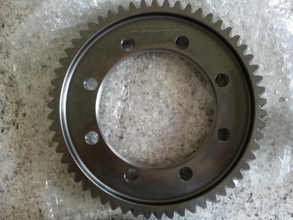

I'm waiting on a solid center clutch before I put my LSD gearbox back in. I'm in the process of getting my Sparco mounted up a bit better on a Bride rail for an N15.
I'm keen to buy a few more handling bits and pieces in the future, so stay tuned.
