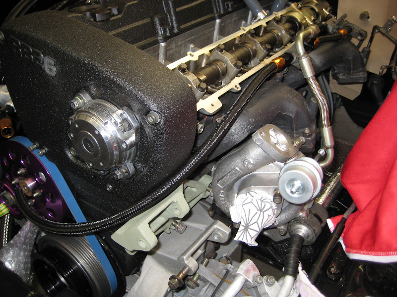

Not much for now mate, just new main & bottom end bearings and crank work

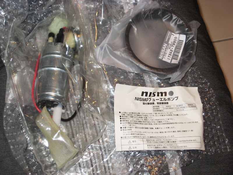

Couple more new bits

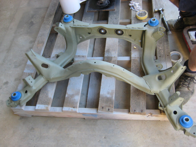

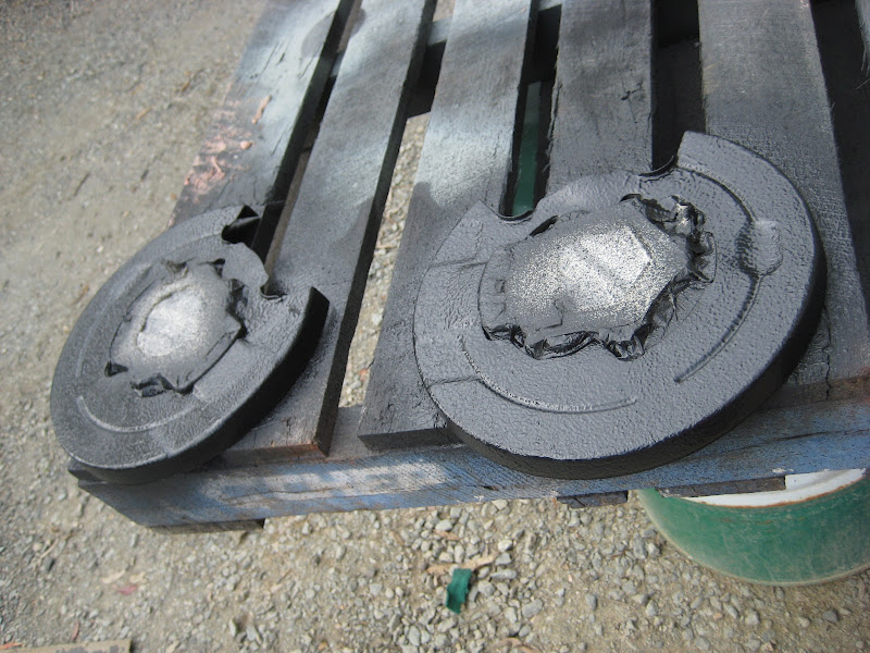

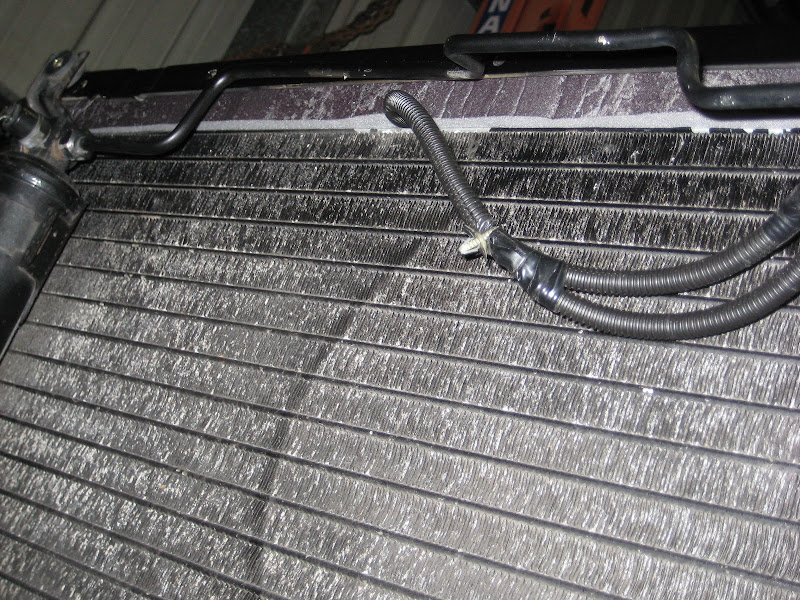

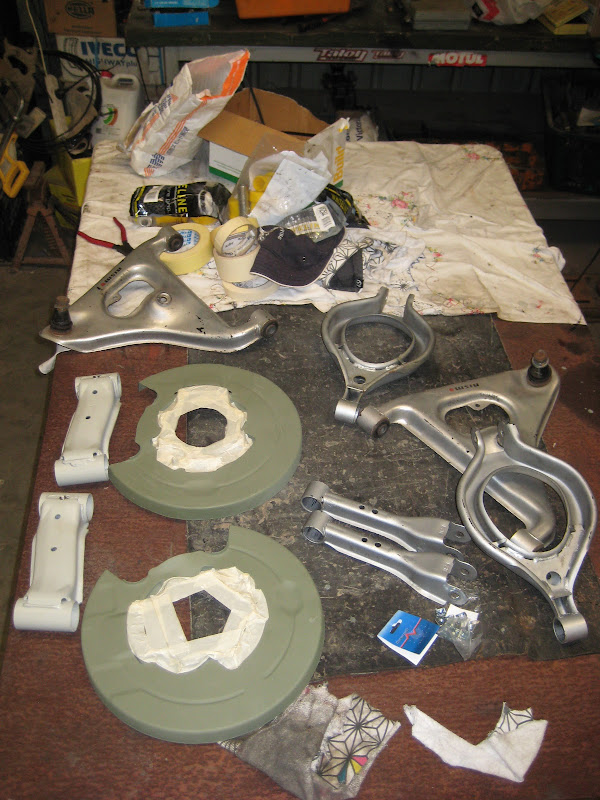

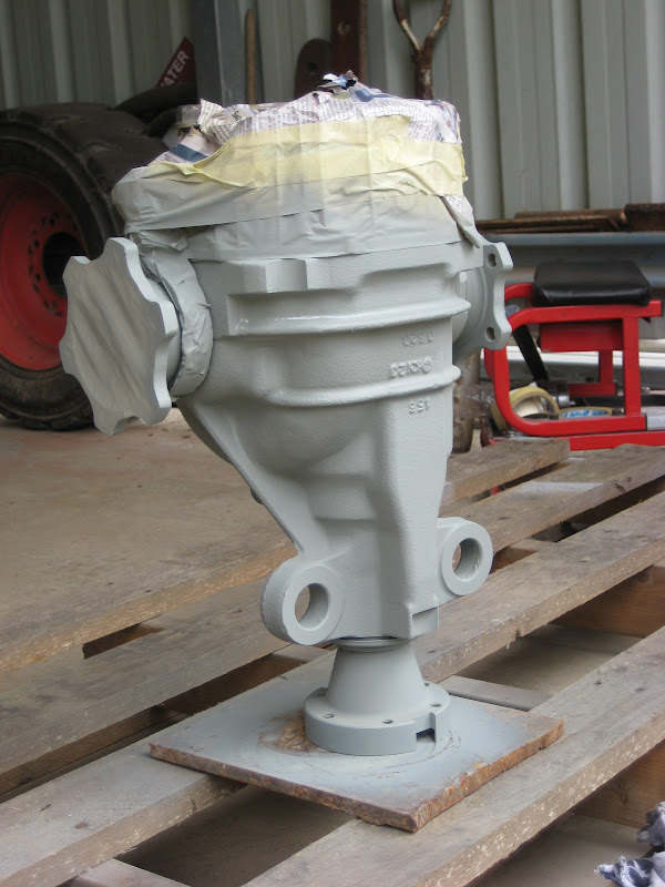

Started getting rear end prep and painted so can get back together asap and get this thing rolling again!

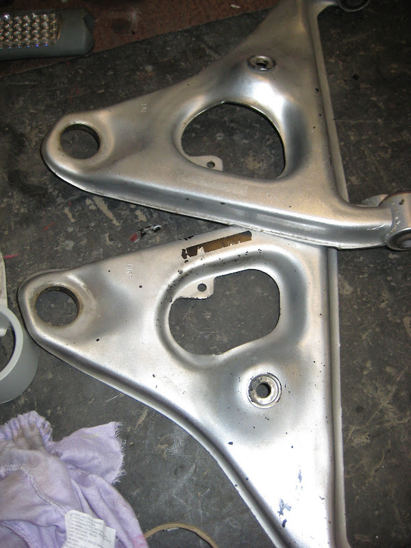

Will doing underside of these in underbody spray and overpainting in silver, as you can see they cop some serious spray!

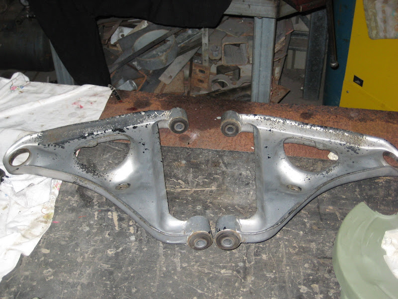

Next lot off to get zinc coated
Real nice mate. One question (may sound silly) what does Zinc coating do and how is it done?
Cheers
It forms a layer on the part that prevents corrosion. It's usually done by dipping the parts in a molten bath of zinc. It's actually a lot like soldering really, the parts are chemically cleaned and then coated in a flux,which helps the zinc bond. The advantage of zinc plating over other anti-corrosion methods like paint etc. is even if the zinc layer gets scratched, the part underneath will still be protected.
Nifty stuff really.
Nifty stuff really.
Cheers mate. Yeah it sounds really good. Im guessing there are places where you go and get that done and it would be limited to metal and cast iron parts, am I right?

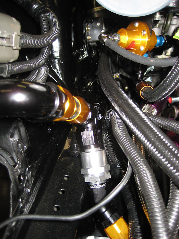

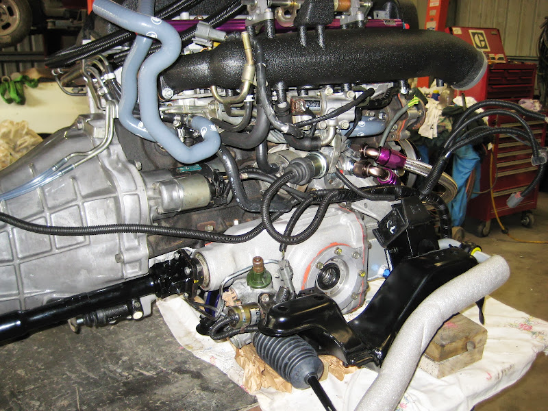

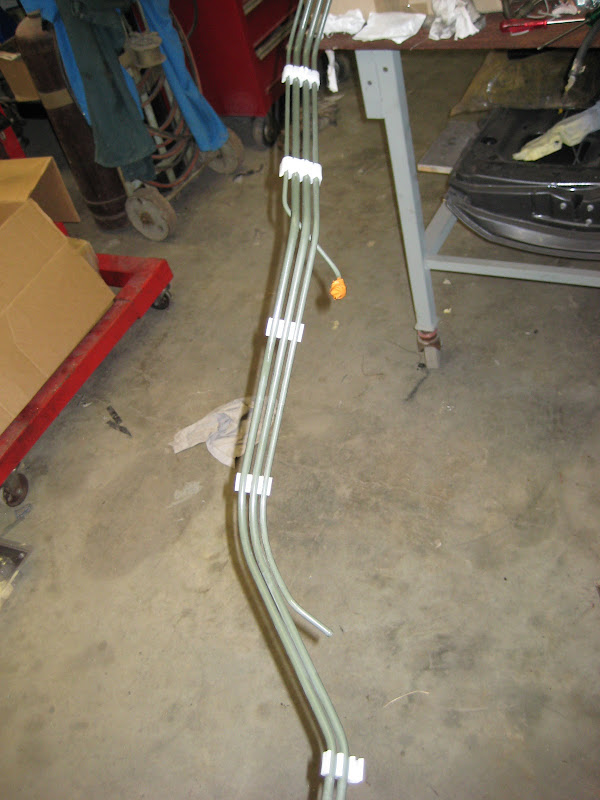

Endless time in getting all these new lines done!

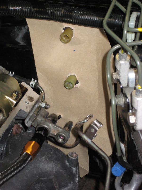

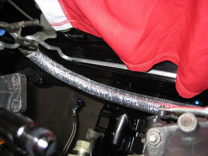

Finally got some heat material sorted and started installing
New foam bits n pieces going in
New fuel line clips and dummying up lines
Couple of underneath so far...
Plenty more to do, never enough time
