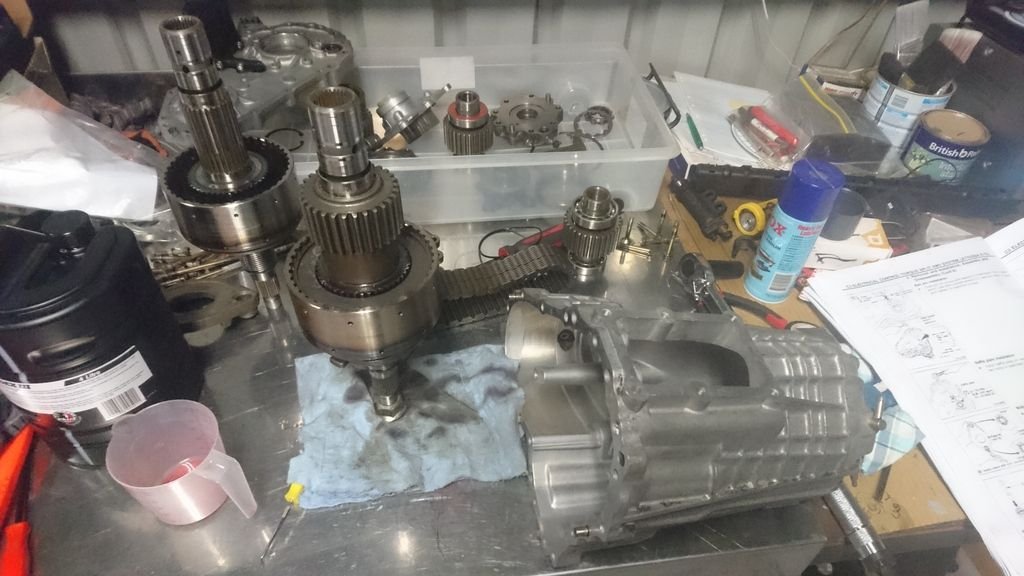

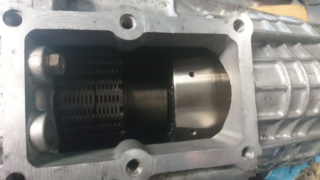

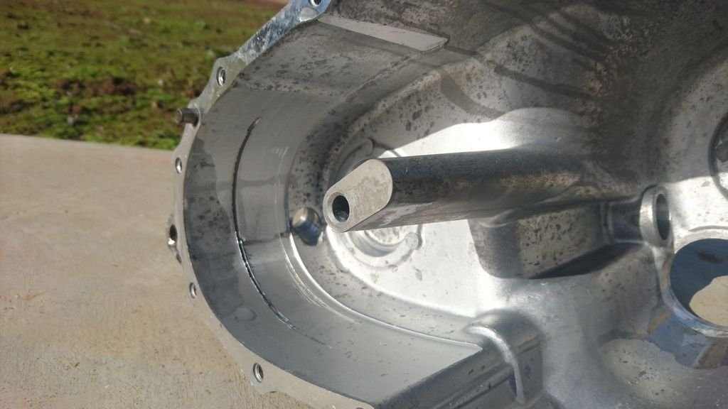

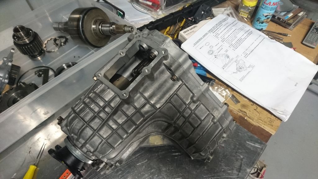

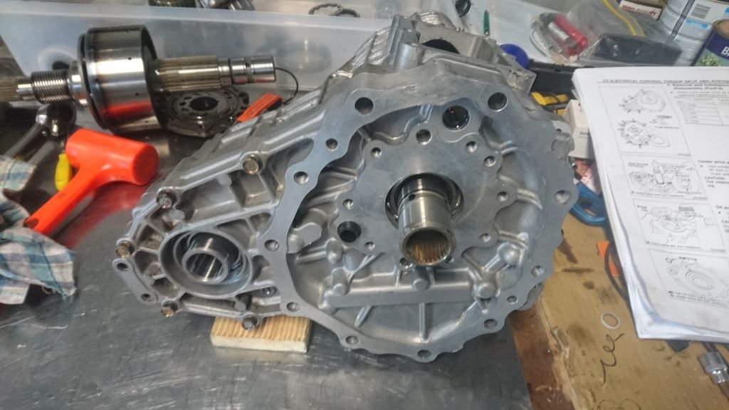

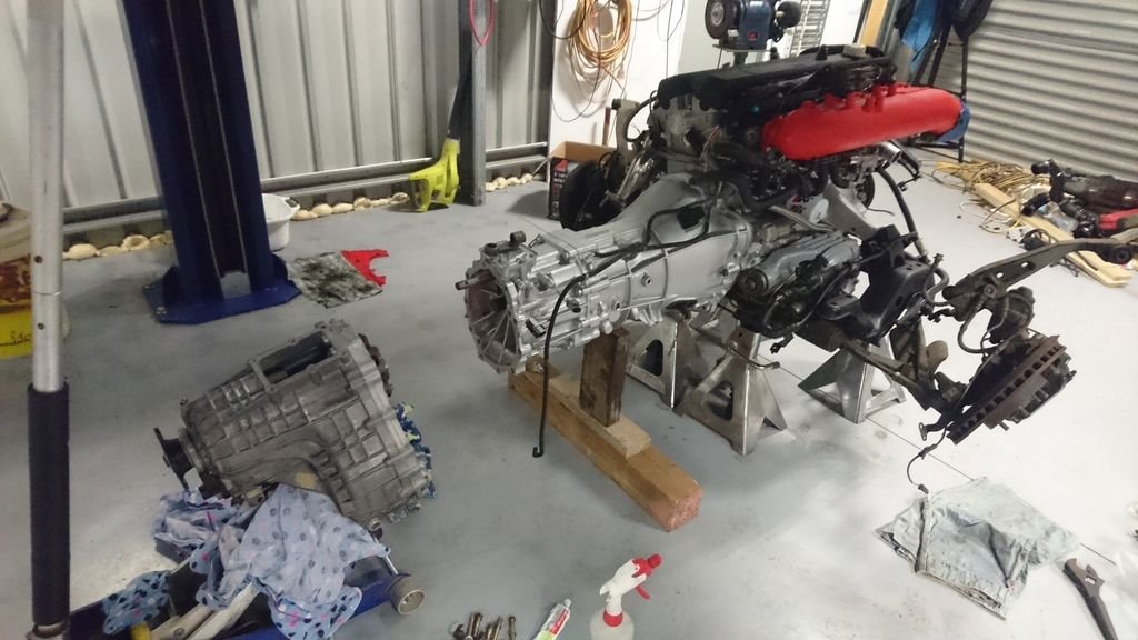

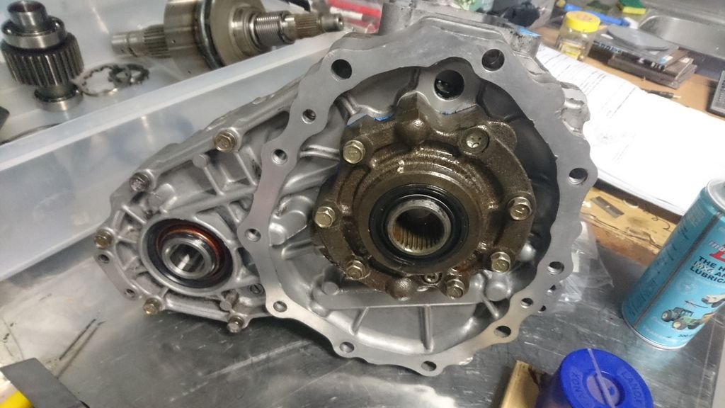

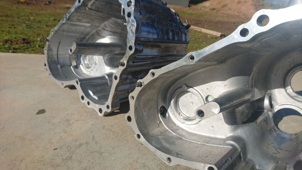

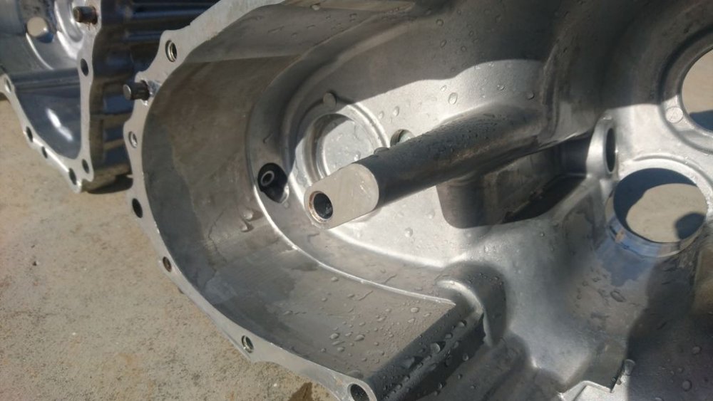

Finished off the transfer case today (finally...). Ended up stripping my spare transfer case to use the housing as the broken chain had almost completely chewed through the housing. It can't be far off going right through.
New housing -
Stuffed housing (you can see the groove  which is 3 or 4 mm deep)-
Comparison -

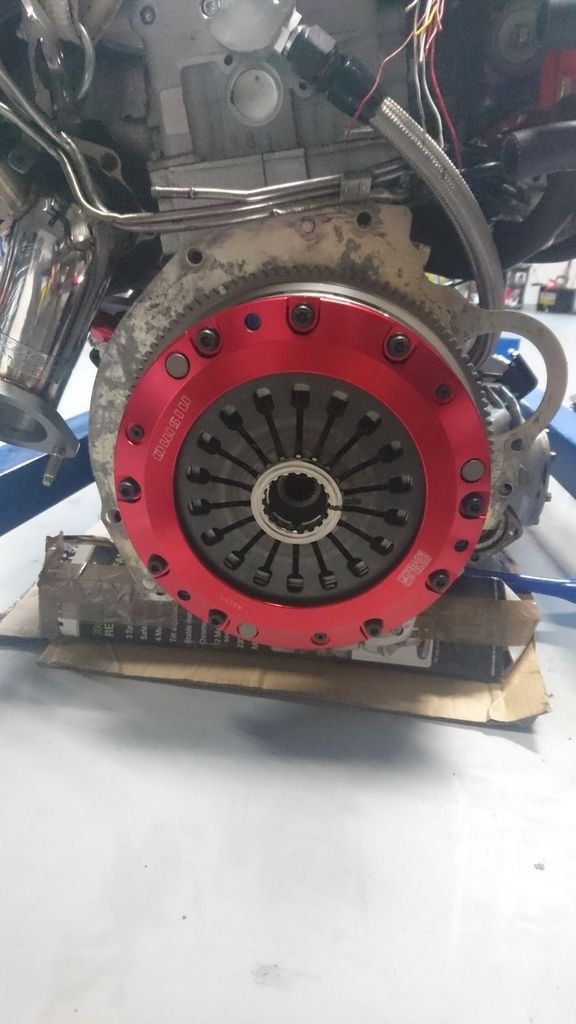

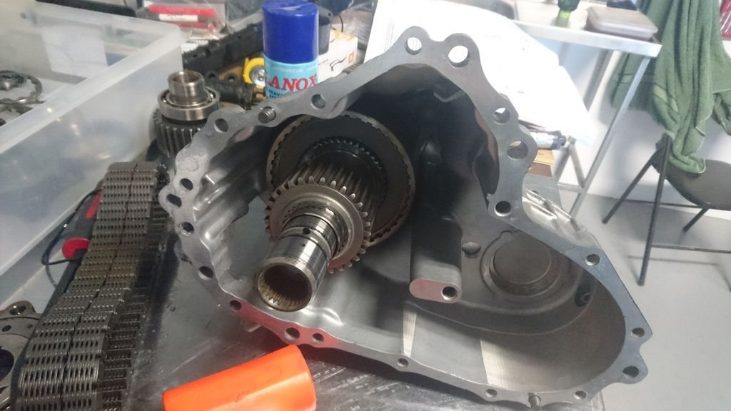

Set-up the discs in the alternating driven/friction pattern. With a bit of trial and error (luckily had 3 sets of clutch packs to choose from) managed to get the right clearance once assembled. Was a bit of a mission but with the right tools and some patience it's a job that someone with slightly above average mechanical skills could have a crack at.
Some progress and final product shots -

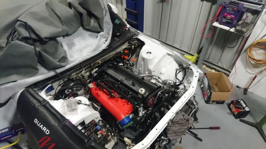

Not a lot of visual progress, it's like the last month of building a new house, it's when a lot of the fiddly stuff gets done but it's hard to see any sign of it!
Still fiddling with wiring and mounting all of the new sensors.

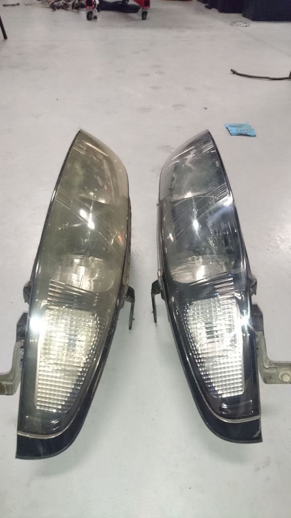

Gave my headlights a run on the buff, need more of a sanding to get rid of ultra fine cracks but the improvement is incredible!

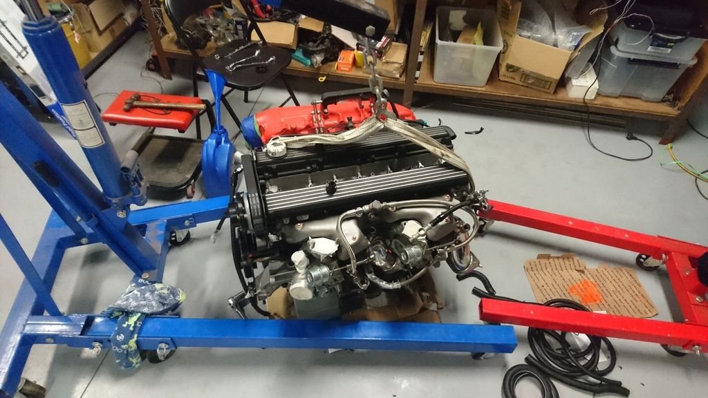

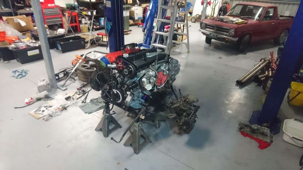

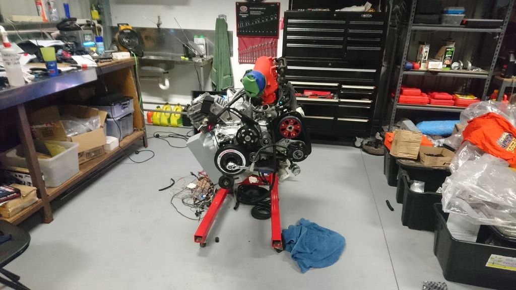

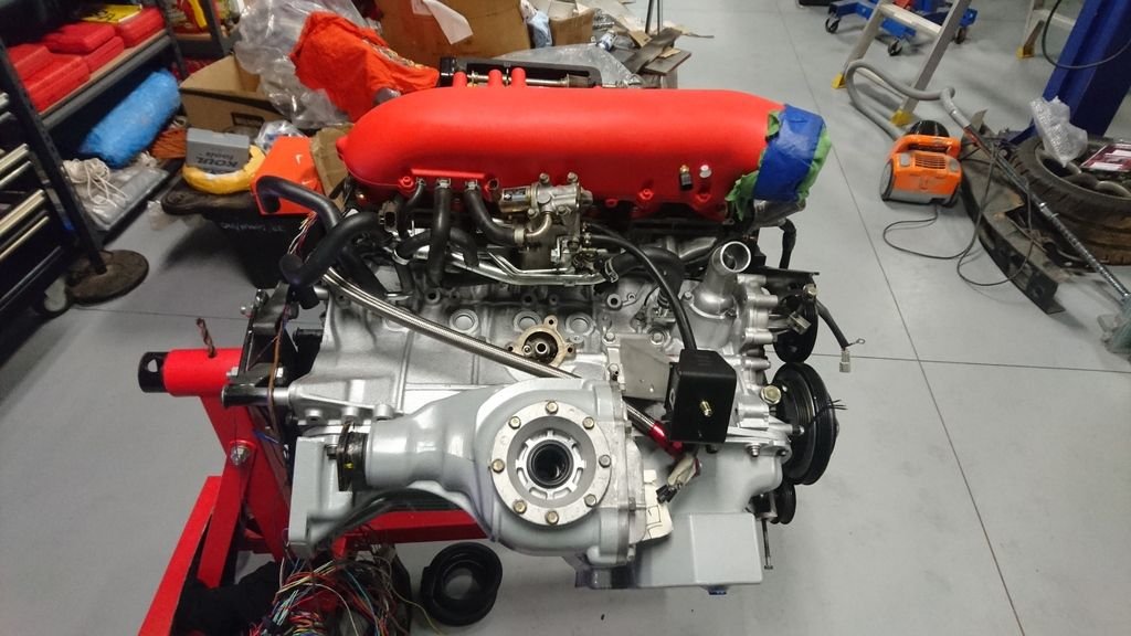

Tipped over the engine and poured as much oil into the oil pump and inner oil galleries as possible to help with initial start-up and priming oil system.
I should have popped the champers at this point as this is the first time in about 3 1/2 years that the engine has been off the engine stand!!! Seemed like a significant moment!

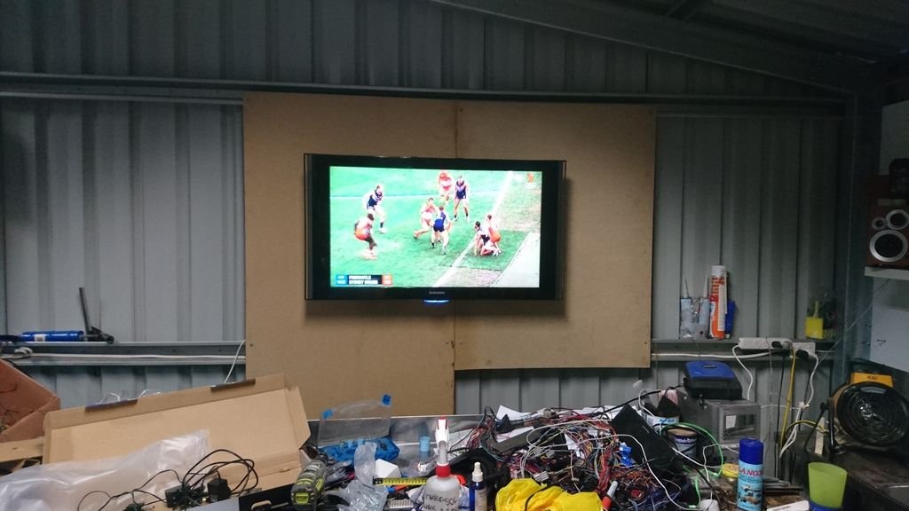

On a side note the shed is getting a little more comfortable every day, now have the footy and Netflix,  I think my wife is getting nervous I could be moving out here soon...
Shit the bench is a brothel.

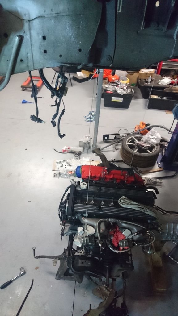

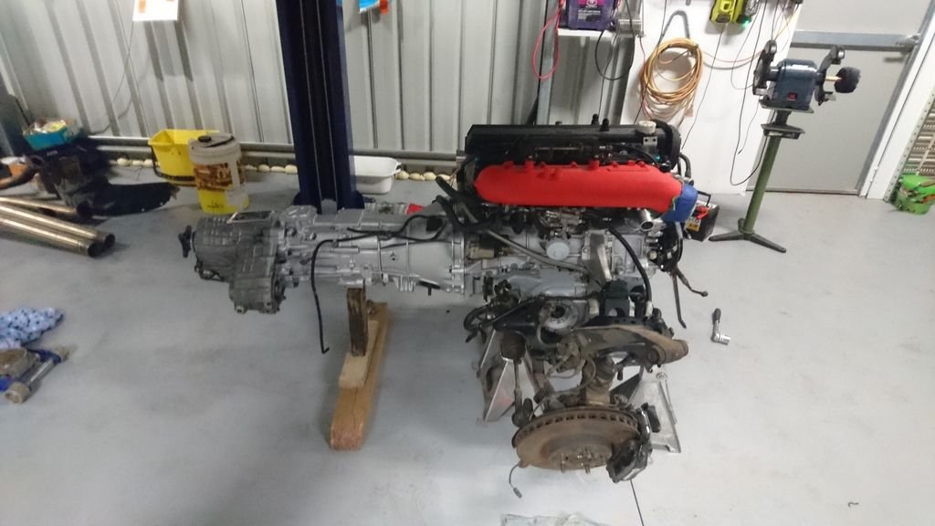

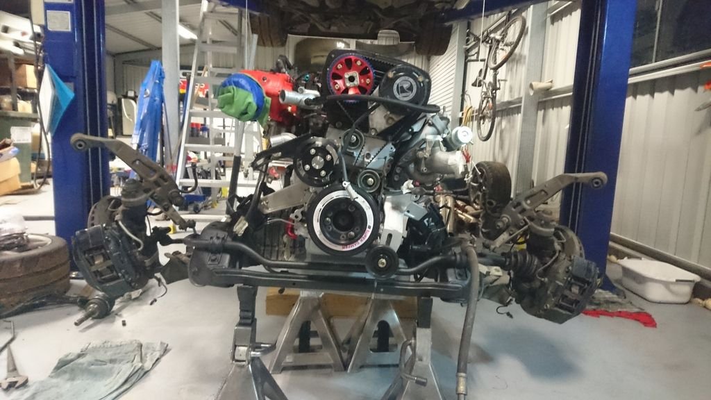

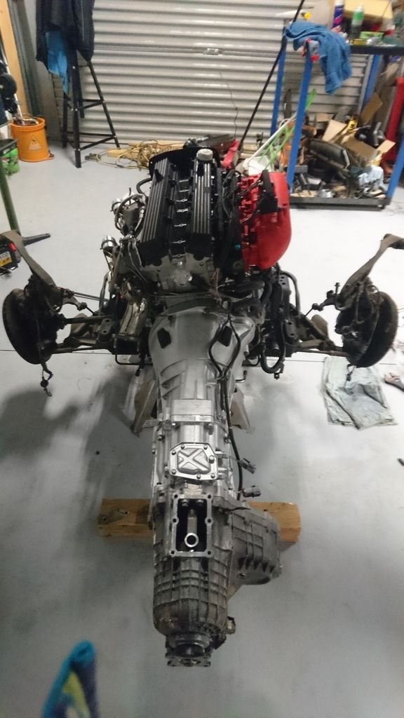

Engine and transmission now mounted to the k-frame, the string hanging from above is to align the k-frame to the car so hopefully the car drops directly in line with the engine-
Transfer going on-

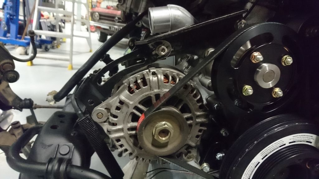

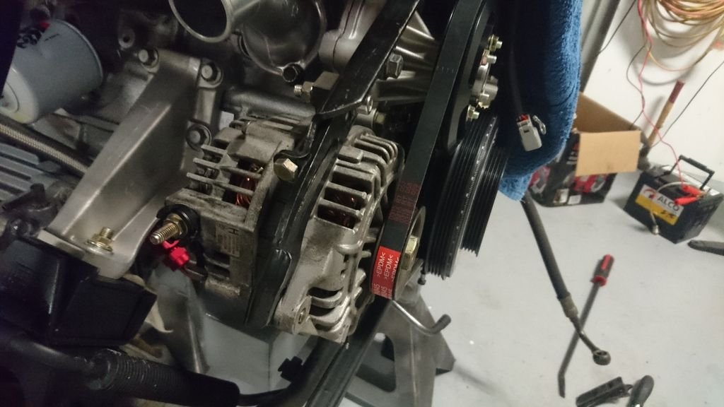

Sorted out the alternator today.  It's just a 120 amp Maxima alternator.  $95 delivered off Ebay so a cheap option!  As a tensioner I used a spare (RB26) power steering tensioner and just chopped it up a bit and drilled an extra hole.  It's not show car worthy but quick and easy.  Once I paint it up it will look a bit nicer-

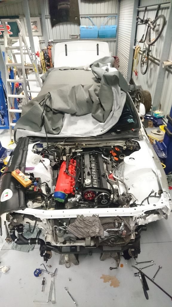

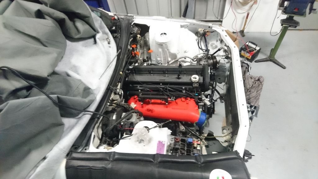

And after an amazingly long time, she's home!  Albeit temporarily while I finish off the wiring.  It will need to go in an out a few more times to get everything right.

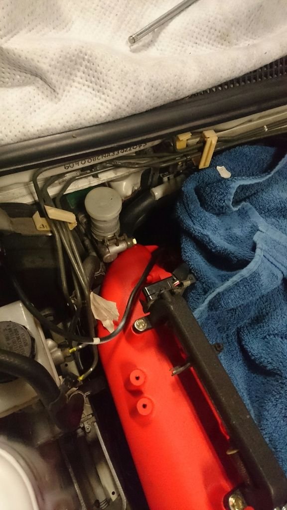

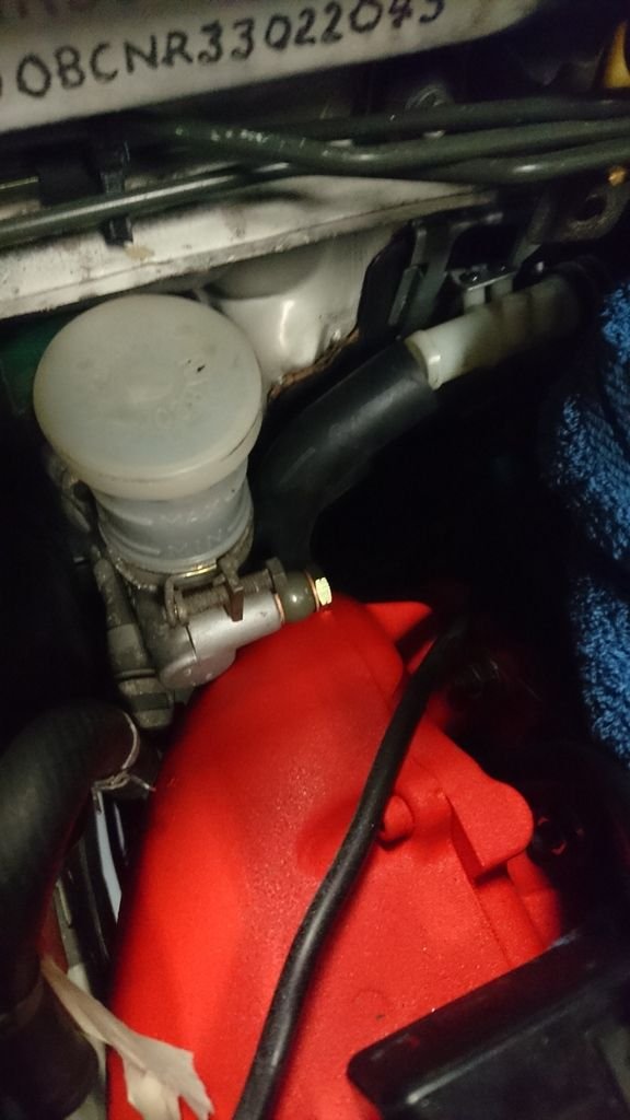

One word - Faaaaaark!!!
It hits very solidly so it's in the way by a fair whack. The engine still needs to come up a bit which will make the problem worse!
It looks like I have 2 options,  try to find a shorter master cylinder or delete the booster. Preference is for option 1 but firstly finding one that is small enough to fit and secondly one that will seal the booster (to hold in the vacuum) is going to be a challenge. I've ordered what appears to be a smaller master but we'll see what happens when it rocks up. The lugs are in different places to the standard master so it's not a straight forward solution at all!  Its looking like strong clutch leg is forthcoming!

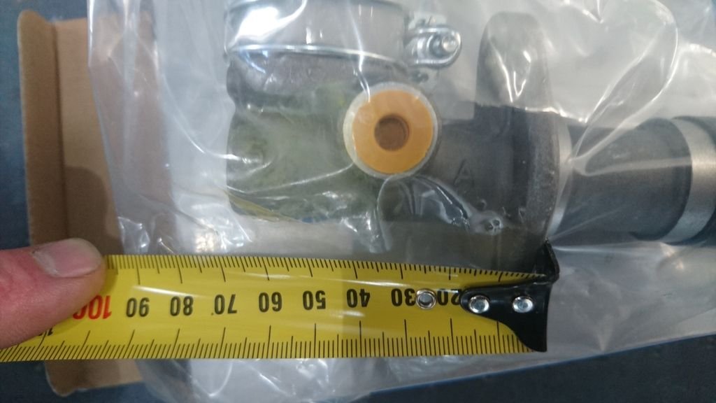

Thanks Luke.  Maybe if you could measure the length of the master cylinder itself.  The GTS-T booster will be a bit better as it exits underneath not to the side.  I think it would have to be shorter than the GT-R master as well (which I don't think it is) as the outlet location.  I'm pretty sure mine is about 80mm long for reference.

i just had a measure up, the master cylinder is about 80mm in length.
Its 5/8 in diameter and the hose exits straight under the cylinder.

Hopefully this tiny little sucker will do the trick.  It's under 70mm long so heaps shorter than the standard master plus the location of the outlet being further forward hopefully should be a winner.  Only dramas will be the outside bore size (to fit inside the booster), sealing it to hold vacuum and lastly the fact that the mounting tabs are in different locations.  Apart form that perfect!!
