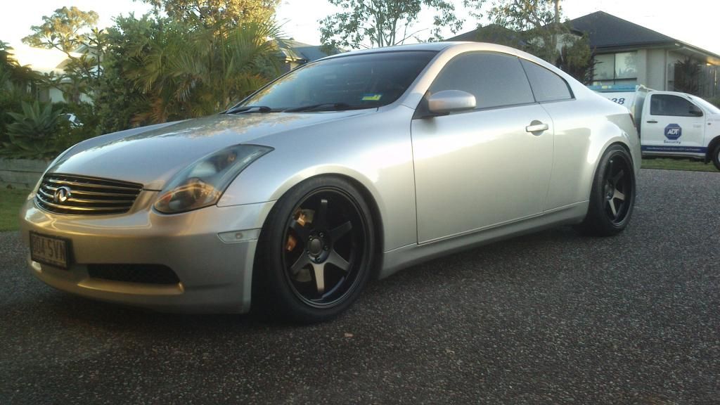

They look like front 19 9.5 +12 and rear 19 10.5 +12 ????
I was gonna but the exact same setup ... Need to sell my oem rays first
Yes, that is the spec
Is your car lowered on springs or coilovers?
Cheap coilovers, but they do the job. Rears are maxxed, fronts could go much lower.

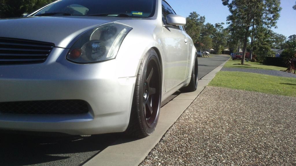

is it just me or is it half up on the gutter so looks lower :lol:

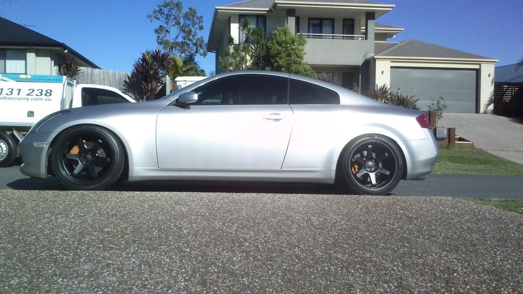

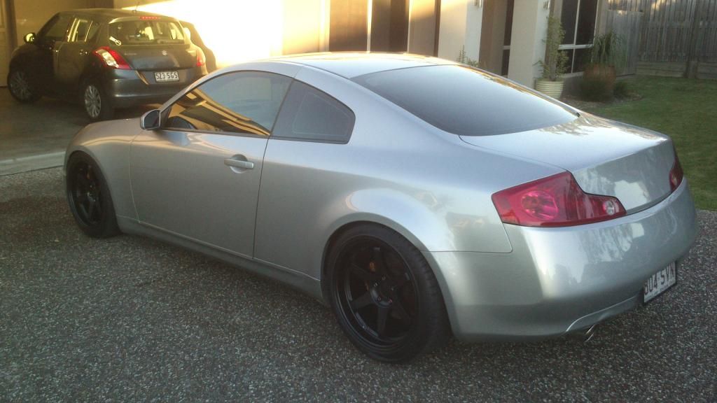

It is 1/2 on the gutter, but height is still the same. Some more crap phone photo's.
Original height was too low so raised by about 10mm, this was how it sat before I raised it:

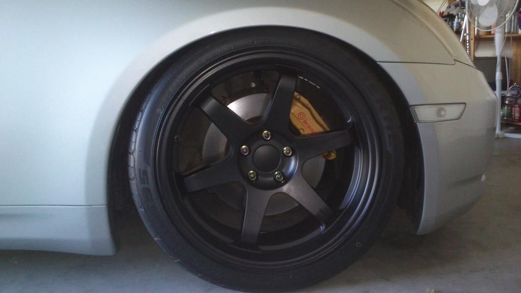

Shredding paint!
It is relatively easy to drop the rear, 275 35 19's only scrub on heavy bumps with someone in the back seat. The front is lower by default due to the stock staggered fitment. I cheated by running a square setup with 245 40 19's on the front. Same rolling diam as rear so give you more clearance and close the tyre/arch gap. I've had stretched tyres before and do like the look, you have to go real low to pull it off. 235's on the front would be an easier fit. Oh and fat is the new stretch, haven't you heard :woot:
Edited by Superpoo
275 35 rear, 245 40 front

Stock runs staggered. The profile is the same, widths differ, so overall diameter is different front to rear (rear is bigger). The danger of running square (what I have now) is tripping the stability control, the computer thinks the rear is spinning faster than the front and kicks in. Hasn't happened yet and the opinion on the internet is mixed so I will see how I go.
The only benefit is you gain some ride height and loose some guard clearance.
